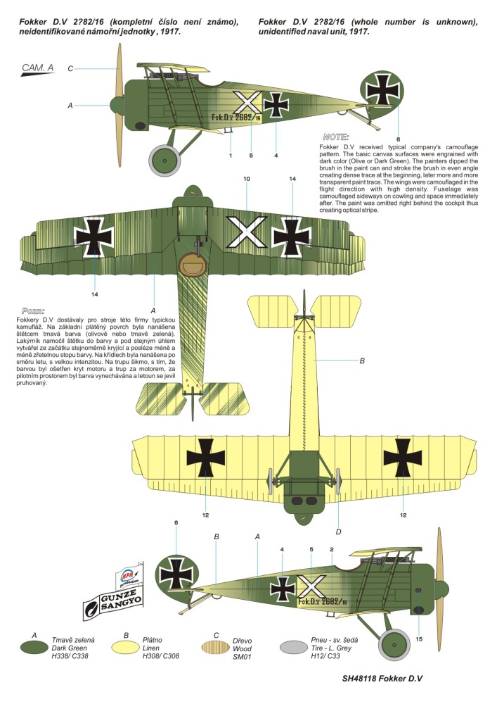

The manual can be downloaded at cmkkits.com, with color pages for the markings. Nice service!
Here for example camo A - the one I want to build.

There is a colored drawing on the backside of my Fokker, and it shows a heavy streaking on the wings. Especially where later the crosses are, with only a white border. I think the white field was over painted. So I tried to keep more there, and the are other areas where the paint is nearly completely removed. The right aileron looks like replaced on crash picture and drawing, because is has nearly no streaks.
The biggest difficulty is to show the difference between full color and almost completely dry brush but getting still streaks. The brush was in real 8cm wide (see the width of the stripes on fuselage sides on Mikaels Fokker above) which is 1.7mm in 1/48. I found a small flat brush.
