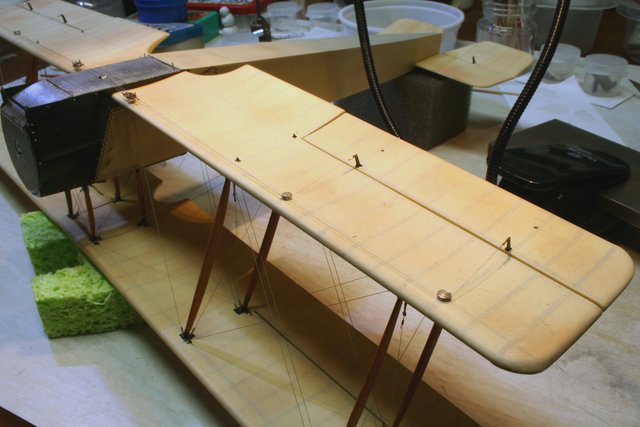

Things have started moving along faster now. I'm working on the aileron controls on the bottom of the wing. Then the landing gear to get it on its feet.

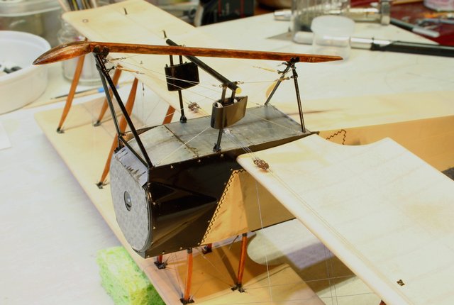

Looks good flip on her back !
Nice to see the top wing in place all set for the rigging

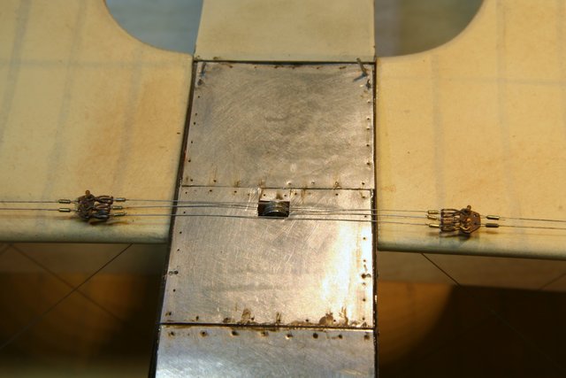

Got the wing rigging and lower wing aileron controls wired.

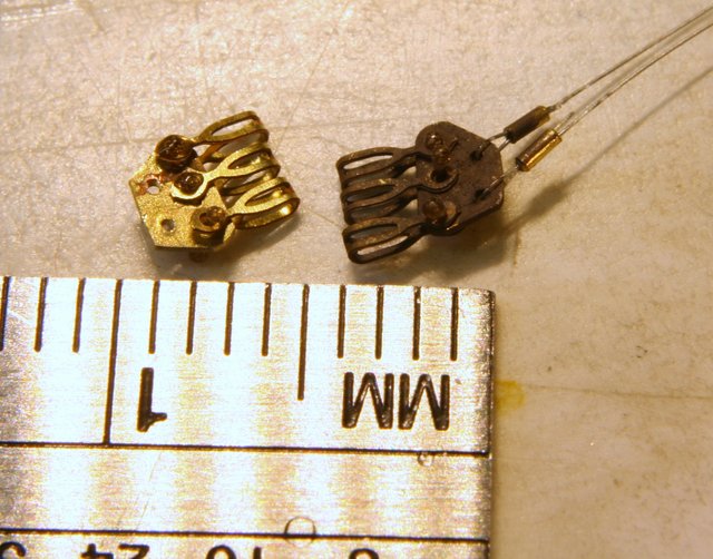

The 504 has a quite a bit of rigging. Here's an aileron control system component that I blackened chemically.
Installed in place on the lower wing.

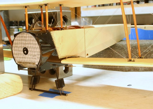

I've got the landing gear on and braced up - it's looking good.
Now for the wheels...

Thanks for stopping by, Stephen. Some of these details are visually impressive, but are quite simple. The aileron rigging component is a flat plate with holes drilled in it and PE turnbuckles folded over and attached with monofilament 'bolts'.
Here's a somewhat poor picture of the landing gear and toothpick installed.

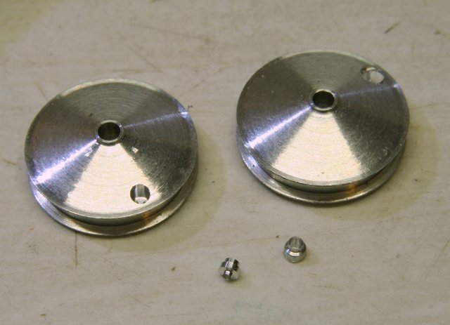

I've machined out some wheels with the center axle detail.

PS: I forgot to mention those machined wheels....brilliant!
