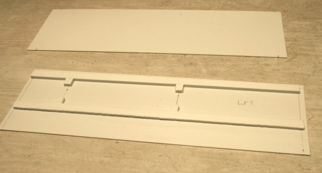

Also new this time around, I wanted to make the wings differently from the past to reduce the amount of plastic sheet needed and reduce the amount of sanding needed to get the airfoil shape.  In the past I have laminated sheets of 0.020" styrene to make a solid wing and sanded the airfoil shape.
This time I am experimenting with a simpler built-up wing.  I found I could get a good airfoil shape by gluing a leading edge spar and a mid-wing spar to the bottom sheet, and gluing the top sheet to the bottom sheet at the trailing edge.  When cured, glue the top sheet to the top of the spar and leading edge while pressed over another piece at mid-wing to make the camber.  I can locate the mid-wing spar in line with the ailerons and wing to fuse attachment points.  This lets me cut out the ailerons after building the wing.  At least that's the plan.

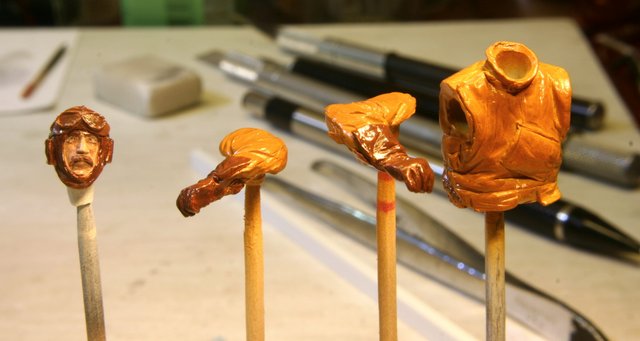

Also, I'm putting a pilot in the seat.  A RFC pilot in a leather jacket from CSM (#F32-039).  I think his name is Reginald (he looks like a Reginald) and he's borrowing Wilson's plane for a joy ride.

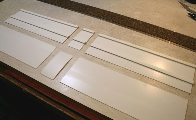

Here I have glued the spars on the bottom sheet.
Next, I glued the trailing edges of the top and bottom sheets together and let that cure overnight.

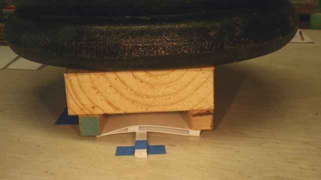

Here, the top sheet is being glued to the bottom.  Glue is applied to the top of the leading edge and mid-wing spar.  The wood blocks catch the leading and trailing edges with a weight on top to bend the wing around a piece under the wing near the mid-wing spar to give the wing some camber.
It will take a couple of days to get through the wings.  Then I need to fabricate the wing tips and drill holes in the ends of the spars for attaching pins.
Reginald is working on getting himself together for the first flight.  He's a work in progress at the moment.

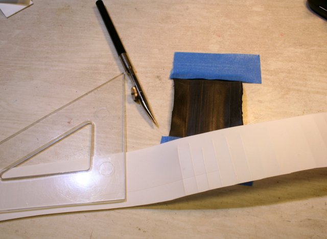

These are tools I use to emboss the rib detail on the wing skins.  I had forgotten how I did this on the last model, and had to re-invent the process.  The 0.010" styrene sheet to be embossed needs to be on a surface with some give to it in order for the embossing to occur.  I tried many things, but what worked the best was a piece of bicycle tire inner tube cut open to form a sheet.  I embossed it using a drafting ink pen without any ink in it of course.
Here is one of the bottom wings in process.  One can see the small blocks that the struts will mount into, along with the leading edge spar and mid-wing spar.

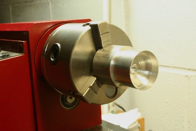

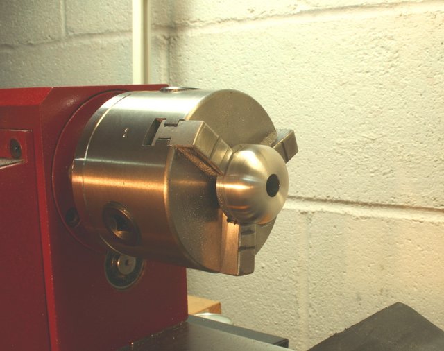

Once again, a metal cowl is needed.  The Taurus engine is larger than the scaled drawings I am using, so some modification will be necessary.  Hopefully it won't be noticable.
The first lathe setup where the inside is cut out.
The second setup where the outside shape is filed by hand.  Took about 2 hours.
