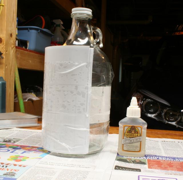

The reason for laminating the wing is to get the cambered shape with less sanding.  One could use a single thick sheet of styrene and sand in the wing profile, but I choose to do less sanding and get the camber by laminating thin sheets (five 0.020") together, taping it over a round object.  I have a glass jug that I use.  The picture below shows the plastic sheets taped to the glass jug while curing.  Try to avoid air bubbles between the layers.
I tried the Gorilla glue (polyurethane based) in the picture, but it didn't work.  I use liquid styrene glue to laminate.  Apply thin layers with a brush - too much will make the styrene too soft and it won't be sandable (learned from experience).
After curing a couple of days, untape the sheets and trace the wing profile onto it to cut it out.

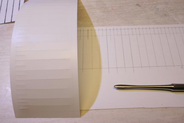

For the wing rib detail, I emboss the ribs on 0.010" styrene sheet and glue on the top surface, like laminating the other sheets.  Here's a pic of the skins.
