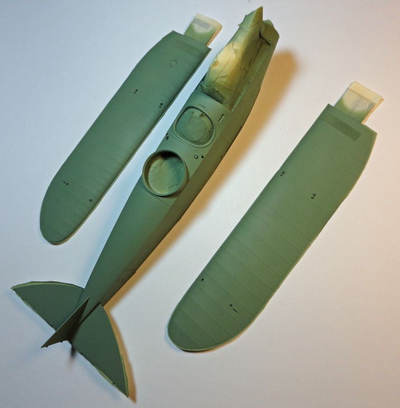

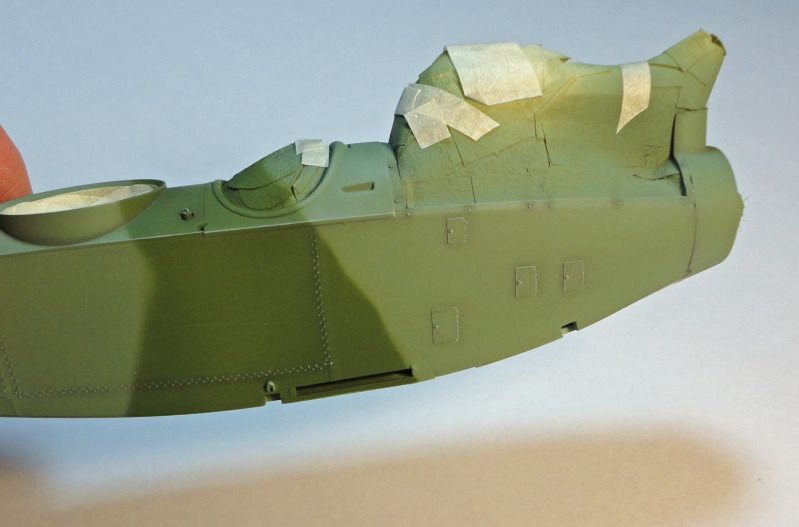

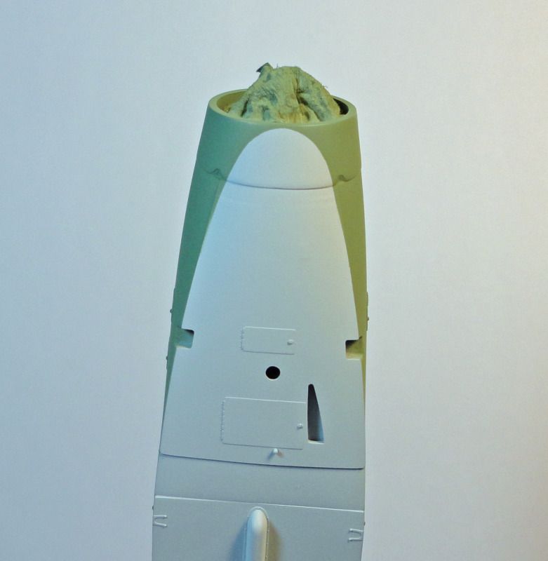

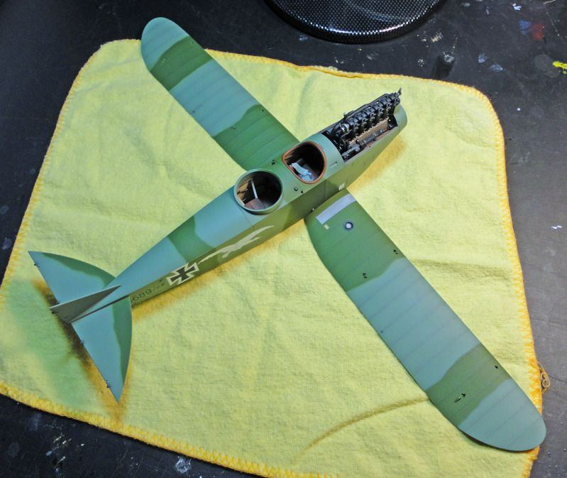

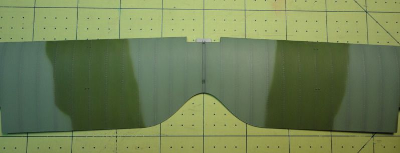

Fellow Modelers,
Work has moved to painting the exterior.  I have not gotten as far as I wanted, but decided to go ahead and post what I have done.

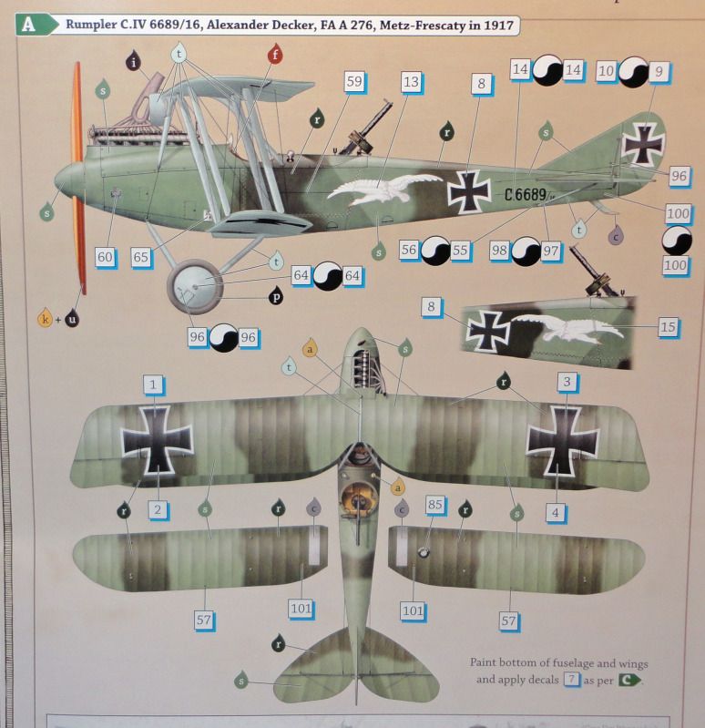

1st Image: This is from the kit instruction book and shows the scheme and markings of the plane I am building.

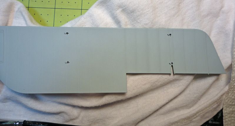

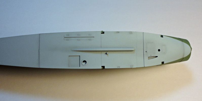

2nd Image: Most of the underside light blue parts are shown after painting.  To create this color I mixed ten (10) parts Testors White to one (1) part Model Master Intermediate Blue.

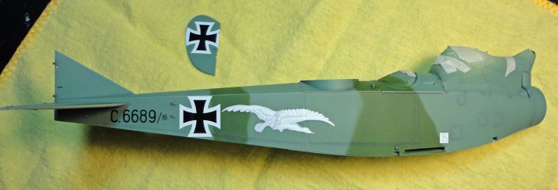

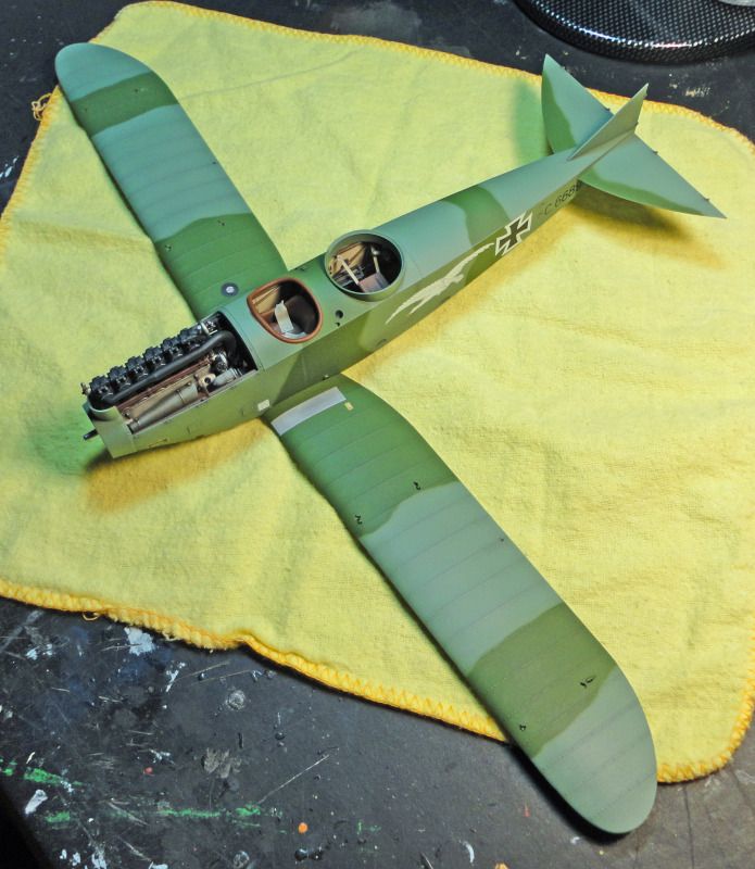

3rd Image: This image shows the fuselage and lower wings after the light green has been applied.  In researching German light and dark green colors I found a lot of inconsistencies and variations.  Even Wingnut Wing’s instructions state that specific German WW1 aircraft exterior colors are a hotly debated topic, so I guess there is some “give and take” here.  For the light green I used Model Master RAF Interior Green.  For the dark green I used Model Master Field Green.  I do not know how accurate they are, but I am happy with them.

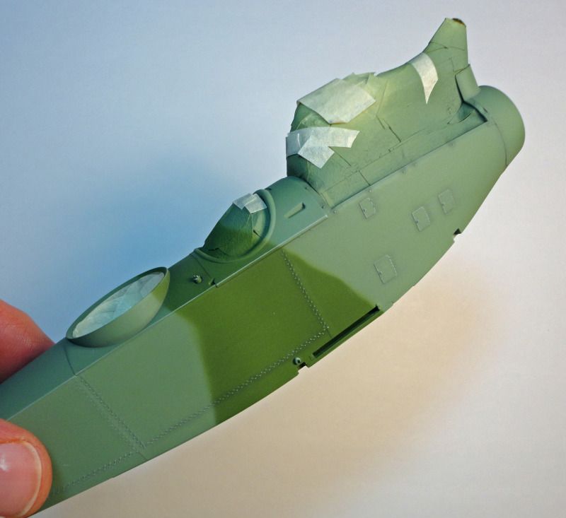

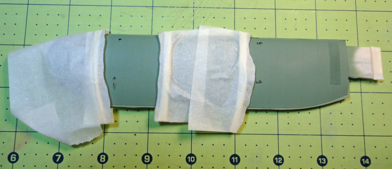

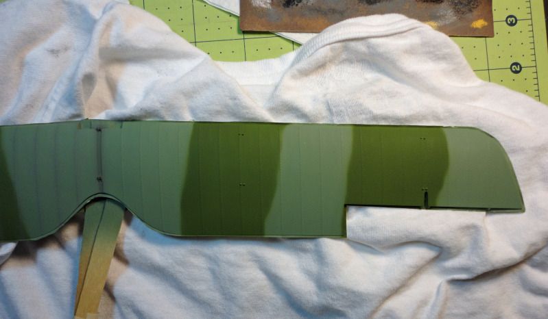

4th Image: The demarcation line between the two greens is very loose with no specific pattern.  To achieve this effect I first cut the masking tape shapes based on the instruction’s profile drawings.  Next, I made sure the edges of the tape stayed at least 1/8” off of the model so a very loose, blurred line could be produced.  Some modelers who are very skilled with their airbrush can do this by hand, but I have to use masking tape.  This image shows the masking tape in place and the dark green paint ready to be added.

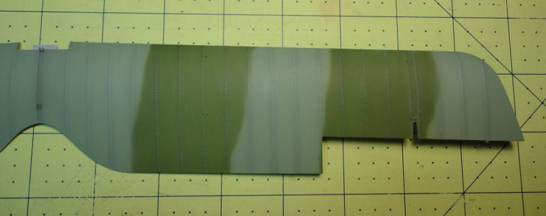

5th Image: The lower left wing is shown after the dark green paint is applied.
6th Image: The demarcation line between the lower and upper fuselage colors is very sharp.  The only challenge was the tight curve at the nose.  This image shows this area after the masking tape was removed.

Phillip, your color demarcations on the wings and fuselage look great, very much to scale.  It looks from the one photo that you used a paper mask raised slightly from the surface by rolled "worms" of sticky-tack or something simlar.  How did you do it?  You got the desired effect spot on!  Thanks.

rhallinger-Your description is exactly correct.  To get the loose demarcation I used a paper mask raised slightly from the surface by rolled "worms" of sticky-tack.  I use this trick often when airbrushing.

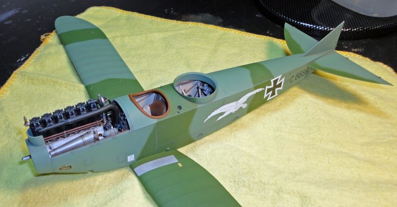

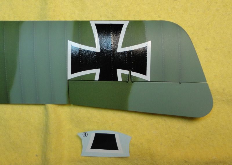

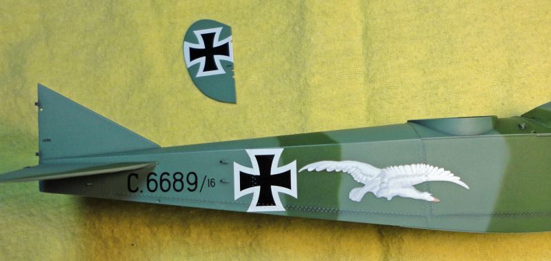

1st Image: Work moves to adding the decals.  One of the upper wing crosses has been applied, and the aileron is temporarily put in place so the lower piece can be properly located.  The decals are excellent and I was able to get them to completely conform using only Micro-Sol and Micro-Set setting solution.

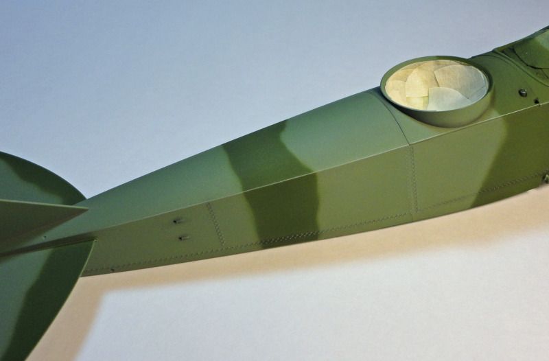

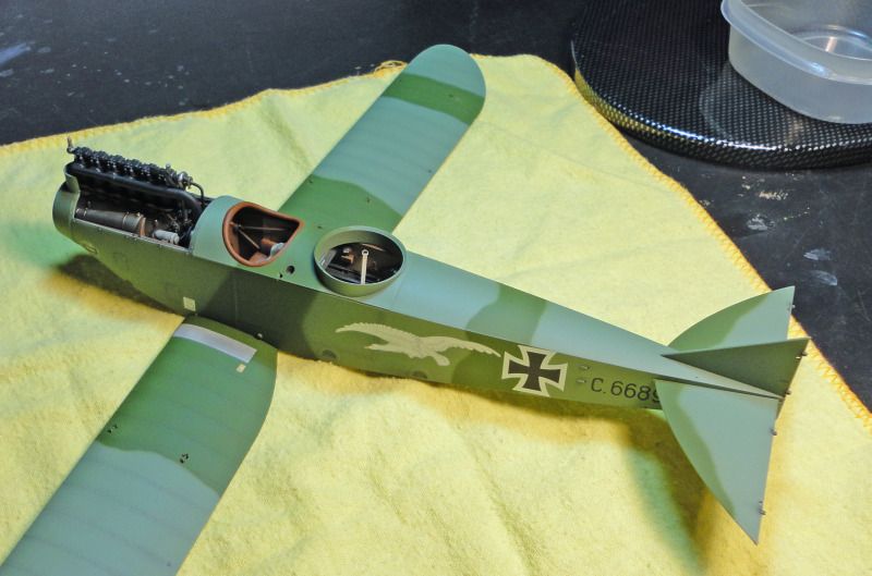

2nd and 3rd Image: The fuselage decals are shown.  The decals dried with a high gloss on them.  To get a finish that matched the paint job, I alternated between airbrushing thin coats of Future and Dullcote (mixed with 50% thinner) and buffing with a very soft cloth between coats.  The final finish is flat with a slight sheen to it, if that makes sense.

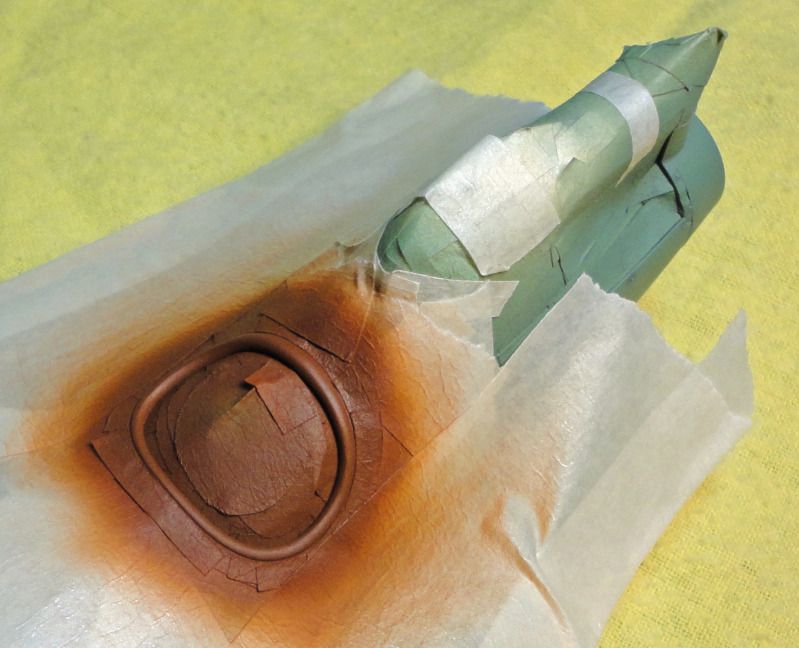

4th Image: The coaming around the cockpit is masked and painted Model Master Leather.

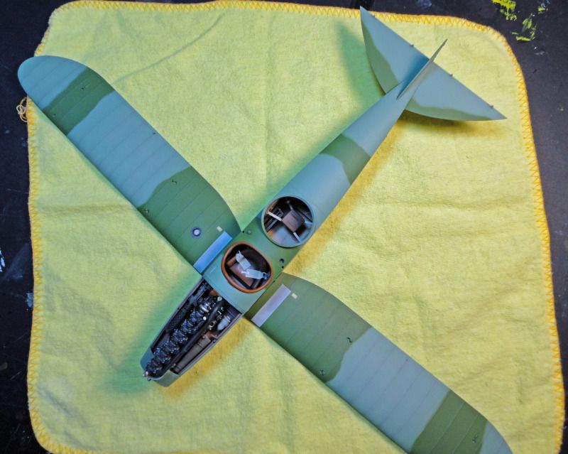

5th through 10th Image: The cockpit and engine protective masking tape has been removed and the lower wings have been glued in to place.
