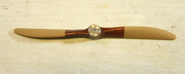

Prop is almost ready to go.

« Reply #172 on: May 11, 2020, 06:05:58 AM »
Very good work on this Ken. The propellor is super indeed.

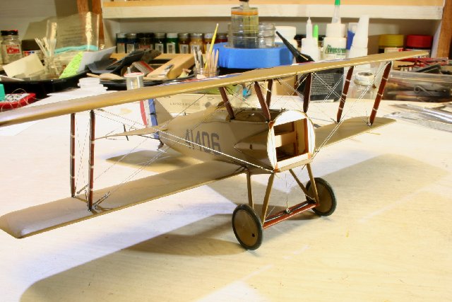

I forgot to take a picture of the PE turnbuckles to show how they look.  Without magnification, its very difficult to tell they are PE.  I used them around the cabanes.
Got the wing rigging done.  I guess you finished before me, Frank.  In my defense, both the flying wires and landing wires are doubles!
Numerous small details to install yet (like the engine).  Hopefully will be finished in a week.

The securing if the control wires on the tail plane is crazy :D
I have to add a securing rope to the back on the Dolpin, but this triangle solution here is very safe. But they didn't want to leave anything to chance!
I Just checked the Windsock Datafile 166, the turnbuckles on the tail plane looks a bit oversized. Here you could take advance of your big scale and use the smaller 1/48 turnbuckles. I thought about that today: The new RAF terminals would be nice in smaller size on the Dolphin tail, but there is no 1/72 solution. For a 1/32 Dolphin I would use the 1/32 ones for the wings and the 1/48 size for the tail.

I had planned to use Gaspatch metal 1/48 turnbuckles on the tail, but the eyelets in the turnbuckles were too small for my rigging line.  I tried to drill them out, but my drill bits kept breaking!  I broke about 3 of them.  I then resorted to using what I had.  It seems manufacturers still make things oversize for some reason.
Yes, Richard.  There are curved rods going above and below  the rear wing spar.  The rods were not installed in these pictures.  I wanted to rig before installing them.  They are installed now allowing the firewall, engine, and cowling to be installed next.
