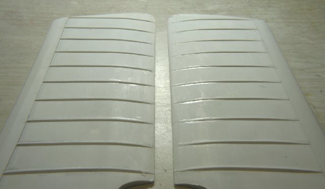

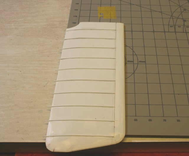

Salvage attempt # 284 (seems like it)
I glued 0.020" X 0.020" styrene strips on the top surface of the wings after sanding off all the previous rib detail.
Then sanded the ends near the leading and trailing edges until flush.  Wing on the left is rough sanded, the one on the right is finished.
[url=https://postimages.org/]
After cutting out the ailerons, I brushed on a coating of epoxy fiberglassing resin to blend in the ribs into the top surface.  The coating is self leveling, glass smooth, and hard enough to sand into a final shape.
We'll see how this works out.
After a light sanding, it will be primered before painting.

Re: The Tommy
« Reply #140 on: April 24, 2020, 08:35:00 AM »
Looks promising, Ken
I have some of those Altoids tins somewhere
Richard
Re: The Tommy
« Reply #141 on: April 24, 2020, 08:46:40 AM »
Looking forward to seeing how this works Ken, I suspect the answer is "very well". This is such an inspiring build, really enjoying seeing this unfold.
Re: The Tommy
« Reply #142 on: April 24, 2020, 06:20:23 PM »
I really like the outcome! Looks like linen over ribs :)

« Reply #143 on: April 24, 2020, 09:24:44 PM »
Hello all,
I am liking how this looks at this stage.  I let it cure overnight and today I will do some light sanding and primering to get a good look at it.  Hopefully, I won't be too distracted by the Roden Fokker Dr.1 and Albatros D.iii that should be arriving today!
I use some Altoid tins for holding small parts.  My wife bought a case of Altoids, so I have these tins everywhere.
Thanks for looking and commenting.

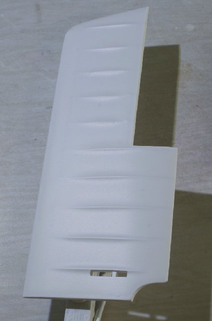

« Reply #148 on: April 26, 2020, 03:58:52 AM »
After a bit of sanding and cleaning up, I cut out the aileron torque tube opening and added the spar.  Then primered.
I think the wings look good enough to proceed.  Next time I use this technique, I will not sand the ribs quite so much near the leading and trailing edges.  In the top 2 pictures, the wing looks warped but its only the camera lens distortion.
