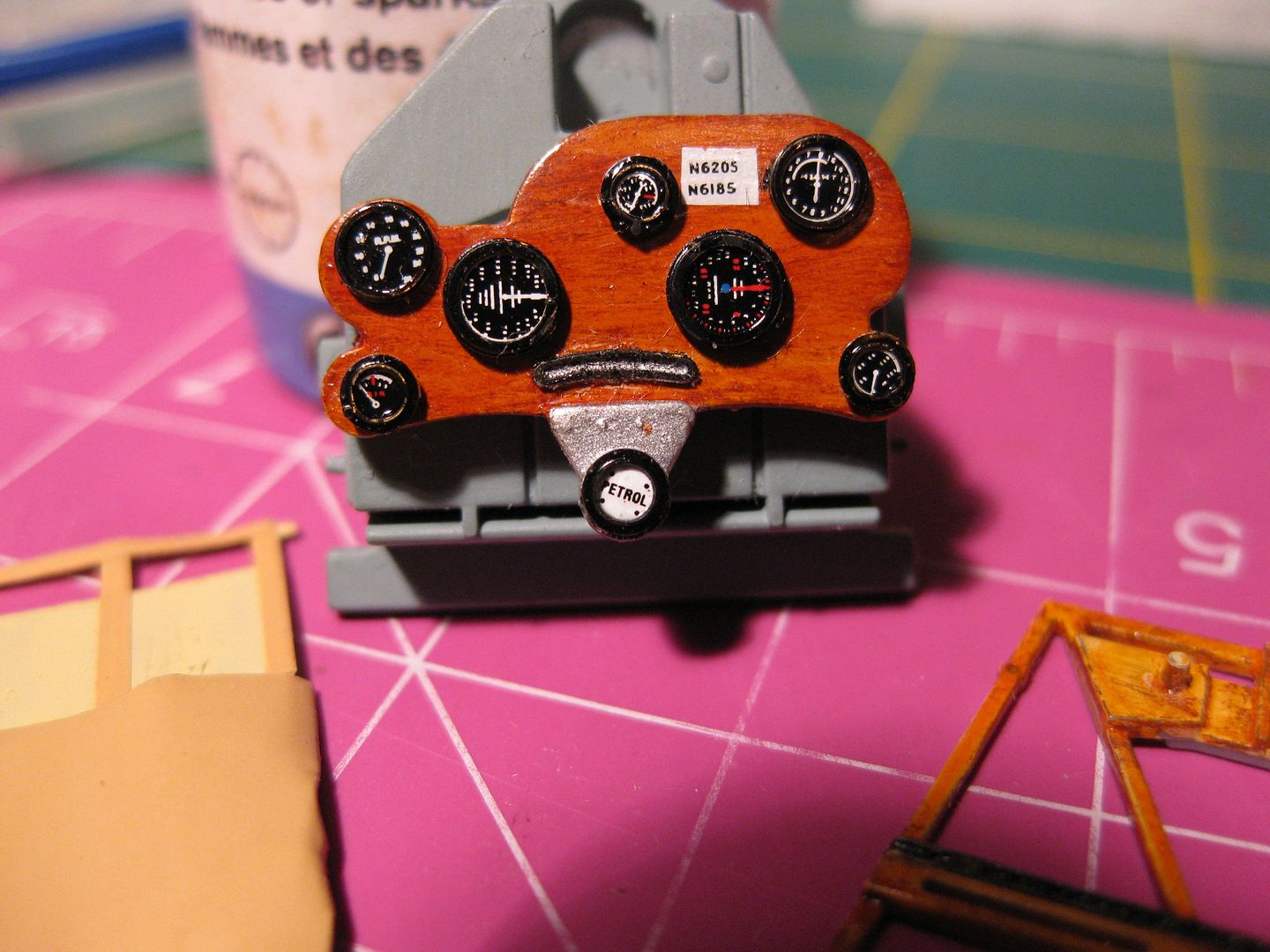

   The Instrument Panel was the first component completed. The panel was sanded flush, given a woodgrain finish of enamel base, acrylic woodgrain, and a top coat of Tamiya Clear Orange. Instrument bases were made from sheet styrene using a Waldron Punch and Dye Set, instrument faces added from Airscale Decals and Kit Decals, Aeroclub Bezels added, and the faces given a drop of Future to provide the glassed look. I also added a placard and an extra dial to replicate the appearance of the Hendon F2b and several photos of the wartime version. You'll note the placard has a few tail numbers as it was scavenged from a previous Build's left overs, I felt some lettering was important and my story is the numbers relate to a "code of the day" in the event of coming down over the lines. (works for me!)

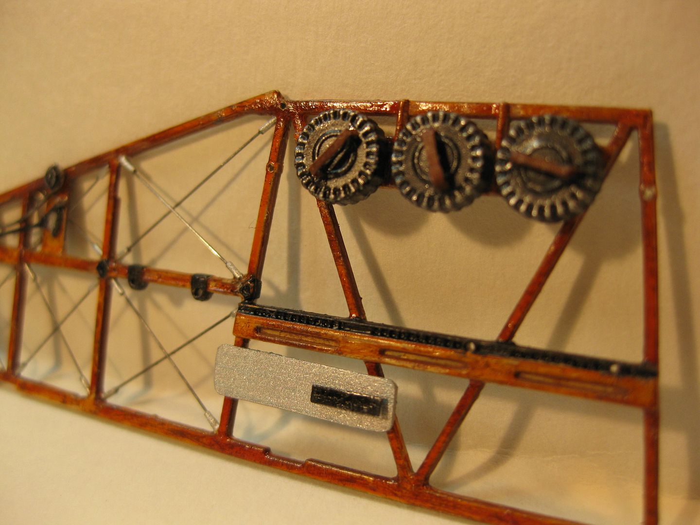

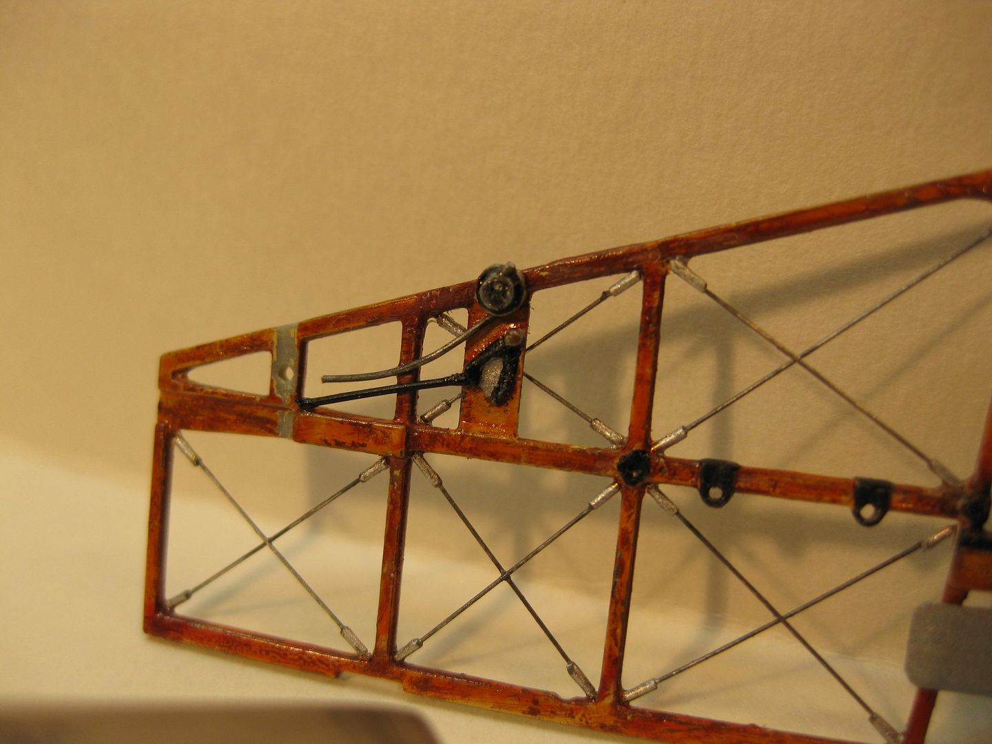

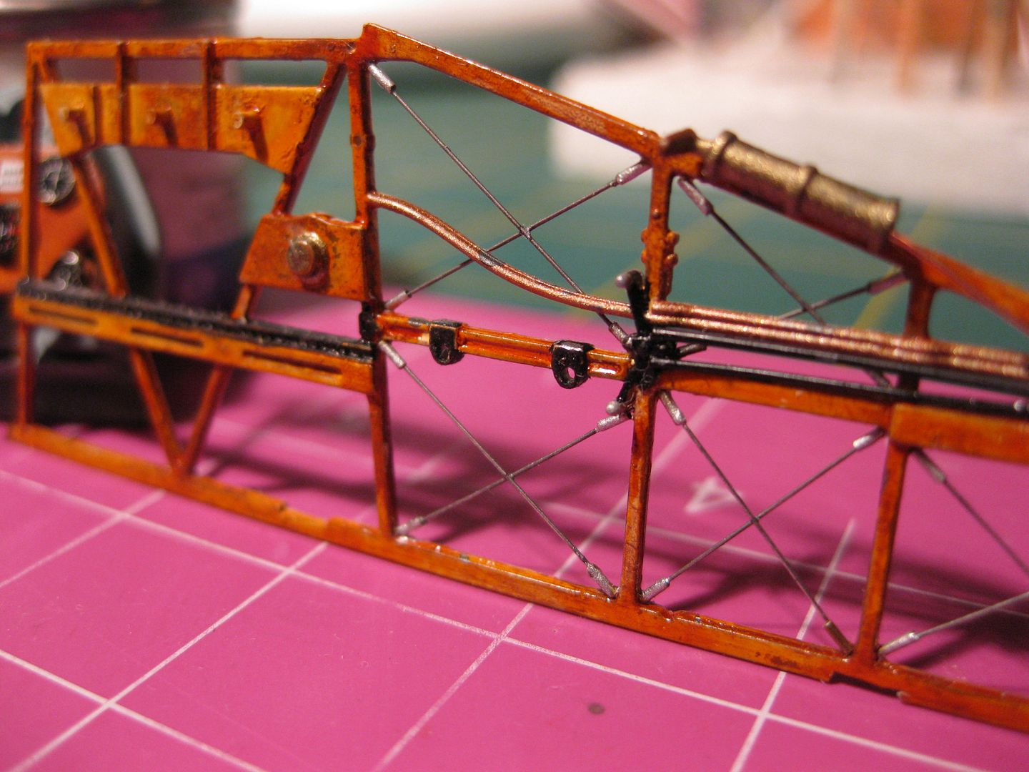

The cockpit side frames were given the same (but lighter) woodgrain treatment as the panel and several additions done. In no particular order I added fuel lines, throttle etc rod linkages, a brass resevoir or accumulator with plumbing above the throttle quadrant, a double lever control(?) on the left upper longeron, a control and linkage above the radiator shutter contol upper right, and then the cross bracing wires (guitar wire and 1mm brass tubing from Bob's product) The Lewis drum magazines were given scratched leather (thin styrene) handles once painted with Mr Metal Color and hilighted by dry brushing with flat aluminum. Last, the aluminum sheet panel in the Gunner's cockpit, right side, and it's fairlead/gusset "thingy" for the tail incidence control wires was scratched and added. These are photos of the cross bracing install #1, there have been at least a dozen more since as I have become extremely proficient at knocking them off while working on adjacent components!
This shot was taken before the addition of the brass resevoir above the throttle quadrant.
   Next (in the next few hours) pre-rigging of the Flight Controls, completion of the floor portion, and installing the let frame to the floor assembly after final cockpit additions.

Outstanding Lance!
It's all looking very good and I can see that you've put in a lot of time and effort into the office. With results like this, your time has been very well spent. Nice woodgrain effect all around, and especially on the instrument panel, and all of the extras will make the cockpit look properly busy.
Looking forward to seeing more!
P.S. After seeing this, I'm fully satisfied that there are actually two ringers in this mini GB of ours!

At  last a progress report on the Mckeever project.  Well worth the wait, your instrument panel is the bees knees.  I like the placard.  Your logic works for me as well, adds a little interest in there.  I have yet to try that sanding off the molded in bezels, but will give it a go at some point.  Your interior framing is coming along nicely.  Nice wood tones that will stand out against the fabric color.  Obviously you were a pilot as a lot of what you covered I know nothing about, so........I will be watching with interest as  you progress and comment.  This a/c is high on the "to do next" list.
