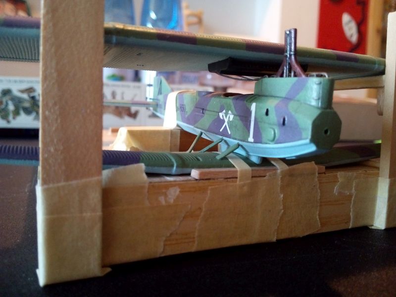

Offline AndRoby67
  • Posts: 278
Re: Macchi M-5
« Reply #279 on: April 03, 2020, 08:13:48 PM »
Hi Mike,
the fin/rudder are really beautiful, you have obtained right shades of red and green.
In your shoes I will think to build an alignement jig for assembly wings and struts toghether.
In the M.5 not a simple task, as you wrote. In 1/72 I used this one, homemade:
My two cents!
Roberto
Offline Mike Norris (UK)
  • Posts: 2719
Re: Macchi M-5
« Reply #280 on: April 03, 2020, 09:24:48 PM »
Hi Roberto,
Yes I think I may have to resort to a jig of some sort.
Normally I never use alignment jigs but this model, especially the centre struts with the engine, will need somethng,
