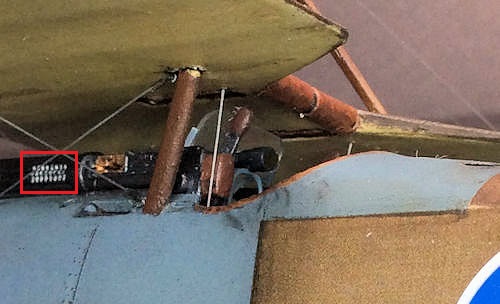

A question...what's the white thing "inside" the machine gun?
Robin

Hi Robin,
I'm not sure what you are referring to.
Possibly light reflection from the grid vents on the machine gun cooling jackets?
Maybe the ring gun sight, located inboard from the right machine gun?

« Reply #174 on: October 02, 2019, 12:31:26 AM »
I guess it's reflection...
This is what I mean.
Robin  :)

« Reply #175 on: October 02, 2019, 01:50:47 AM »
Hi Robin,
Yes that's it - light reflection when taking the shots,
