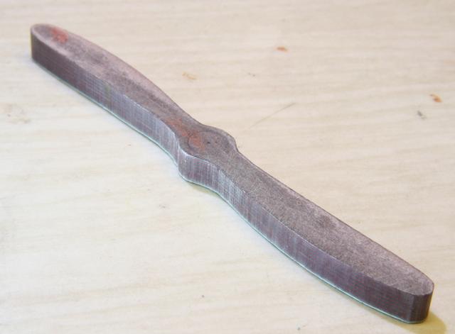

A quick update.  The On-rio only lacks a prop and the aileron control horns.  Then I plan to make a seaplane dolly to display it on.
This one will have another 'paper' prop.  Here are the layers of a report cover and the pattern.
After some CA glue and some sanding on the belt/disc sander, I have a decent prop blank to work on.
I understand French props were a deep red-brown color with the layers not very visible, so this one will probably get painted.
Thanks for looking.

A interesting approach in using paper for the air screw.
Hmm, may be in some cases also useful for me, but in general I like to stick to my real wood.
Can this be sanded easily?
Re: scratchbuild 1/32 Hanriot HD.2
« Reply #114 on: July 01, 2019, 10:21:42 AM »
Prop in progress...
The CA glue/paper fiber material is very hard, probably harder than wood.  It can be sanded and I use a belt sander to rough out the shape and then hand sand to the final shape.  For best results, it should be sanded/filed in the direction of the paper grain (one can determine that with a little sanding - it looks fuzzy if you don't sand with the grain).  I periodically have to recoat with CA where the glue has not penetrated well.  I think wing struts could be made this way as well.
When coated, the reddish brown color comes out.  I have put 2 coats of Tamiya clear red mixed with clear orange on it and will sand/polish it for a better finish.  I like the way it looks, so I doubt I will paint it.  I have also made the prop boss, which needs dull coating and some photoetch bolts.  If you look closely, the laminations are visible because some layers are pure red.
