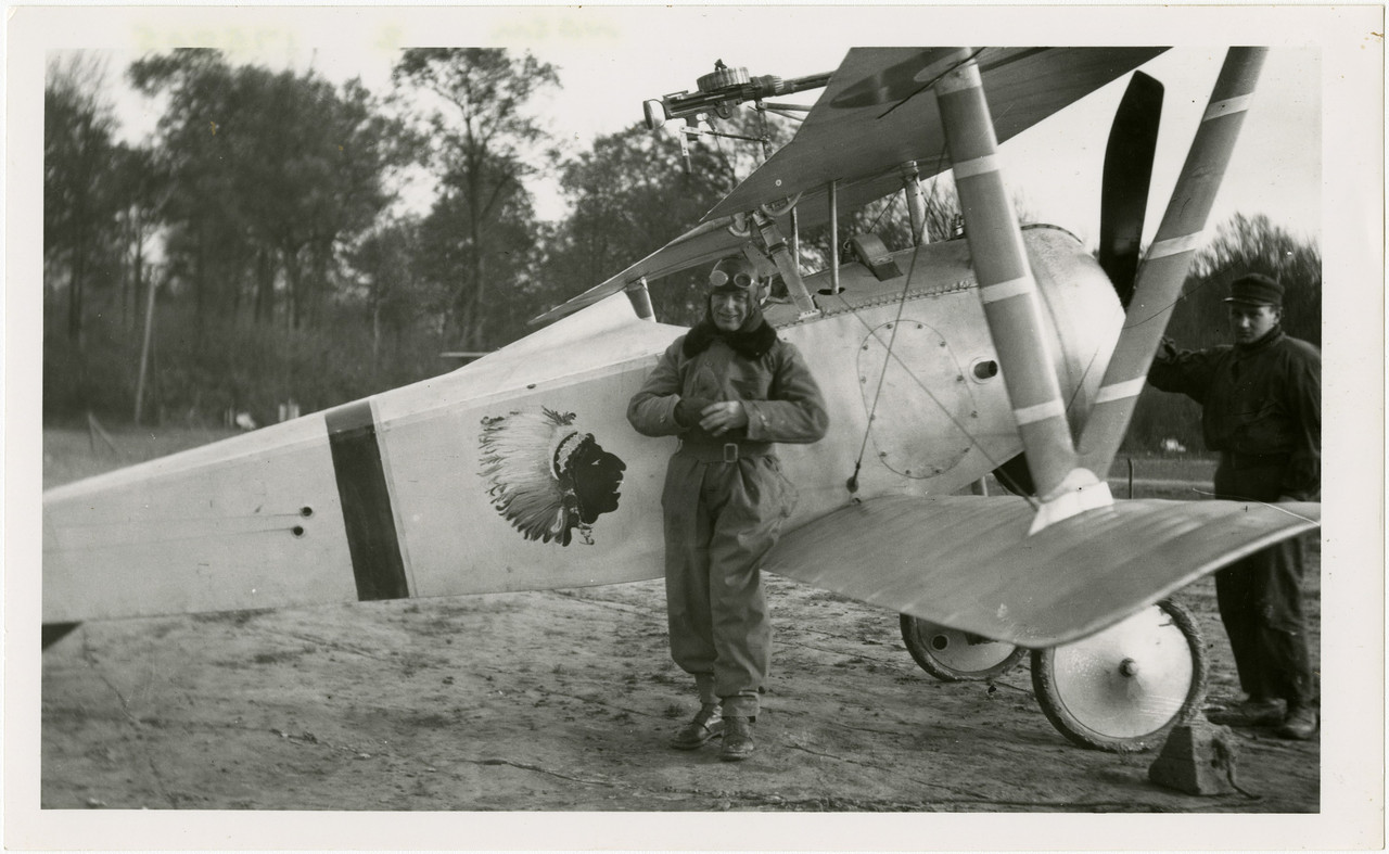

Looking through photos in the Albatros production Nieuport Flyers of the Lafayette Escadrile I thought I had confirmed that it indeed had clear center upper wing panels, photo 40 page30. Then I found this on a google images search:
Doesn't appear to have the clear panels to me, or does it? If so which center section would I need from the CSM XVII early kit?
Enlarged the photo and yes, I think it has clear panels.....or not  ::)

I think Soubiran's DOES have the clear center panel; it looks like the top of the left front cabane strut is being reflected by it.  If so, you'll need the French (Moreau??) three-legged Lewis mount, and the matching center section will be the one with the constant-width center member (sorry, I can't see the parts numbers in any of the available sprue pics). The windscreen looks to be the flat variant (not the wrap-around frame Nie.11/16 type).  BTW, where did you find the Seminole head in 1/32?

Hi Rick, based on the photo above I do not see a clear section on this picture (my old eyes may be wrong), and it looks to have the latter windscreen and feed for the deck weapon, also the cowling has the ridges on top, so maybe a late version?  Your opinion will be the one that counts.

Transparent center section confirmed! Photo of N1977 on page 11 of Windsock Datafile 20 shows it clearly, and it also shows Vickers gun armament, so you have an alternate to the Lewis gun should you choose it.  Wheel covers appear to be the same grey tone as the red of the roundels and the fuselage band; also painted red, perhaps???

Rob and Juan. Thanks for the responses. I now am really certain that the Soubiran N1977 has the clear panels. I kind of figured out about the proper center section but thanks also for confirming my thought. Also note that it clearly has the riblets on the wings.  Looks like Edgar needs to release an "Early Late " kit to handle some of the oddities  8)
