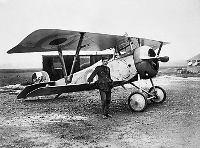

Anyone have any ideas about which kit to start with for Billy Bishop’s B1556?

32002 (Late), as it has the cowl with the horizontal (3 and 9 o'clock) reinforcing ribs evidenced in photo of B1556 with WAB leaning against the starboard lower wing.

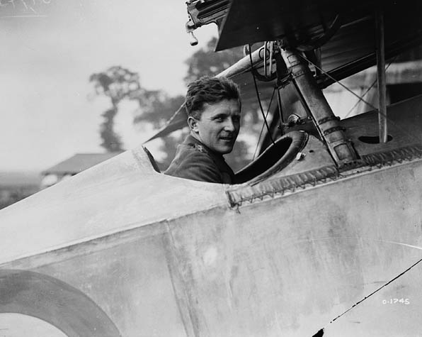

I agree as to the best version to start with. That being said there are Numerous changes to make. No Vickers is Mounted and there is No sign of any of the paraphernalia connected with the Vickers . So a solid upper cowl section and who knows about the boxes for ammo in the interior. An opening in the upper wing center. Aldis Sight mounted under the upper wing center section for the  overwing Lewis probably on a Foster Mount. These are Just the more noticeable differences. I would wait a bit and see if Edgar releases a British variant as he once mentioned that RFC birds would be a lot different. So very doable but would take a some work!
PS: Strut Mounted Pitot
Pulled off of the WEB so as always if Copyright is a problem the photos will Happily be removed.

Sorry, should be, of course B1566 . . .
