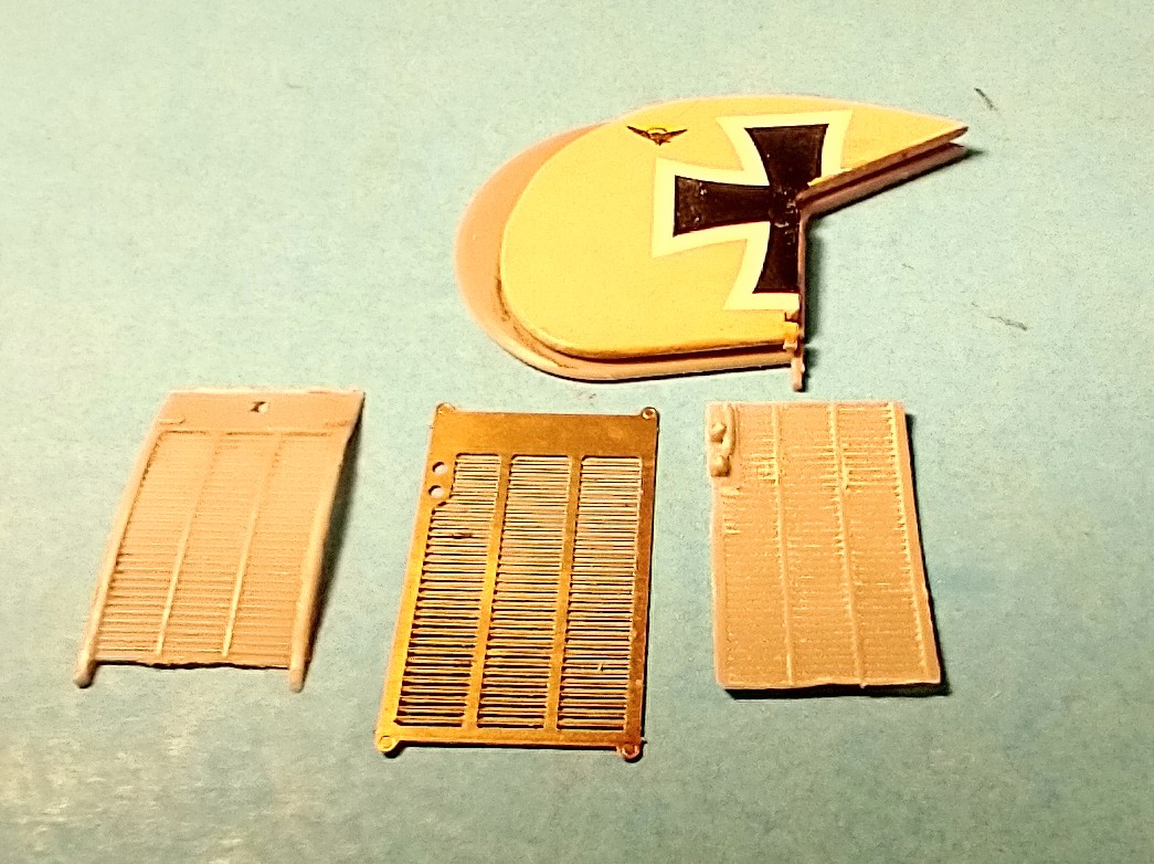

If you read it on this forum it was probably My build log. The answer is Yes the Radiator is Oversized on the Roden OAW version. Oddly on the original central radiator version of the DIII it is correct.
 Here are some other suggestions for correction:
1. Find someone that built a WNW DV and didn't use the Teeves and Braun parts. ( The spare parts board is a good place to ask) Remove the kit radiator and either cut a hole for the WNW version or sand it paper thin. I have done both.
This is the wnw Radiator sanded thin and shows the size difference compared to the Part PE version:
and by the way, the rudder is also oversized.
2. Bo does a beautiful Radiator that is 3D printed. You would Have to open up a hole in the wing to use this one but it is gorgeous. He is on the Forum under :
https://forum.ww1aircraftmodels.com/index.php?board=91.0
3. The Part PE Radiator for the OAW kit is Also Oversized but the Fret does have some nice stuff to update the kit.
