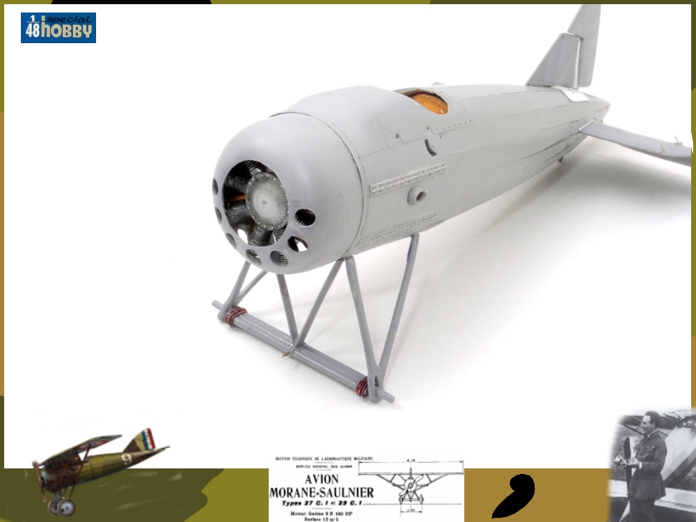

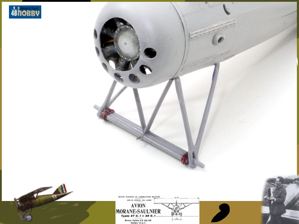

description of the landing gear for those who can read in french
fuselage is over:
Xan

I am preparing the struts
Of course i broke all my drills before I ended the stuff...
so I had to buy again in internet...
Meanwhile, let' see another thing...

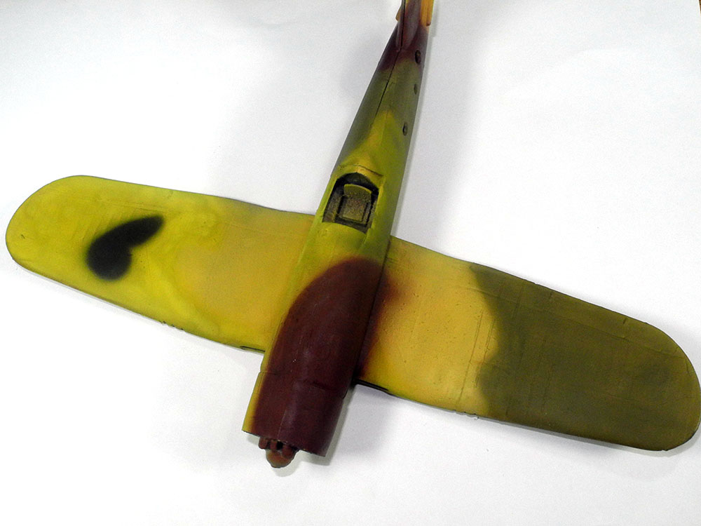

Paint!
1 step, colour definition and gunze or tamiya equivalences...
but let's beginning with an historic...
since middle of 1916 french plan's fabrics are covered with silver dope wich protect it againt UV
in the beginnning of 1917 colour pigment are introduced in the dope keeping the aluminium pigment.
and a five colour camouflage is proposed. Bur it is still dope and not paint.
Ripolin propose paint in the same colors for metal and wooden parts.
here the 5 colour sheme:
As far as I know, two autochrome show us this camouflage:deux autochromes qui nous montrent ce camouflage:
In "Cross and cockades" the "butterfly" project worked on this camouflage un the 70's  and later Alan Toelle wote an article about this camouflage in the Windsock vol.30 n°1
we can found here the proportion of diferents pigments of each color
Lance Krieg applied those mix in his models.
Marc Chassard French specialist of french WWI aviaiton went more far:
He bought fabric, dope and pigments, and applied the dope in the fabric as it was done in 1917, respecting all the coats...
then, he cutted little piece and propose a colour shart very accurate...
it was my reference to find equivalences in gunze or tamiya.
i took alll the paints i had aronud the fabric colour and test them
here is the result colour by colour:
beige
light green
dark green
brown
light yellow
final result:
just have to test it now....
in a second step i will try to resolve how to represent the metalic aspect of the dope
Xan

« Reply #37 on: April 09, 2018, 08:32:02 AM »
That's what I did ...
horreur!
what i ridiculuos with my methodic approach...
so I take again and look for colors closer at the Chassard colour chart.
In fact, I rework the light green and the beige.
And that is what I reach:
the global tonality seems to be OK thiis time
so, here the new equivalences:
Paint seems OK comparing with the chart, we have noow to compare the chart with other elements....
Xan

« Reply #39 on: April 10, 2018, 12:15:52 AM »
Thanks Rag!
well the color are quite strange to our eyes and a little far of what we are used to see on 5 colour french camouflage...
particullary the light green, very "zinc chromate".....
but in this original 5 colours camouflage scheme: the light green is in the same tonality...
Of course we have to hve in mind it could be a lot odf diferences betwwen dopes, because there was a lot of providers...
But this proposition seems coherent for me because it have been done after a serius work, so i keep go on with it....
Xan
