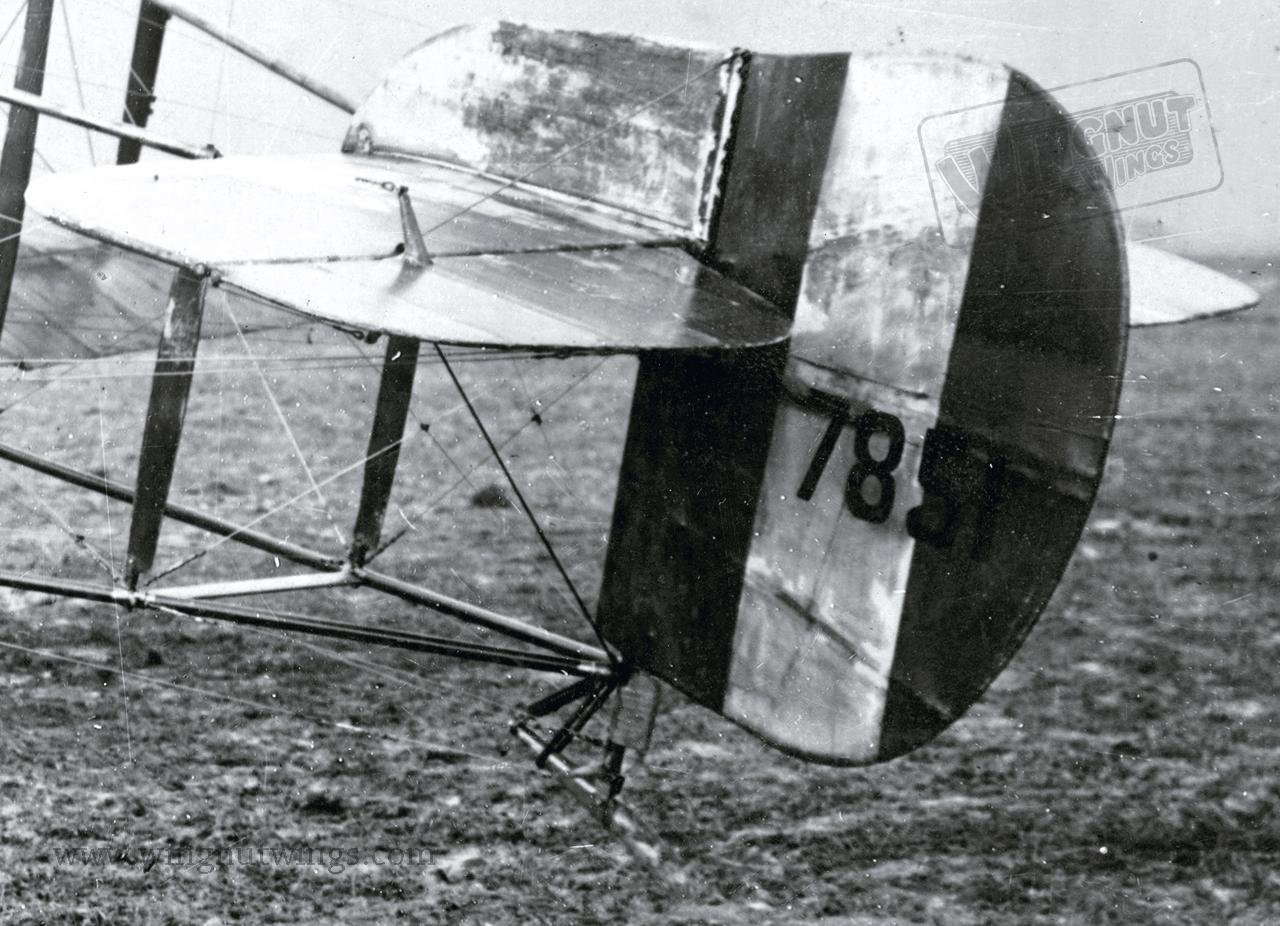

I went on working on the tail.
I sprayed the white, red and blue.
Then I tried kit decals...  ::)
Well, you see the result. they are very brittle. I  retouched the serial, and in real life looks better than in picture.
I have to do some shading to make the internal structure more visible and when the model will be finsihed I'll work with oils and pigments.
On the real plane the paint was weel worn out, so to replicate this I applied some maskol on the leading edge to simulate the discoloration.
It needs some more work but as base it's ok for me .
