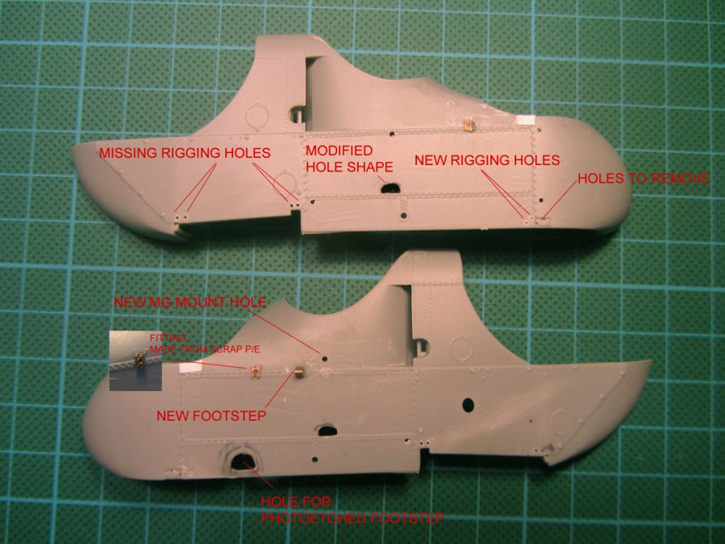

The kit is wonderful, but needs some minor tweeks to represent the 6341 (it's impossible to make a kit perfect for different subjects of the same aricraft):
- On the rear of the nacelle there are some missing rigging holes
- The rigging holes on the front should be moved a little back
- The hole on the left side of the cockpit for the mg mount should be higher than the the one on the right
- The shape of the two holes on the cover should be more rounded (should be refined on my model, I've to thin the plastic more)
- I have also cut in half the plate on the back of the pilot like Przemol did, so I can achieve a better finish on the side and work easier on the central part

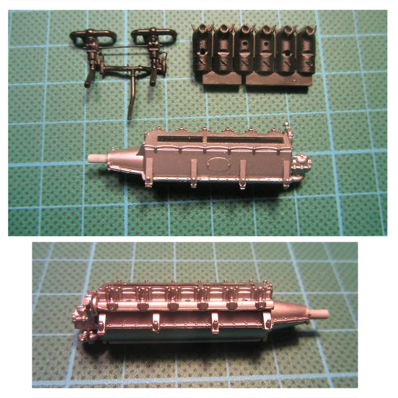

I also started to work on the engine. For now I have onlyreplaced the carburetor rod with a copper wire, more later...  :D

For example on the engine I have used for the first time the Alclad.
I was a bit scared because I have read some comments about how was difficult to use, but I was surprised how well it went, both the primer and the aluminium. Maybe beginner's luck??  :P

Alclad is fairly easy to apply as long as you take your time by building up many thin layers and making sure your airbrush compressor is set to around 10psi.
You don't always need to prime the part for Alclad to work - bare plastic works, also.

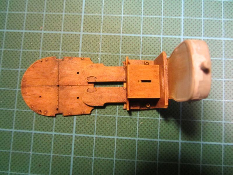

back to work: I've started to make the wooden parts (usual acrilic base, oil paint and sponge)  and I went on with engine (lots to do but the base color is on)

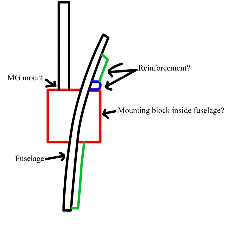

Basically seems that inside the fuselage there is a reinforcement for the mounting block for the MG mount and also a couple of metal reinforcement (at least looks metal... it looks like the metal cockpit surrounding). I haven't seen other pictures that can confirm this, any idea?

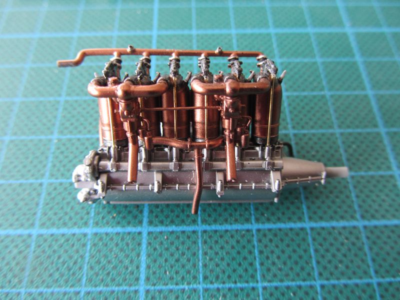

I've built the cockpit and went on with the engine. Still some wires to add, but I'm almost there. The safety belts are only placed in the cockpit to adapt them to the seat, but they aren't glued or painted yet.
