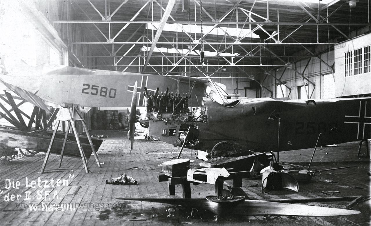

Even WNW missed that detail-where were the hooks for lifting by crane attached to?Must have been at least 3 eyelets or whatever inside the observers pit and the engine compartment...any ideas or photos ?

what's logical to me based on photos on WNW site:
Front: rear motor mount, both sides
Rear: front cockpit, both sides where spar meets floor

 Bo,´that is what I thought about,too,but is there enough space between the engine and the cowling cut out to allow the cables running straight in an angle to join those from the observers pit ?

Should have listened to Lance's advice!WNW archive features two pics of a dismantled W29 post war at Wilhelmshaven showing the lifting cables fixed somewhere to the upper longeron in the observers pit and at about the middle of the engine compartment.
   There's actually about half a dozen good shots there showing the cable routings; I always miss the wealth of info in these archives as well. Big bold note to self!!
If we are talking about this photo:
To me it looks like the front lifting cables are attached to the rear motor mounts; the rear lifting cables surely appear to be going into the pilot's cockpit (not observer's) -- maybe attached to longeron, but to me it makes more sense that they would be tied to the main spar.

You're absolutely right ,Bo, I don't know why I confused that :-[!
