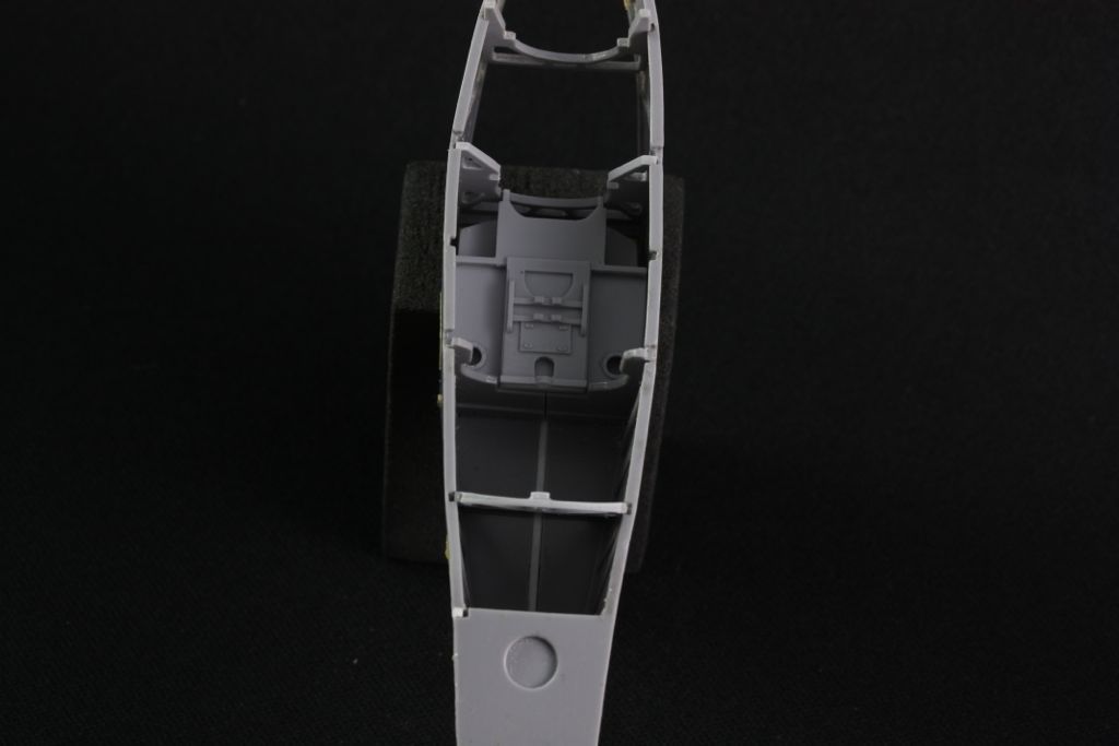

At this point you also want to open up all the holes in the fuselage.
The vertical slots next to the cockpit should be 1mm wide x 8mm tall. I am advised that these are corrected on second run castings, but on first run castings, they will need to be enlarged as they are only about 6.75mm tall.
The hole near the nose should be reamed out to 3.9mm.
You'll find round rectangles embossed on either side of the fuselage for the engine compartment vents; these should be opened up. The width of these slots is 2.5mm.
You'll also want to ensure the holes for the stainless steel lower wing pins are large enough -- the pins are 1mm in diameter. You don't want to be fighting this when the fuselage is alll painted and decalled!

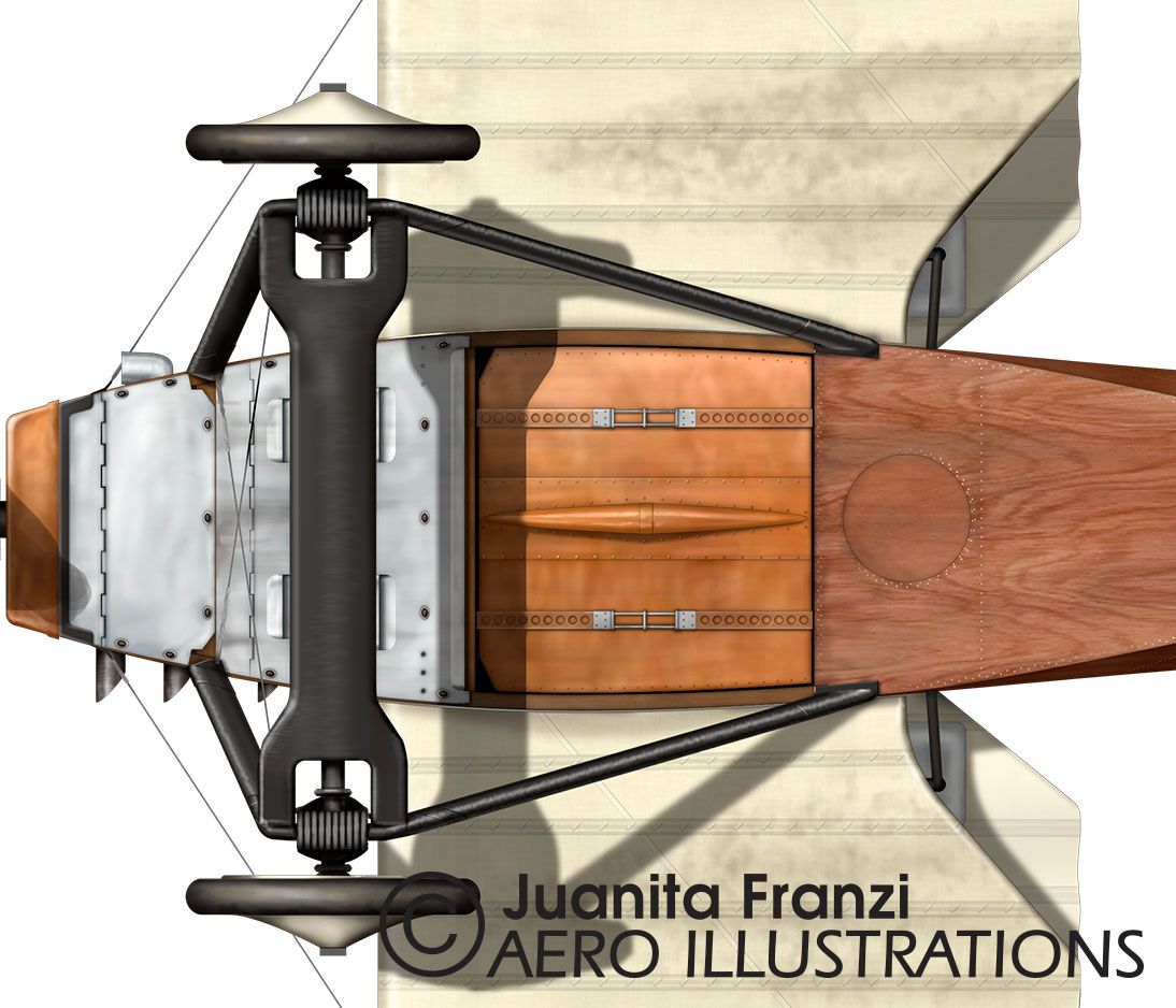

Thing 1: The fuel tank on the original aircraft was suspended in a cavity in the bottom of the airplane. A fragment from Juanita Franzi's illustration tells the story:

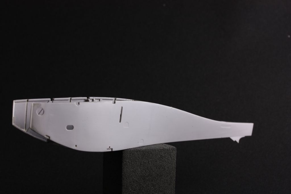

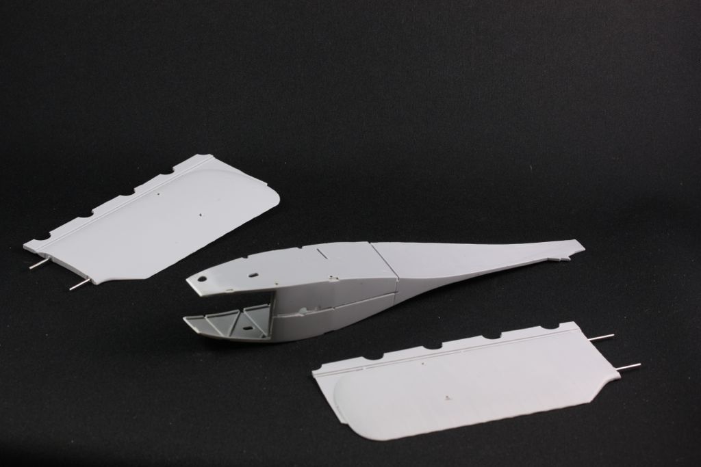

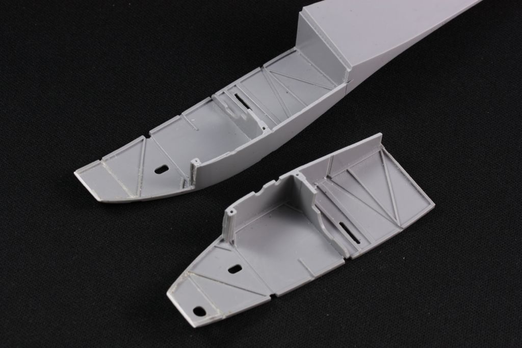

... I've cut apart the fuselage sides.

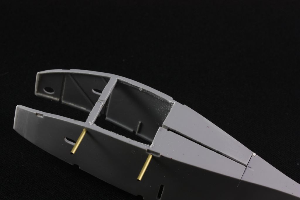

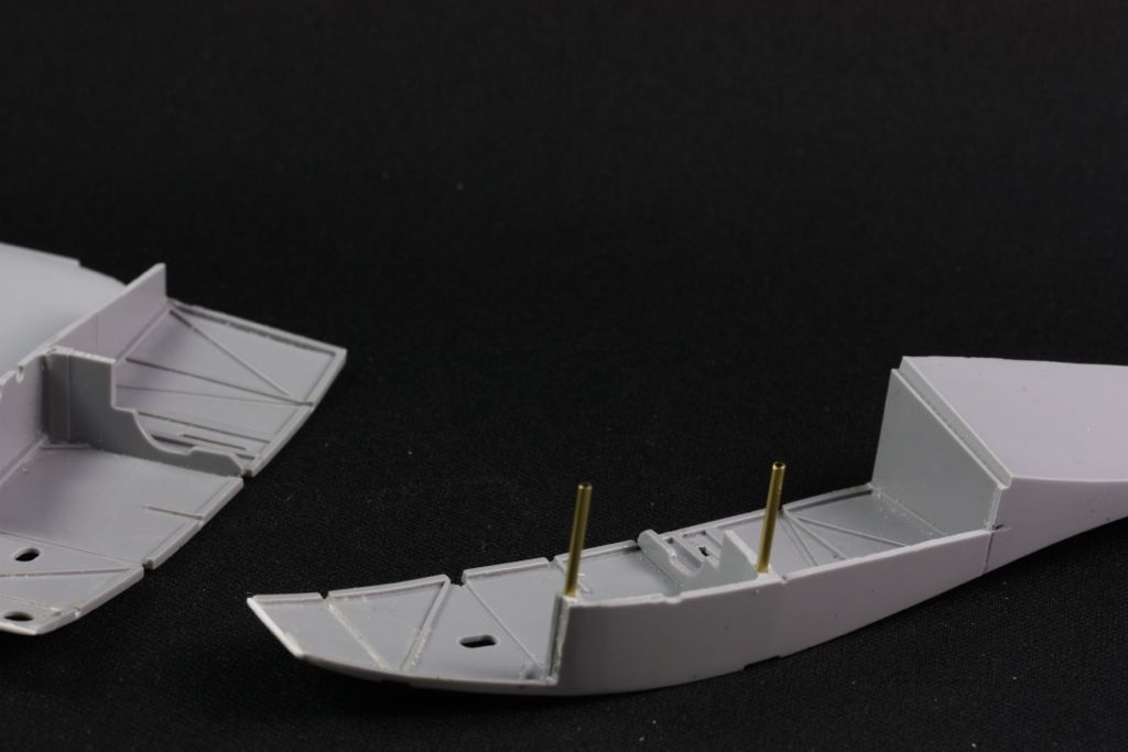

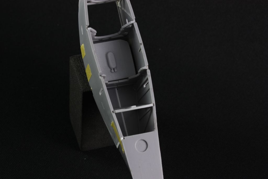

Which revealed something I personally found remarkable: the 1mm holes for the wing spars go all the way thru the castings(!) Oh and yes, perfectly straight, to boot. How in the hell did Ron do this? Anyway, this fact greatly simplifies my problem of working out how to put this all back together!
 I've bored these holes out to 1.3mm, and fitted brass tubes inside:
so the whole thing falls back together...

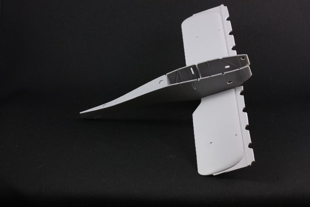

oh, and the wings fit positively:
« Last Edit: January 20, 2017, 10:29:22 AM by Bo »

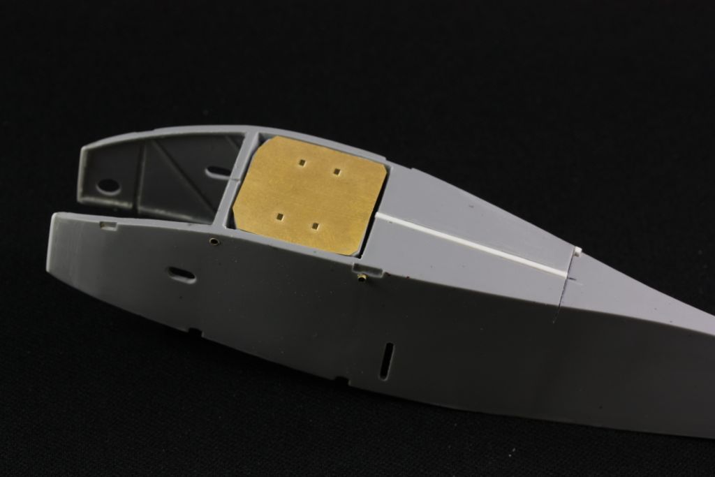

fuel tank cut out
Area for the fuel tank brutally cut out:
approximation of fuel tank -- resin & PE -- but will require 1mm wafer to get to correct height:
basic idea of how it will sit in the fuselage (meanwhile, floor seam has been mended with styrene)
« Last Edit: January 20, 2017, 10:30:39 AM by Bo »

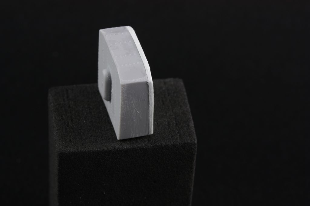

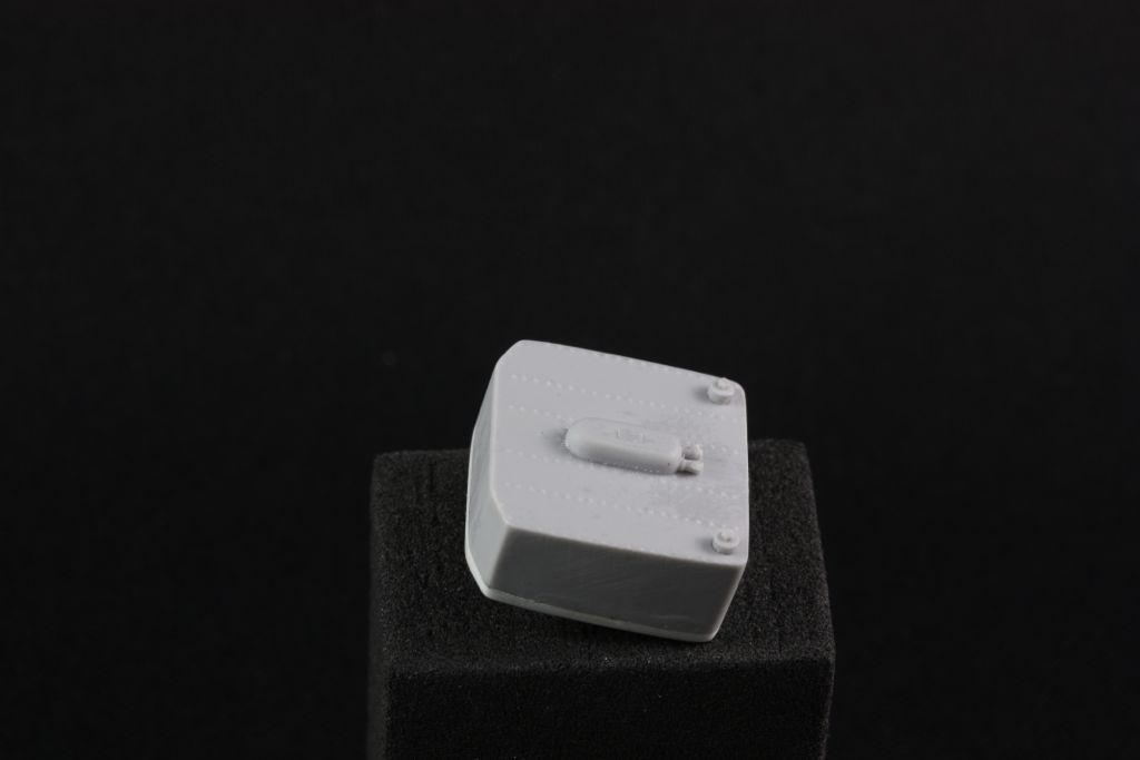

Fuel Tank

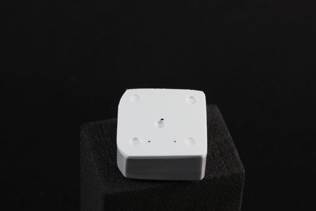

tank height is padded with 1mm wafer (actually two .5mm panels -- I didn't have any 1mm styrene sheet):
shallow holes drilled into wafer to aid gluing in upcoming step when PE panel is applied:
meanwhile, 2x parts F1 are fitted into .9mm holes in bump on top of tank...

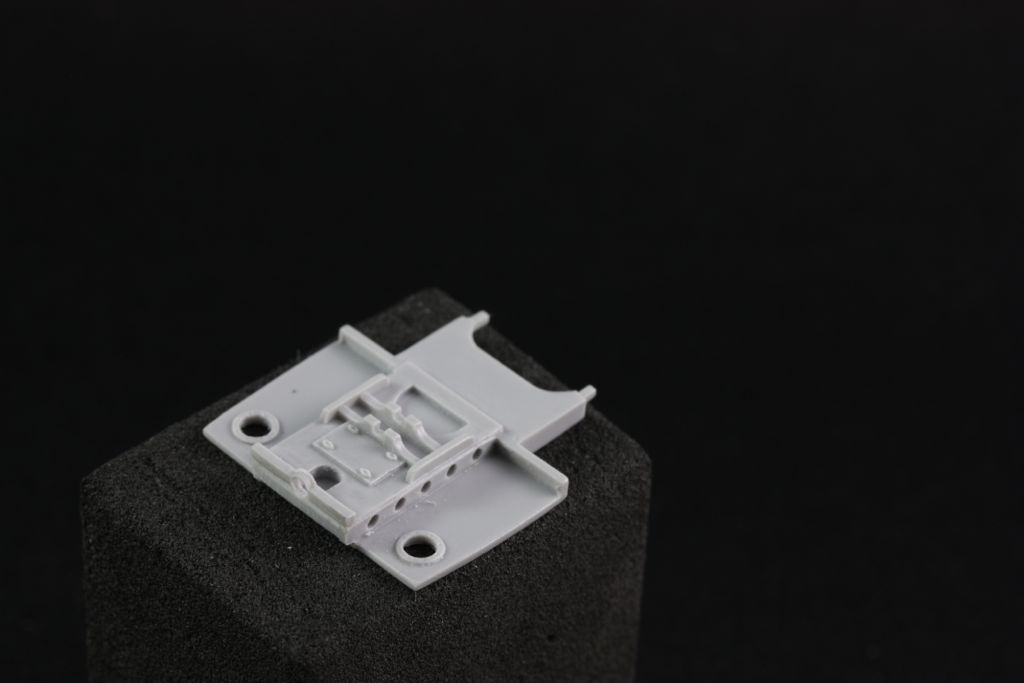

And you need to cut out the exquisite floor piece, H1 now. Once cut from the block and cleaned up, it should look like this:

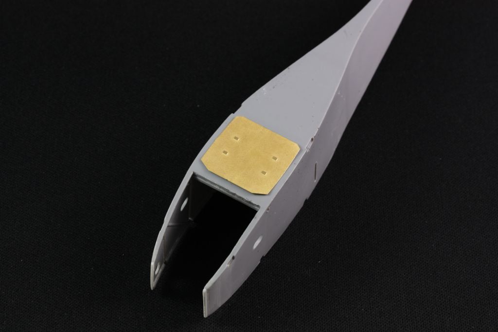

We need to fit the fuel tank temporarily into the fuselage:
...and set the floor piece on top of it...
... in order to mark the position of the large holes, which is done with a 2.5mm bit, by gently turning just a few times.

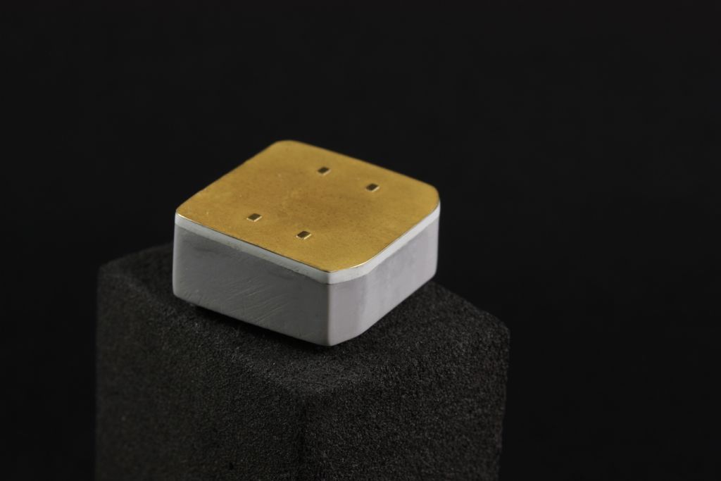

At the positions just marked, 1.8mm holes are drilled to just .5mm depth:
...and 2x parts F3 glued in:

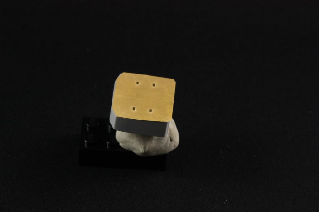

The PE "appliqué" is glued on the bottom of the tank:
And finally the resin sump part F2 is added to the bottom of the tank:
I'll add the straps and buckles, which are provided as PE parts, when I get closer to installing the tank.

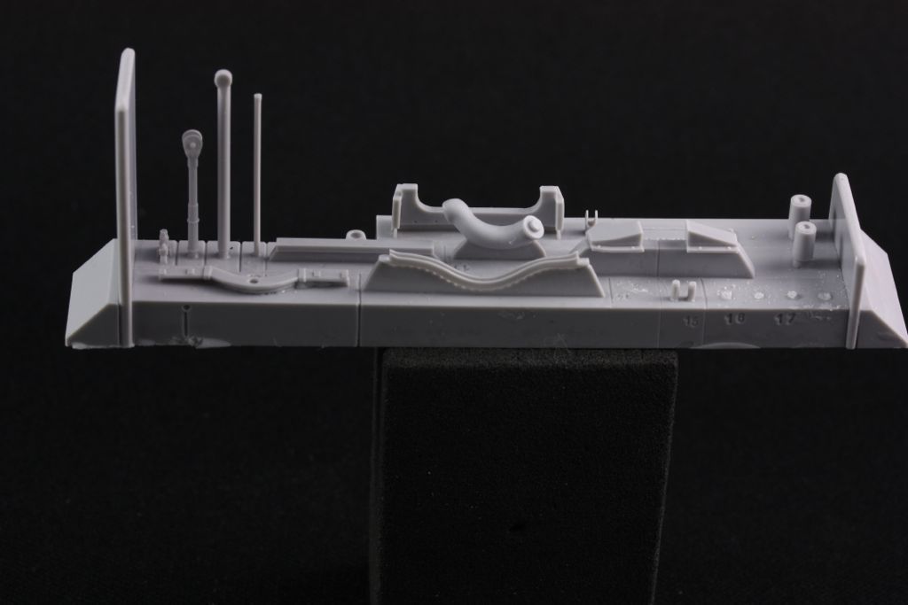

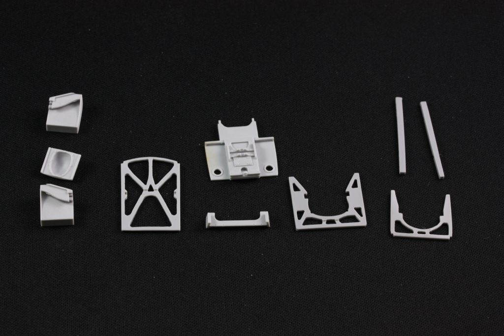

many of the parts for the next steps are on this casting block, which proved a bit of a challenge to get parts off without marring the others, as they all rather diabolically overlap. But taking it slowiy...

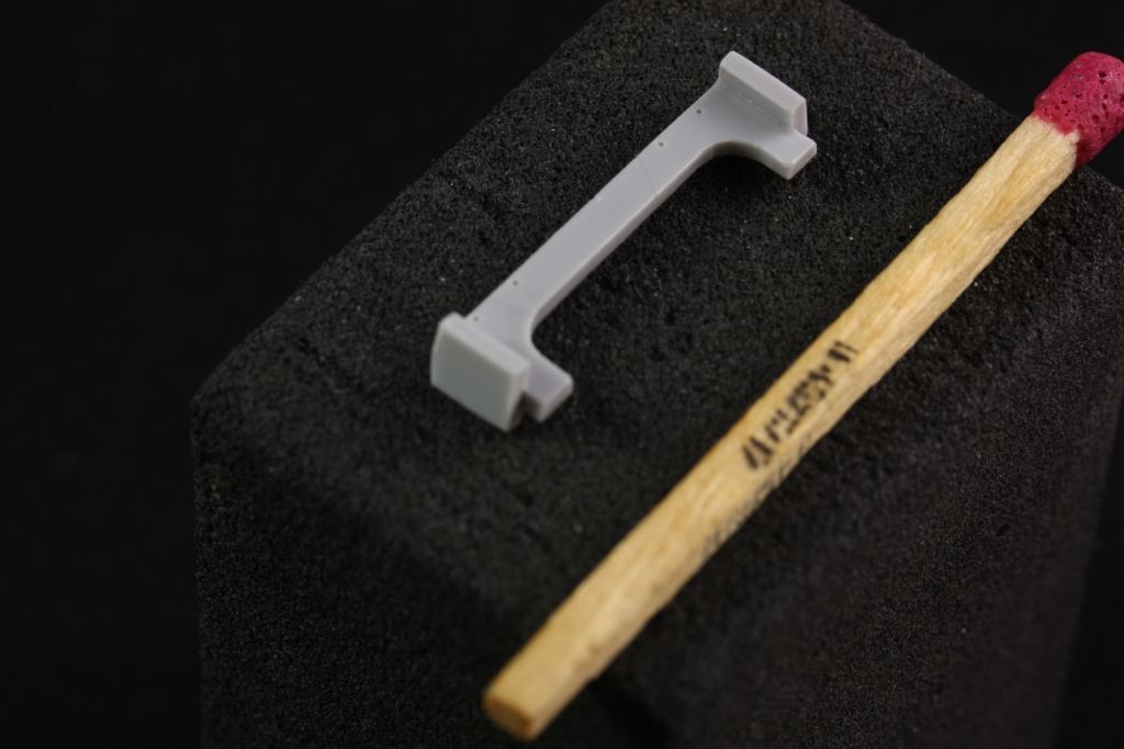

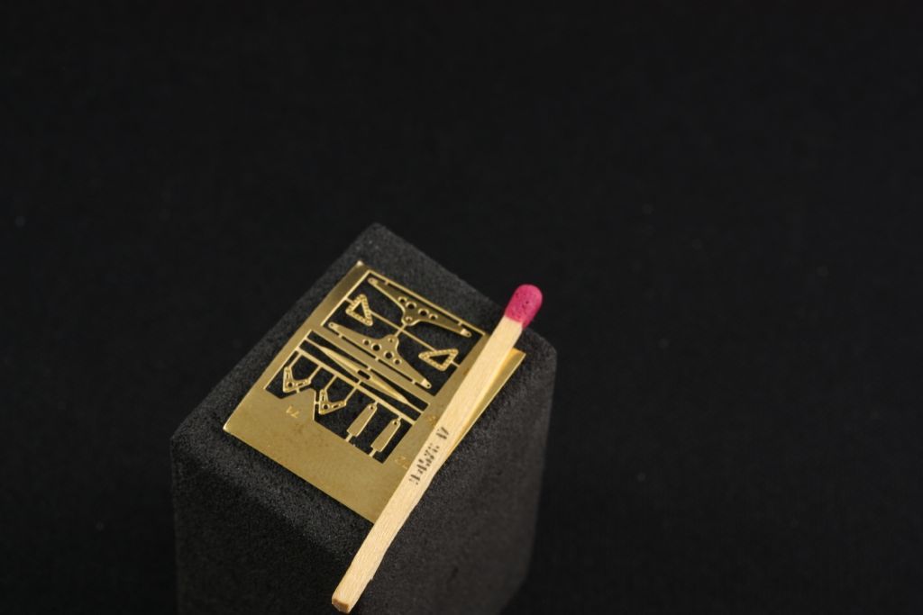

The complex aileron control horns are made from the PE parts seen here:
And will be mounted to this cross piece, which first needs some small holes drilled to accept pins:

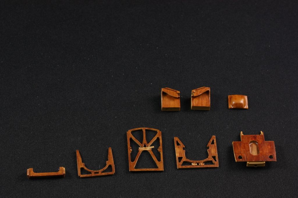

these parts form the interior structure:

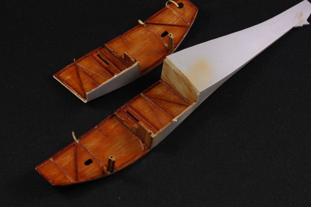

But before I can go any further, I need to wood grain the cabinetry.... base coat...
oil coat started...
Re: Ansaldo A.1 "Balilla" 1/32 Aviattic OOB

Looks great! I always wonder if there would be a better solution than that huge chunk of resin under those parts? I realize it may be the caster's answer to a sprue, but that is an awful lot to have to cut away. Maybe the parts count makes gang molding of individual parts too cumbersome. No disrespect to the manufacturer intended at all, this model is something that I believe, none of us have ever seen before. The bar has definitely been raised.
« Reply #134 on: January 24, 2017, 02:05:15 PM »
One the positive side, the parts are exquisitely cast on this block (i) as they are on others. Much thought appears to have been given into ensuring that cutting / sanding occurs where it will show the least. But it is a challenge finding a way to cut the parts off without affecting the neighbors. (It can be done though!)
