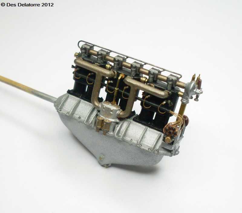

Re: Jeannin Taube - 1:32 scale
« Reply #46 on: September 10, 2012, 07:07:05 AM »
Just the one photo to show you where I am up to. The other side of the engine needs plugs and leads and some plumbing. I will be adding the throttle linkages to the top of the carburettor plus a bit more plumbing, the water pumps still need to be fixed to the rear of the crank case. It is nearly starting to look like a Mercedes D.I engine, the conversion has been quite involved.
« Reply #47 on: September 10, 2012, 04:37:41 PM »
Wunderbar!
« Reply #48 on: September 11, 2012, 12:38:13 AM »
Another gem!!!
« Reply #49 on: September 11, 2012, 12:40:24 AM »
As always, when I see wiring like this, I get soooo envious!
« Reply #50 on: September 11, 2012, 01:09:01 AM »
Marvelous work, Sir!
You are a gentleman and a scholar....
« Reply #51 on: September 12, 2012, 05:02:11 PM »
Just a very small update, I have added the throttle linkages and a pipe from the carby, also the water pump and rear engine plate, I also completed the ignition leads on the exhaust side of the engine, I'm waiting on some small plastic tube so I can fitt the water pipes.
« Reply #53 on: September 13, 2012, 12:19:10 AM »
Wow, Des!  You've done a phenomenal job copying the Taurus engine.  In fact, yours looks even better!
« Reply #54 on: September 13, 2012, 01:16:27 PM »
I added the two small Mercedes badges to either side of the engine, they are fitted in the front engine mounts. These are made from 0.18mm copper wire, the outer circle is 2.0mm in diameter and the star is made from short lengths of the same size wire, it is all held together with very tiny drops of CA, I painted them with Humbrol 27002 polished aluminium.
