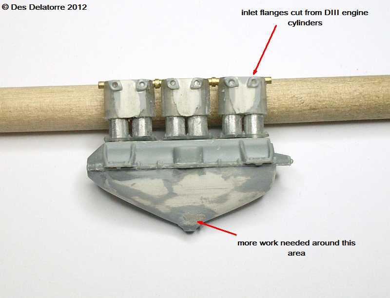

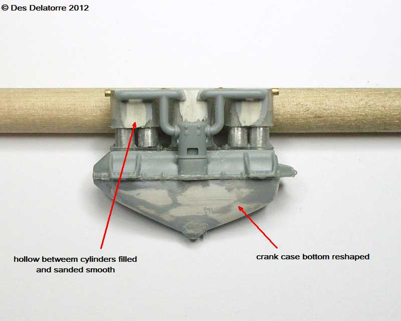

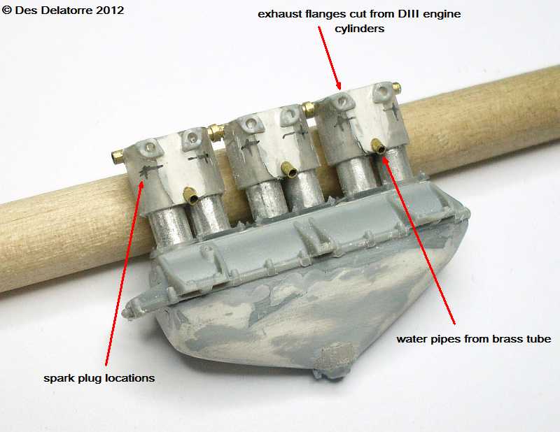

Here is a very small update. I have been working on the engine, I am converting a Mercedes D.III to a D.I which involves quite a few modifications. The bottom of the crank case has been reshaped, I did this using an epoxy putty. The three paired cylinders have been made and the manifold flanges added, both inlet and exhaust. I trial fitted the inlet manifold and it fits perfectly not only with height but distance between flanges, I got lucky with this one. I need to add the spark plugs and priming taps, a bit of paint then some plumbing and wiring. The following photos show the uncompleted engine still with plenty of work needed, but it is starting to look a little like a Mercedes D.I engine. The cylinders are not fixed to the crank case at this stage, just sitting there for the photos.

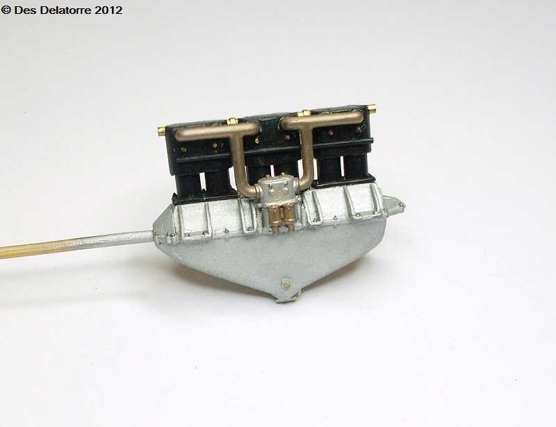

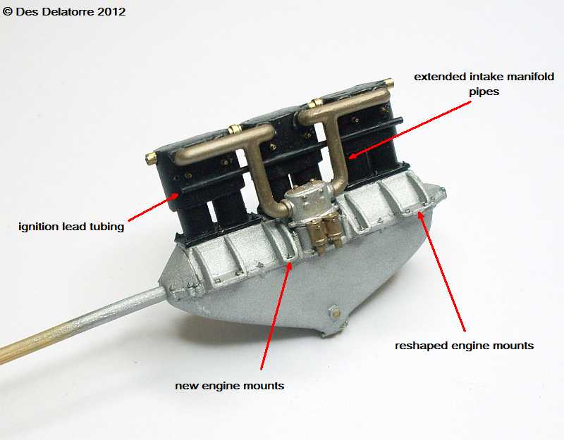

« Reply #44 on: September 07, 2012, 03:55:38 PM »
