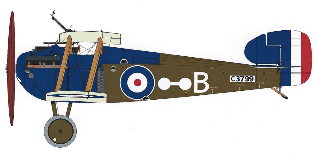

C3799, Captain G. B. Irving, 19 Squadron, Summer 1918. Canadian subject, a very unique finish with blue nose, turtledeck, vertical and upper horizontal stabilizers and elevators. I'll use Citadel paint colours that very closely match the colours on Rowan's decals. And yes, I'm sure that Edgar's PE set will add much to the build. Come to think of it, perhaps I should leave the fuselage until Edgar's fret arrives. If I get too far ahead I may not be able to fit various parts, or possibly have to go back and adjust the build in order to fit them. No worries, though: lots of work to do on the wings, engine and other white metal parts  in the meantime!  :D

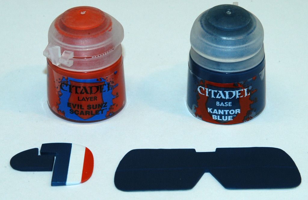

Ah, sometimes I am a klutz! One thing I forgot to mention deals with the Citadel colours I'm using for the red and blue. These the Citadel Games Workshop offerings. They are quite a good match for the decals, but very thick. I simply put a small dollop into a pallet and thinned the paint with acrylic thinners until it “looked right, flowed right and tasted right!” They airbrush well when thinned properly. Also, the new names for the colours are: red – “Evil Sunz Scarlet;” and blue – "Kantor Blue.” Both are spelled as shown. The old names for these colours are "Blood Red" and "Regal Blue."  :)

Of course, before choosing my subject, I had already applied my PC10 mix to, among other items, the rudder (forward), the vertical stab and the upper surface of the horizontal stab/elevator assembly. So nothing for it but to strip off the PC10 where required and apply the roundel blue:
I've taken the opportunity to show the Citadel paints being used in case some forumites have not seen them. As noted elsewhere, they are pretty thick, but they thin nicely with acrylic thinner and spray well. I don't know where they get these names, but the colour is pretty good!  ;D
Best regards to all, and have a great weekend!  8)

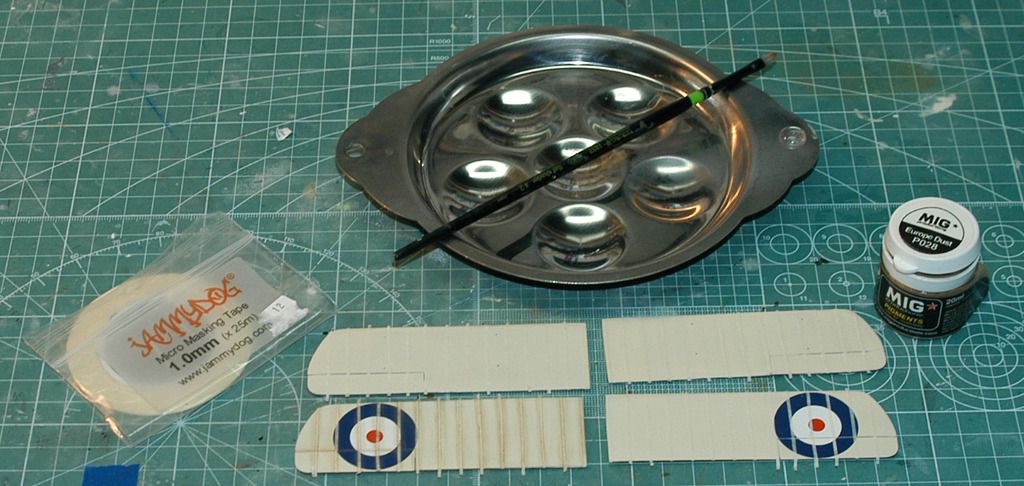

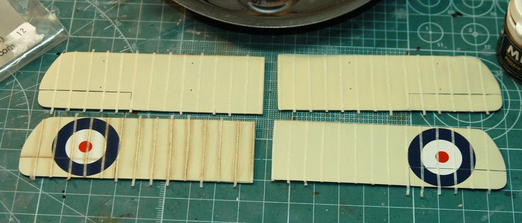

My method for emphasizing rib taping is to tape off the ribs, apply pastels, rub them down and then spray a thin coat of the underside colour to mute the pastels a bit. Having a few minutes to spare, I thought that I'd start the process. Well, one thing led to another and before I knew it I had all of the tapes cut to size. So I decided to tape just one wing section, However, one thing led to another. Next thing I knew, all of the sections were taped. So I thought that I'd pastel one of the wing sections, which is all I did!   ;D
Here is the kit that I use: old, short brush; palette cleverly disguised as a snail tray; Mig pastels ("European Dust" - what else would I use? ;)); Jammy Dog 1mm tape - I can't cut standard-sized tapes to save my life!).
And a closeup of where we stand now. Three more to pastel, then a rubdown, then a thin overcoat of Xtracolor CDL and then a thin coat of Dullcote to matte the surface and fix the pastels.  Then we continue with parts cleanup and other preparations as I await the arrival of Edgar's most welcome gift of PE, for which I thank him again.
As always, questions and comments are very welcome. Thanks for visiting!  8)
Cheers!
