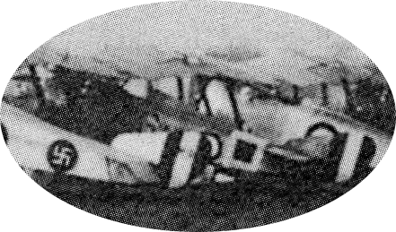

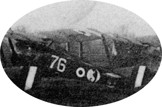

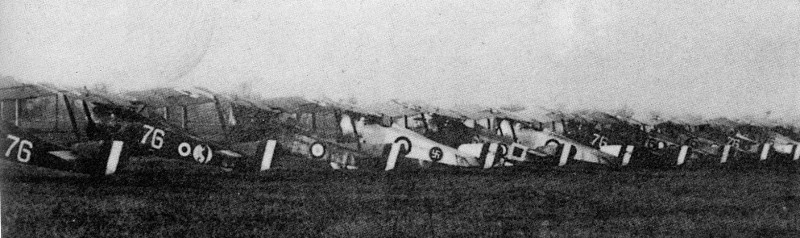

In the same book there is this photo:
taken in spring of 1918 of the full Squadriglia Line up in their last base (Casoni, near Castelfranco Veneto - Treviso)
Where you can see the seahorse plane
but also the Scaroni plane
Painted dark and with the personal marking inverted tones...

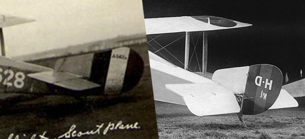

To get some empiric indications about the different size of the HD2 elevators, I cut the tail from the picture linked by ermeio (thanks!) and joined it with an HD1 tail looking for a similar point of view. I had to flip horizontally the picture of the Belgian HD1 to have a suitable perspective:
I think it's enough to make some reasoning about proportions. The HD1/HD2 kit provides also the HD2 fin and rudder as a resin add-on, so I will use it to measure new horizontal plans...

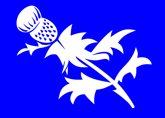

In the meantime here is the thistle I redraw in vectorial format:
This is how it should appear once transferred on the plane
And this is the real vectorial drawing
Of course it's free for everybody to make any use but a commercial one!
(and if anybody's able to print white decals I'll be grateful for life!!!!)
I based my redraw on this photo:
Referenced on this site
http://www.belgian-wings.be/webpages/navigator/Photos/MilltaryPics/Personnel/WWI/Coppens%20Willy/willy_coppens.htm
I'm going to sit back on my bench and start playing with plastic now...
