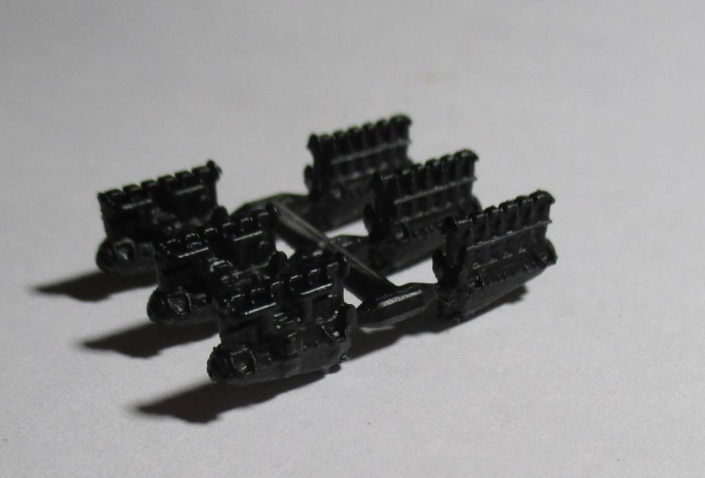

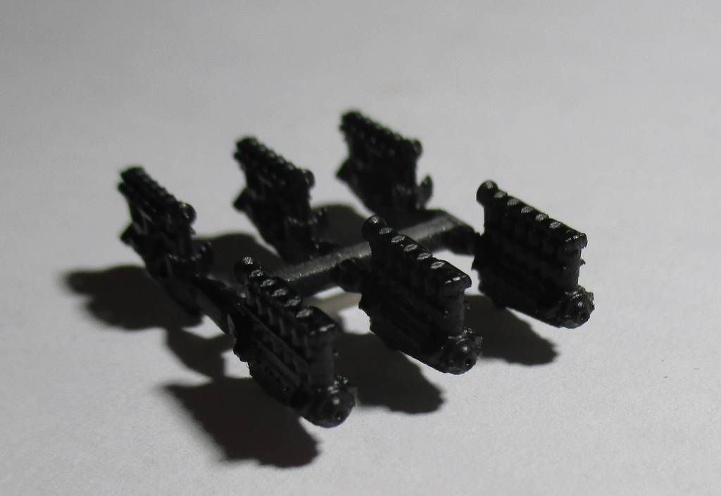

Please let me share the photos of Bo's Mercedes D.IIIa in 1:144, now in black primer which shows much more clearly, how incredible they look. I am really astonished by what Bo has created.
I had no time to get to my workbench at the weekend, so only a very slight progress on the build:

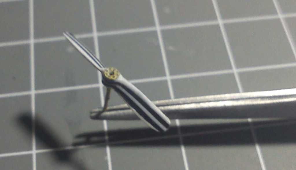

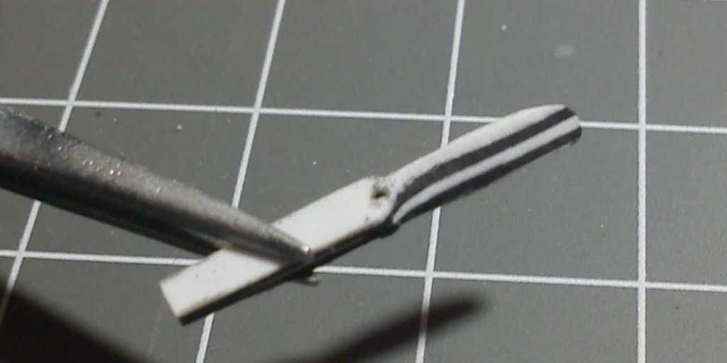

I prepared the sandwich of black and white styrene for the carved propeller:

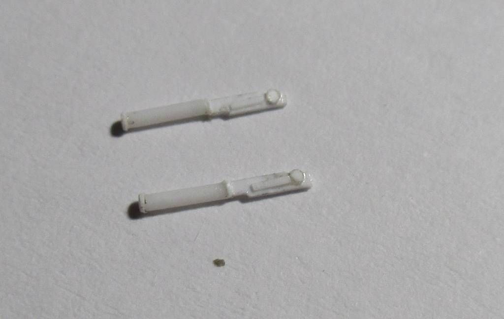

...and made very first steps on the Spandaus:

OK, in my ignorance, I must ask: why a B&W sandwich for the propeller?
Offline ondra
  • Posts: 954
Fair point, Warren, sorry for the missing description.
I always admired the gorgeous carved laminated props on larger scales and was wondering how to achieve a similar result in 1:144. As I am not really good at working with brush, the results of attempts on painted layers of dark wood did not look good.
As I can not use light and dark wood in this small scale, I use thin sheets of white and black plastic welded together in a B&W sandwich, here a few photos of the prop I made for the Hansa-Brandenburg:
This was the first attempt and I had to admit that the particular layers were way too thick, but after using thinner plastic, I was quite satisfied with the result:
Far from perfect, but still better than previous pieces.
Ondra
WarrenD
OK, so you are making the sandwich, carving the prop, and then applying a thin stain or thinned paint?
I ask, because in 1/72nd, I cannot use layers of wood either. (I tried, but I wasn't able to source it.)  I'd like to try this in 1/72nd.
Offline ondra
  • Posts: 954
You are right, I just apply a thin coat of oil paint (it was yellow ochre in case of the H-B D.I) in the same way as creating the wood effect.
I think this method could work well for your scale, should you need any support, just let me know, will be happy to help.
Ondra
