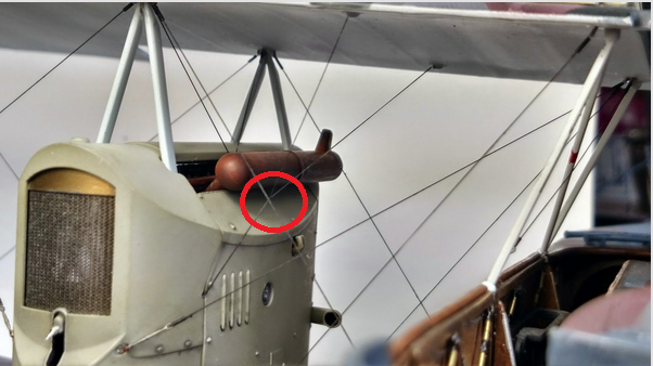

One question:
How you manage to do this wire circled in red? I'm strugling with that at the moment
Think globally, act locally!
Offline zavod44
  • Posts: 336
Re: Gotha G IV WNW 1/32
« Reply #83 on: March 11, 2015, 11:38:52 PM »
I'll try to explain, I don't have any pictures at the moment but I'll go home and take pictures and show you what I did....  As you know this is a very tricky wire to do.  And I tried a bunch of stuff but i didn't have any success.  I tried tying mono filament line and I couldn't get it to work.  I tried tying the fine EZ line.  So when you tie two pieces of line together you end up with a knot in the middle and four lines sticking out in four directions...SO I cut one line off and when I stretched it, it came unraveled and fell apart.  I tried to put a little glue on the know but that deformed the line and it didn't look so good.  So I kept trying to figure it out.  I had a bright idea, what if I held two of the lines together and stretched the other two into the "Y" shape.  Once I stretched it real tight you couldn't tell that two lines were sitting right next to each other.  So that way my knot held tight and I could do what I had to do.  At that point I just glued the two lines to the inside of the engine access door, and then I drilled holes in the top wing and fed it through pulled it tight and staked it with a sharpened piece of plastic rod.  I'll take some pictures because I know it's hard to understand without pictures.....I'll take some tonight......

« Reply #84 on: March 24, 2015, 01:59:20 AM »
Okay I must profusely apologize for these horrible photos, they are horrible.  I had a chance to show a demo of how I did the "Y" shape rigging.....
Here are my two pieces of fine EZ line.....
Tied them in a simple knot
Hold two of the lines together,  these are the two I glued inside of the engine access panel
Voila!  The two in the clamps are the ones I passed through the top wing and staked.  As you can see once the bottom two lines that are held together are pulled so tight you can't tell that they are really two lines side by side, they just appear as one.  If I did it again, I would try to put them through an eyelet and pass them through a tube like I did for all the rest.  That is up to you, but I think this is a pretty easy way to do this "Y" rigging.  Make sure you leave plenty of slack for the two arms.
I got some work done, this weekend.  I should have another update soon.
Sorry for these horrible pictures again.....

Offline Ssasho0
  • Posts: 595
    • Scale Models Club Bulgaria
« Reply #85 on: March 24, 2015, 02:01:56 AM »
Excellent, thank you very much!
