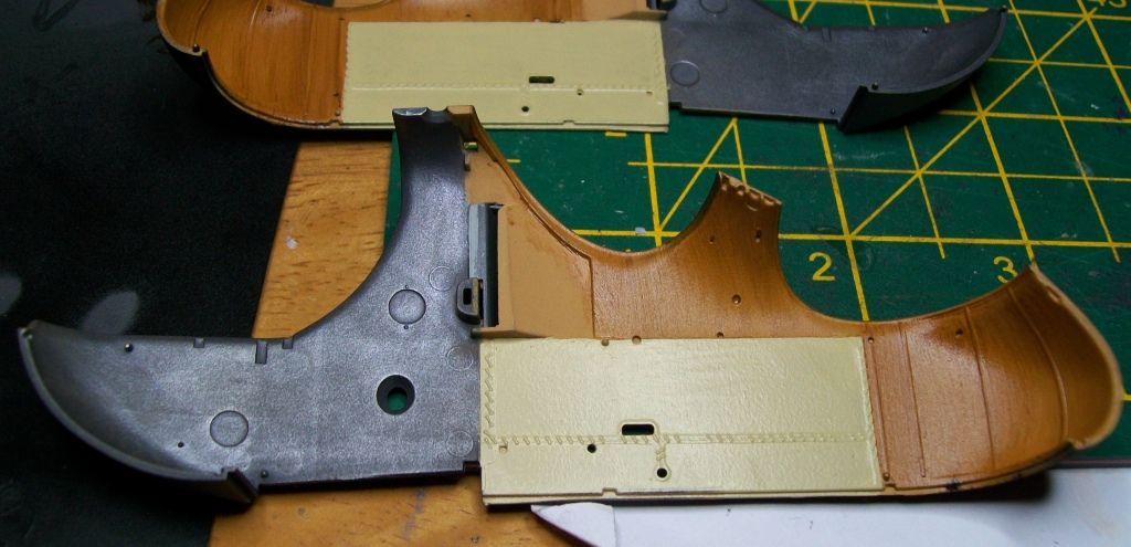

I have seen far better wood graining than this, but it's good enough for me, for what I'm capable of...
Finished the oils for the wood on the other bits, cockpit frames etc, and nascelle interiors.  The stitching will be highlighted before I close up the nascelle.

The interior is just MORE of your excellent technique!! After the base coat do you do one colour of oil then the other or are you working them in simultaneously? Also is it Ochre and Burnt Sienna?

Thanks for the comments - much appreciated.  The WNW recommended technique works well enough for me :)
Currently I use Raw Sienna and Burnt Umber.  I don't mix the colours first, but apply the Raw Sienna first.  Whilst still wet I dot on tiny bits of Burnt Umber and then brush in in the direction of the grain.  This darkens the mix slightly but also gives a few areas of subtle shade changes.  I am thinking about adding a further colour for more depth.  Next time maybe.
The base colour is Humbrol 93 Sand - this is quite golden so I would use a more beige shade as a base for lighter wood,

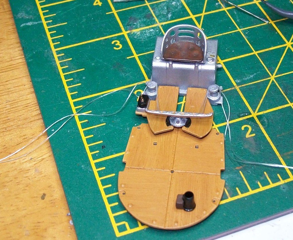

Not much extra tonight - started to assemble the cockpit, but most of the oiled wood bits aren't ready.  Got the rudder bar on and rigged, but still need to add foot straps.  Micro mask will do the trick nicely.
