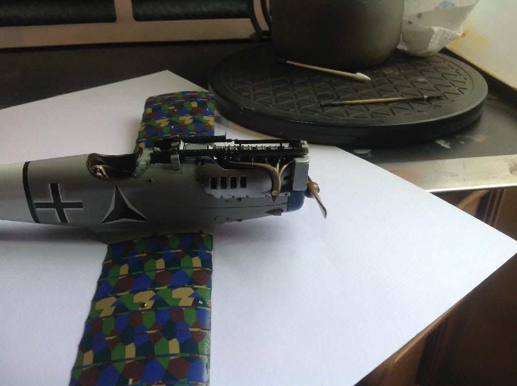

A tip! Some builders have had a gap under the engine. I am fitting the engine after painting and closing the cowls. Don't fit part a33 the chin, until after the engine is seated. The engine pushes the bearers and therefore the nose apart a bit as a bulge on the engine impinges on a slot cut out of the left engine bearer. The engine needs a firm squish down, then fit the chin which now matches the nose contour. The radiator has a hose that then pings into the front cylinder head. Use tape to hold the whole shebang together.
Another tip is to not use  fuselage nose former a52. Mine pinged off and made the fit better, but you can't see it through the chin slots anyway.
I'll post some snaps after I assemble the nose. First I need to paint the fuselage silbergrau.

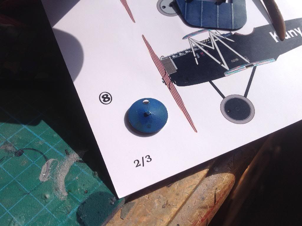

I managed to keep the wheels translucent. The intake lagging is thick mr surfacer. I like it as it looks like asbestos tape.
The prop is better in this light.
