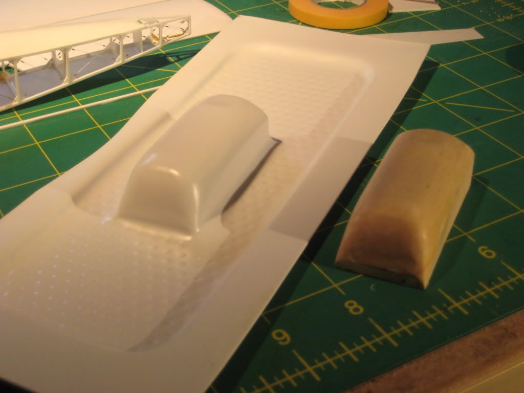

This update is a cautionary tale for the casual scratch builder like me.  Here is the first vac pull.  On a positive note, the master came right out undamaged. :D

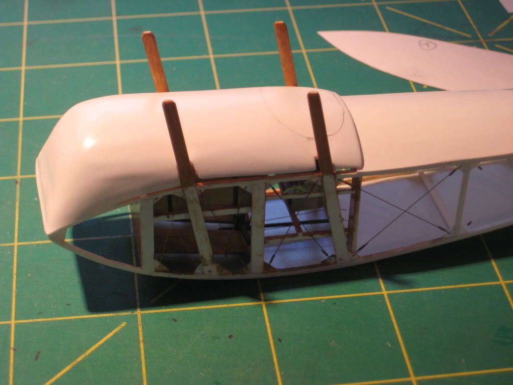

After trimming and sanding the cowling to fit, I found that I was not satisfied with the overall shape and fit, particularly the way the way the rear portion does not lay flat against the turtle deck:

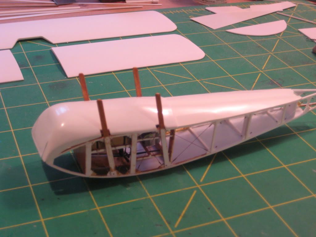

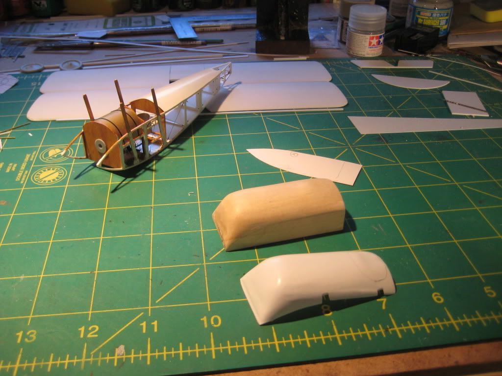

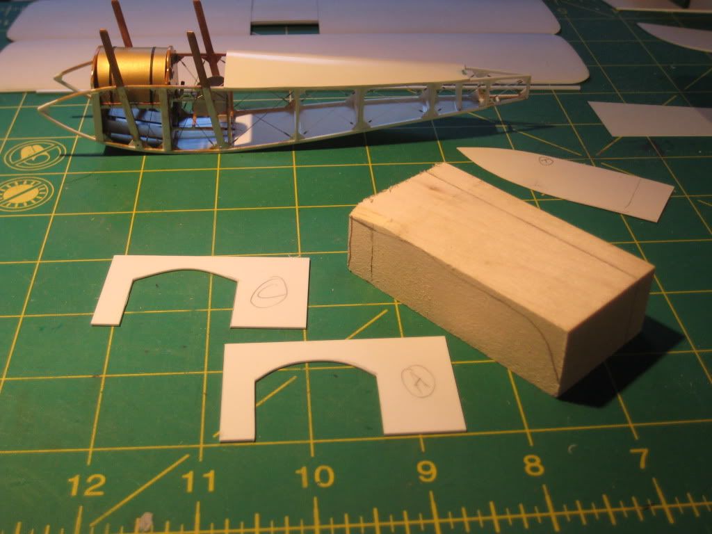

Thanks for the encouragement everyone. :D  Progress has been slow lately for a variety of reasons, but partly because I have been struggling a bit to get the cowling molding right.  This is the new basswood master along with the last pull and the master for the chin cowling:

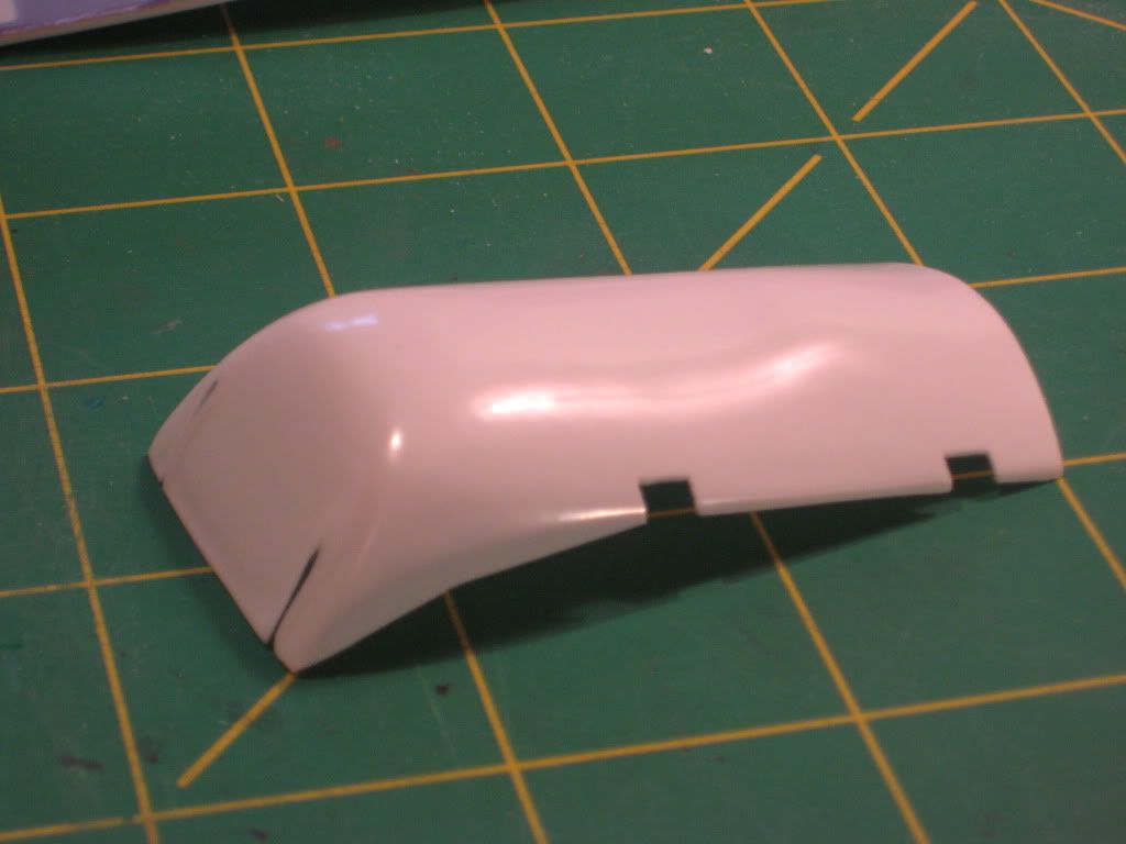

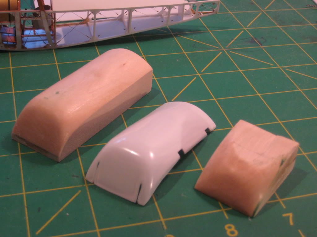

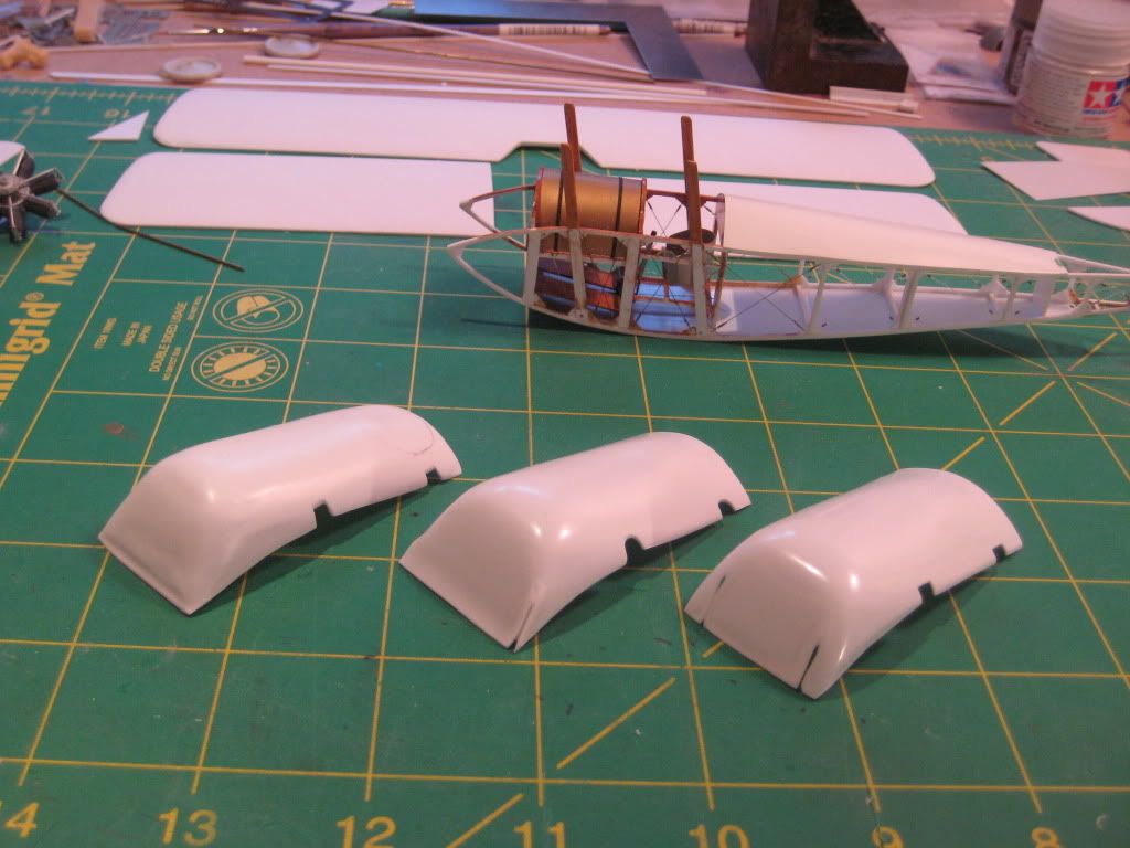

Here is the progression of three pulls; the second and third are from the new master:
The second pull fit better, but after cleaning and trimming I found that it was too wide.  I promptly broke out the sandpaper and narrowed the master accordingly, to produce the last pull:
As you can see, the last two pulls had some webbing at the corners.  This might be because my plastic holder for the vacform is fairly thin and warps a bit when heating, resulting in the hot plastic maybe not drawing down evenly.  I plan to correct this by making a sturdier holder from thicker wood this week, and trying some more pulls.
Here is the latest cowling sample in place.  It's close, but not quite.  I also need to narrow the slots for the cabanes, as the openings are far too wide:
So, the trial and error and tinkering continues.  I'll get there soon! ;)
