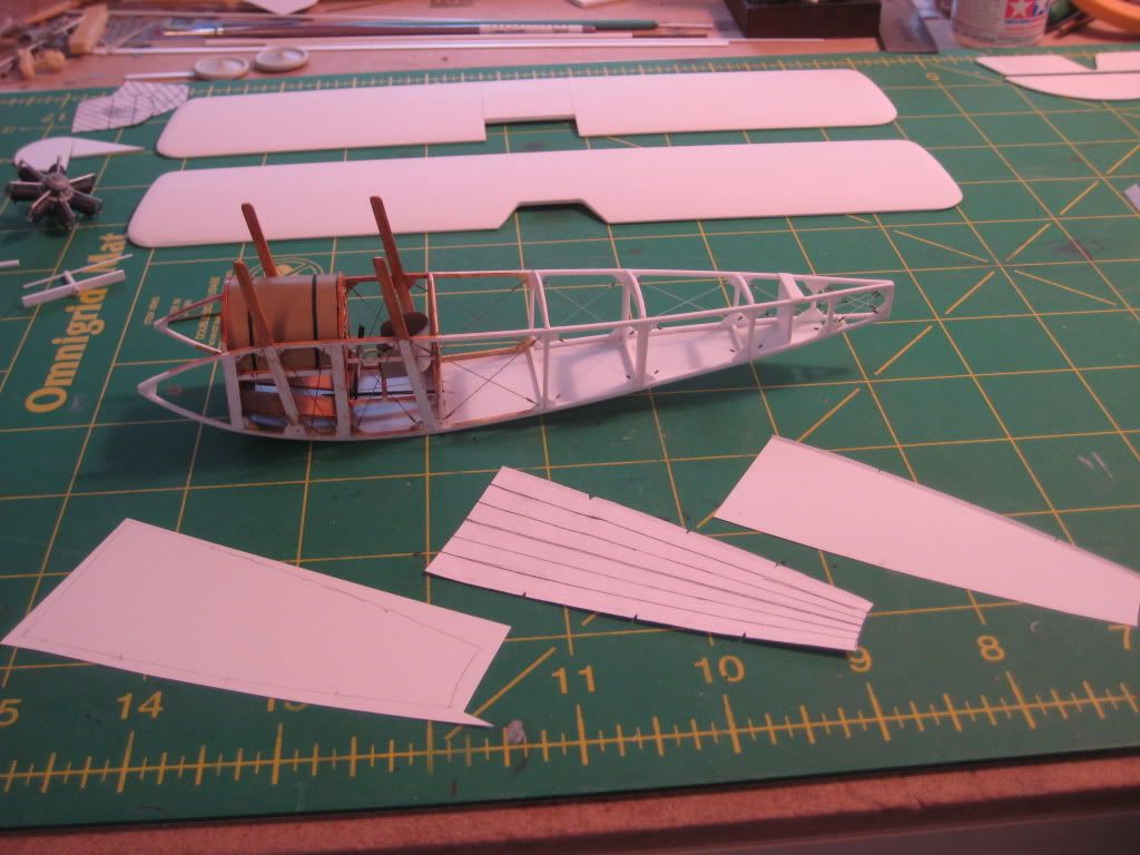

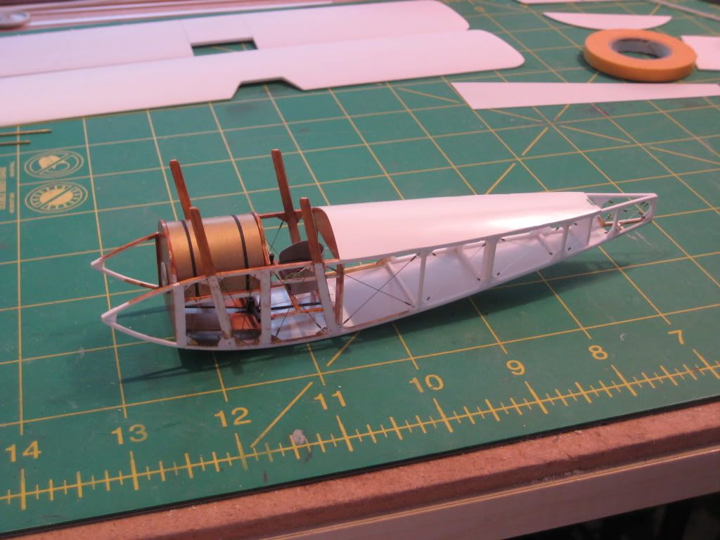

Modest progress this week.  I did manage to get the remainging fuselage framing completed and the bottom of the fuselage covered with ten thou sheet styrene.  From the rear of the cockpit forward the covering is a metal panel, and I painted the inside with Mr. Metal Aluminum.  I'll do the exterior later.
The turtledeck area is a declining convex surface which narrows on a a curve toward the tail.  I think I will need to use five thou sheet styrene for this (essentially paper thin) to get the curve right and have the sides sit properly.  Because of the compound curves, I am making a paper template pattern to ensure that the top covering will fit well.  Does anyone have a better idea for this?
I have decided to first try to fabricate the metal cowling panels from sheet styrene and vacuforming.  I will need to carve the pattern for the top and bottom cowling pattern from wood for the vacuforming.  Maybe by next weekend. :)

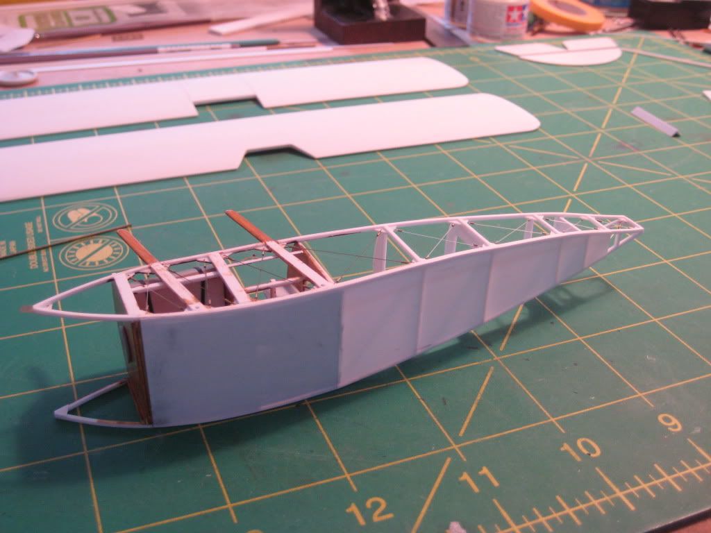

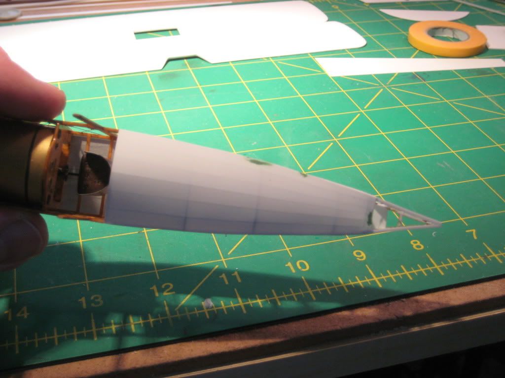

Here's the weekly update.  I managed to get the turtle deck covered with 10 thou plastic card.  I have also fabricated the tail skid, but will add it to the fuselage after painting.  I have laid out the fabric portion of the fuselage sides on sheet plastic, and will add those soon.
I used a pencil and French curve/straight edge to emboss the ribs on the reverse side of the turtle deck covering.  You can see it a little here:

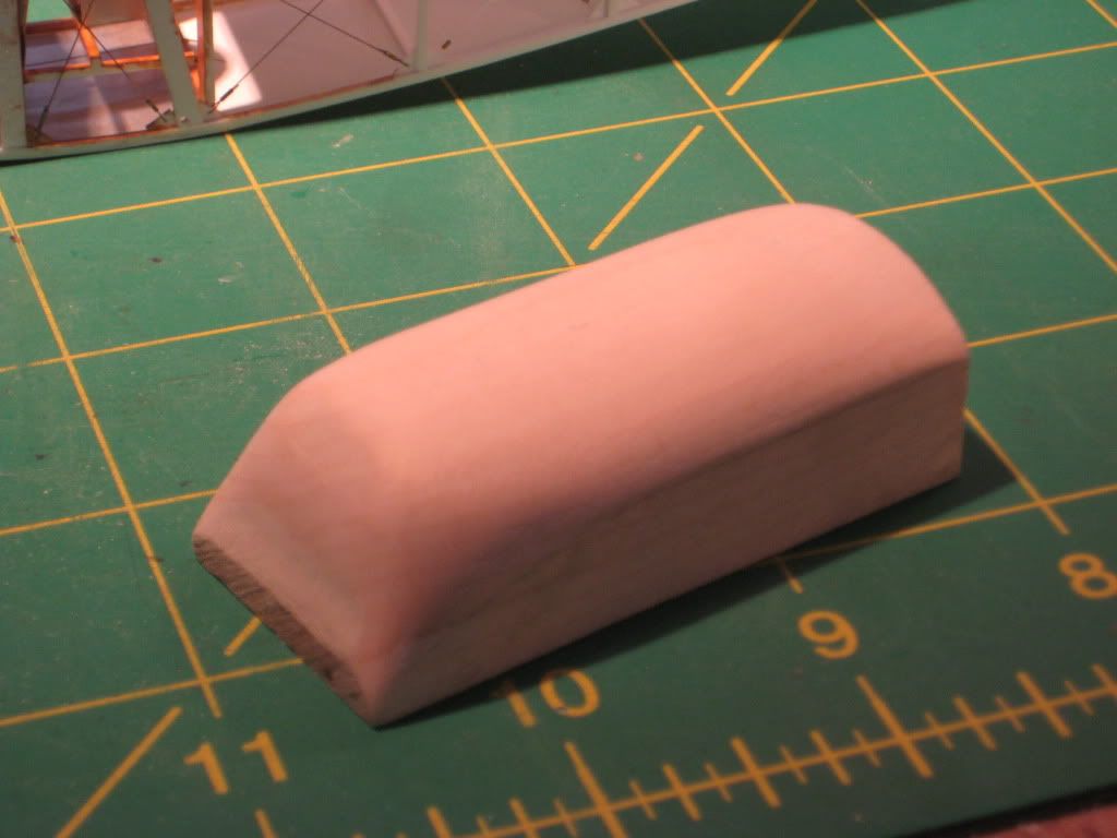

It's now time to fabricate the metal upper and lower cowling.  Here is the basswood vac master for the upper cowling:
I'll fire up the vac box/vacuum cleaner in the next few days and try a couple of pulls.  I still need to carve the lower cowling, which is much smaller.  That's all for now.

« Reply #89 on: April 15, 2014, 03:15:23 AM »
