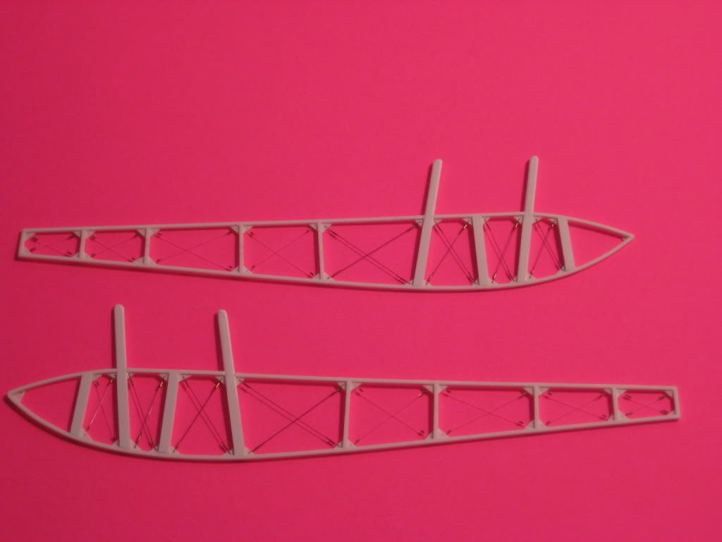

There is some additional progress this week.  I finished rigging the fuselage frames, which took a bit of time:
I did this rigging more for strength than appearance, since most of it will be invisible under the fuselage covering.  For the areas visible through the cockpit opening I used the steel colored monofilament from Steve Robson, which worked very well.

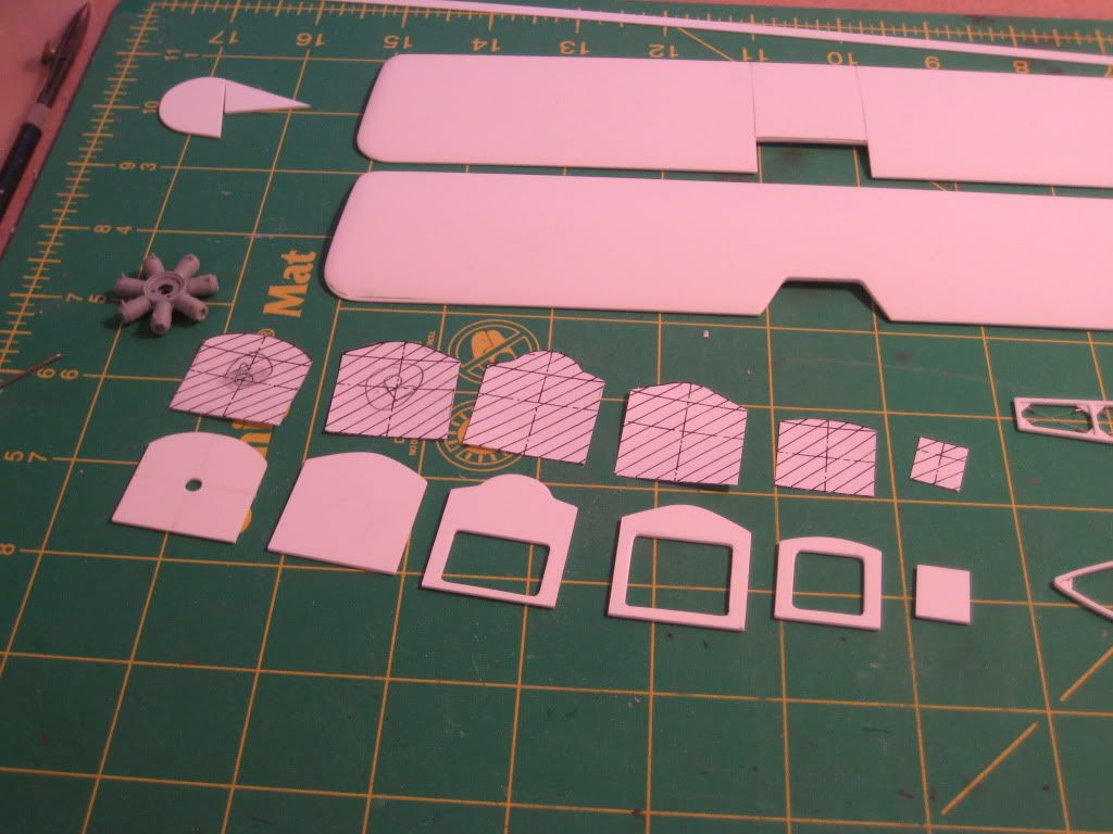

I have also cut out fuselage cross-frames from templates provided in the drawings, reducing the width by the width of the side frames.  These include an engine firewall, instrument panel, cockpit backrest and a couple of others.  They are not entirely prototypical, but I am using them for additional strength and rigidity in the fuselage over scale framing cross-braces, and because they will largely not be visible.  Here they are:
Within the next few days I hope to have the fuselage frame fully assembled.  The cockpit, fuel tank and engine will follow.  I am using the WNW 80 hp Gnome 7-cylinder kit for the engine.  Most of it will be invisible under the cowling.

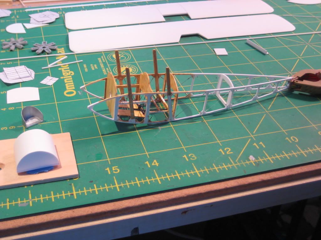

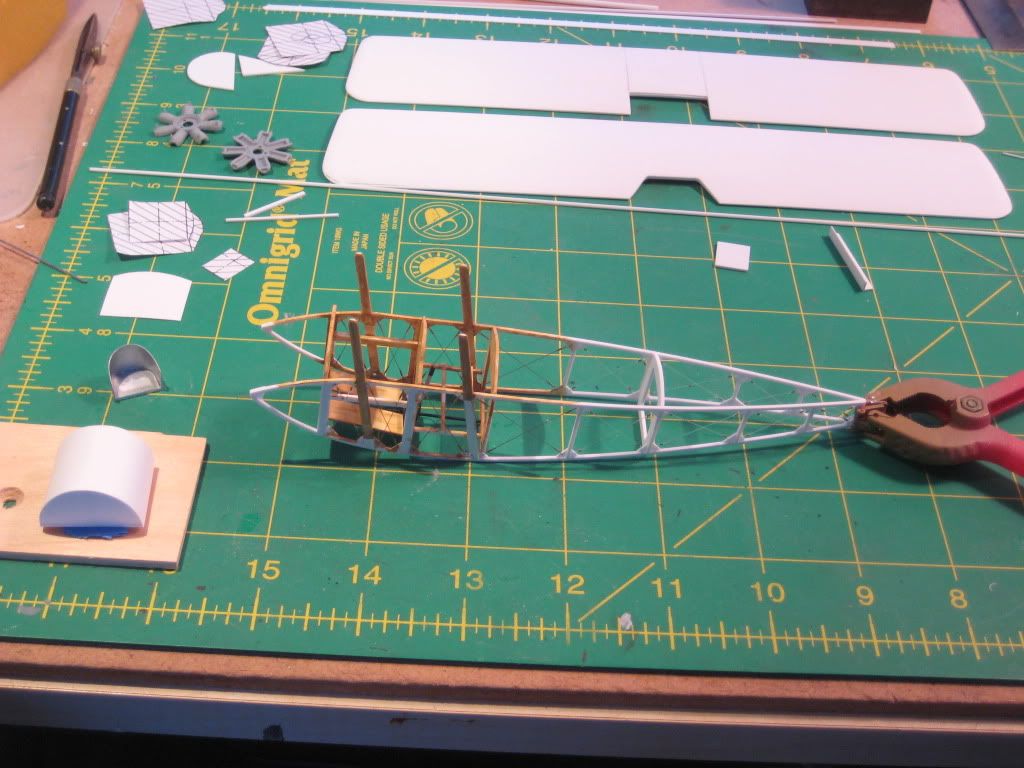

Time for a mini-update.  Fuselage assembly has begun, with some of the cockpit detail added, and the base coat for the wood applied and glossed before oils will be applied.  The bulkheads are glued in place back to the cockpit headrest, with the mid-fuselage bulkhead just fitted in position and the rear clamped together.  I'll glue those and add other cross-members after I have added the final bits to the cockpit.  Here she is tonight:
Starting to look a bit like a Tabloid now! ;D  I'll add some closeups once the fuselage detail is added.  You can see the unpainted fuel tank and the cushionless seat off to the side.  I'll paint the tank and add a seat cushion tomorrow.  Once the wood oils are dry, I will complete the cockpit.  In the meantime, I'll go ahead and do the engine.
