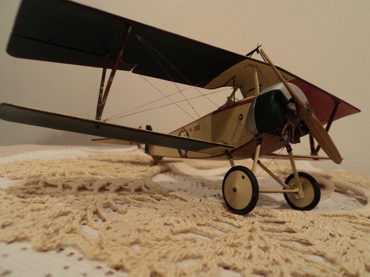

And the completed model
I used Humbrol #55 for the overall color, the rest were Tamiya Red and Green.  I used Testors MM silver for the cowling.  For the Vickers gun I used a spare WNW with the stock cut off and replaced it with the handle.\\Bob's Buckles were used for rigging attachment points and the rigging is a combination of EZ line and "invisible thread".  I used a brown artist felt tip pen for the edging and Tamiya Linoleum brown for painting the brown on the seams.  I wouldn't recommend this kit for a beginner, but an experienced modeler would find it rather straightforward.  I had to pin the Rudder and the V struts.  For attaching the lower wing I drilled holes in the wings and then inserted a brass tube through the fuselage and attached the other wing to it.  Worked real good.  I have another one, the Nie 16 in Albert Ball's marking that I may tackle at some point.  Now that I have this under my belt, I know what to look forward to.

Love the aeroplane Mark, but you could have perched her on a better base...
now my wife wants all of mine on doilies too. ;) ;D
