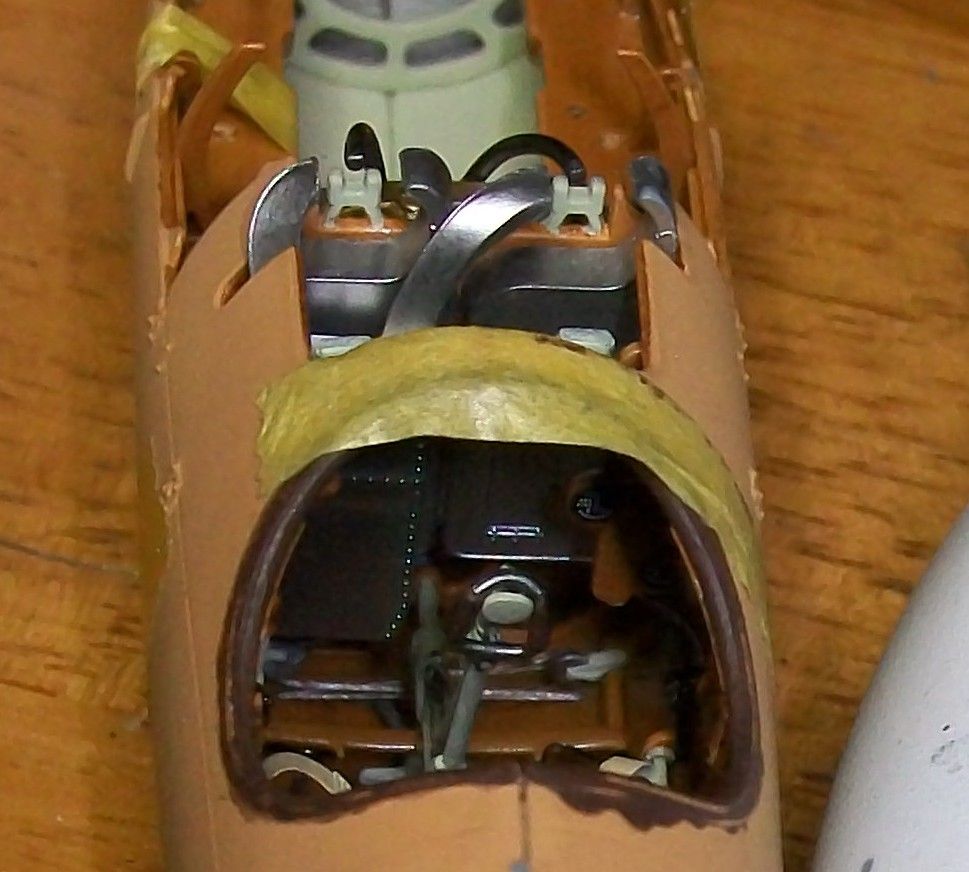

Des, looking at the pic now, it would have been better I think to have some more variety in wood tones.  There is a variation with the little shelf that sits under the instrument/switch panel but this was after the original part was lost and I used a bit of plasticard as a replacement, painted later and separately.
Bo, you are correct.  Looking at the model there is clearly no issue with zipping it up now.  I have the engine bay formers and bearers painted and ready to put together, so that will be a quick job to include these parts.
I may cut out one of the guns to check the fit in the ammo chutes and supports etc before zipping up, to see if I need to remove paint from the joins rather than later on.
As advised above, I may add some short lengths of brass tube into the drainage holes underneath, and also check the wing root fitting so that I can do any internal filing necessary before glueing the halves together.

Your interior is looking excellent! If you are closing your engine covers I have found that it reduces the need to mask the engine if you test fit, then paint them before assembly. I am looking forward to your solution of the Aileron controls as this is one Issue I have contemplated on since the kit was issued  ???

Rick, I will definitely paint the cowlings separately.  As for the aileron controls, they are partially done although difficult to see on that pic.  The port side pulley is currently hanging loose, attached to one rigging line which passes through the tiny hole I drilled in the starboard side wing root.  Through this hole also passes the link cable between both fuselage halves.  These lines are taped to the outside of the fuselage for safekeeping.  I need to carefully attach the cable that runs from the top of each pulley to the lever on the bottom of the control column assembly. Then as the halves go together I will attach the port side pulley using the stretch of the cable to allow this.  Then I will pull through the slack through the wing root holes, glue and trim.  Fiddly and will hardly be seen once complete, but as they say on a certain UK quiz show, I've started so I'll finish!

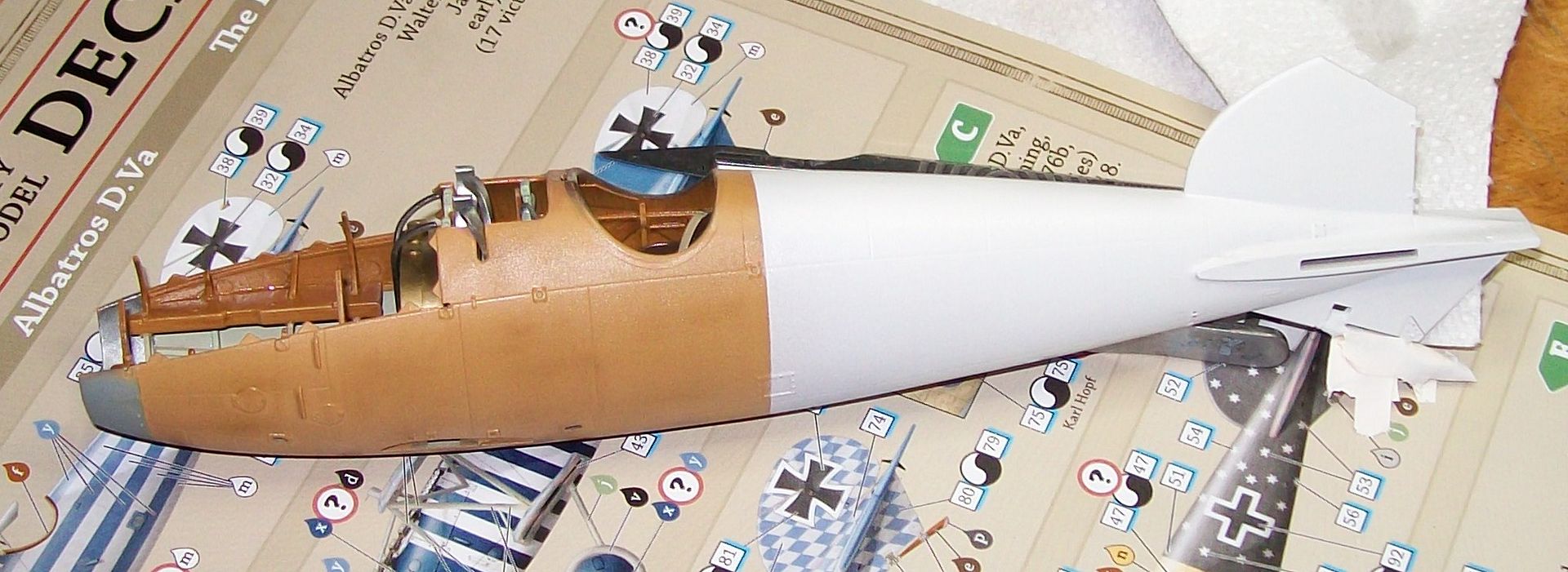

Tonight I put the fuselage halves together, having just about managed to rig up the aileron control lines.  They are just about visible here.  The fuselage goes together OK, but I will tidy up the join.  Next up will be to smarten up the cockpit padding and paint the fuselage ahead of the woodgrain decals.

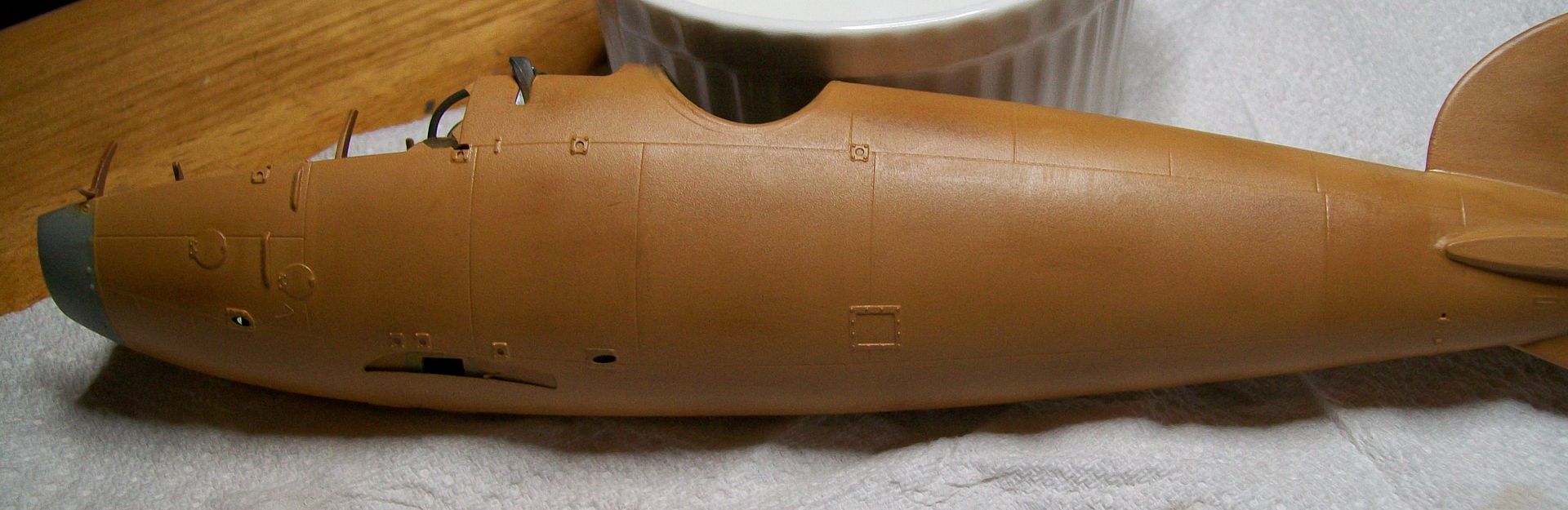

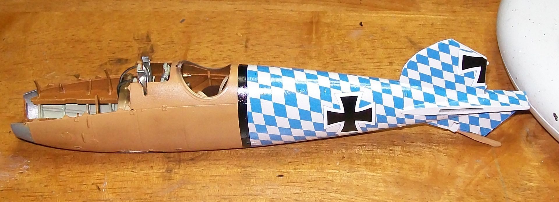

I started on the fuselage exterior, sprayed a sand base coat, and added some drybrushed pastel powders for colour variation.  After a klear coat, I tried to apply the HGW woodgrain decal.  It just didn't work for me, and I think oil paint woodgrain will be better for me.  Also I didn't realise the Bavarian diamond pattern decal was blue/clear rather than blue/off white, so I had to undercoat the rear half in white, then apply more klear before decalling.  The decals are not quite a perfect fit.  Whether this is because the decals themselves are not quite right, or I haven't applied them perfectly, or a bit of both, I just don't know.  From a distance they look OK, just don't get the magnifier out!  The decals will get dulled down eventually as I think the finish is too glossy just now, even without the camera flash.

My next job is to do the woodgrain oils on the fuselage and mix the Bavarian blue paint for the tailplanes/elevators/wheel trims etc.  I was quite surprised that the decal set has the white stripe decals to overlay on the blue horizontal tail surfaces - which would be otherwise straightforward to mask and paint - yet does not have a decal for the C shaped complex curve cowling at the front of the aircraft.  I can see a use for Bob's masking strips there...

You are correct - from a distance those diamonds really look fine.
