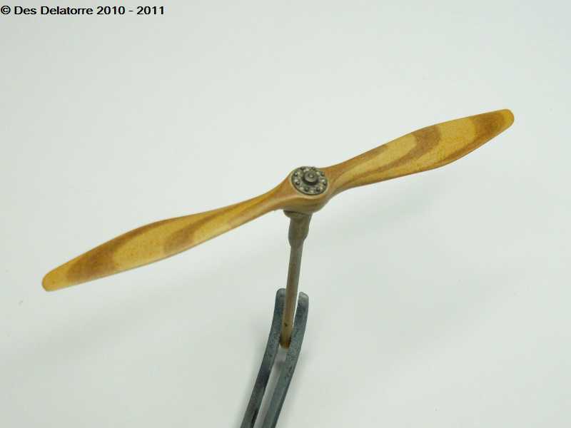

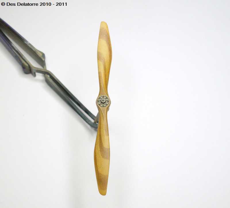

Here are two photos of my first attempt at doing a laminated propeller. I firstly sprayed a base coat of Gunze acrylic then like what Chris has said, I used a coloured pencil to apply the lamination, I finished off with two coats of Humbrol clear. Next time I will use a better quality colour pencil.

Hmmm. Used pencils for weathering, chipping etc but not to this extent. Looks good.
