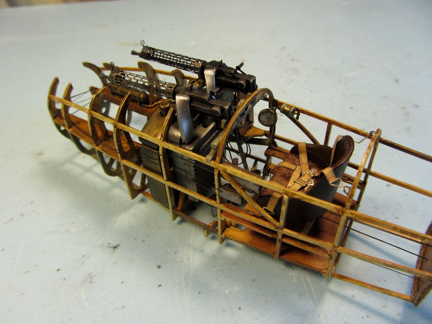

first of all, I fixed the mistake about the spandau chutes:
4612

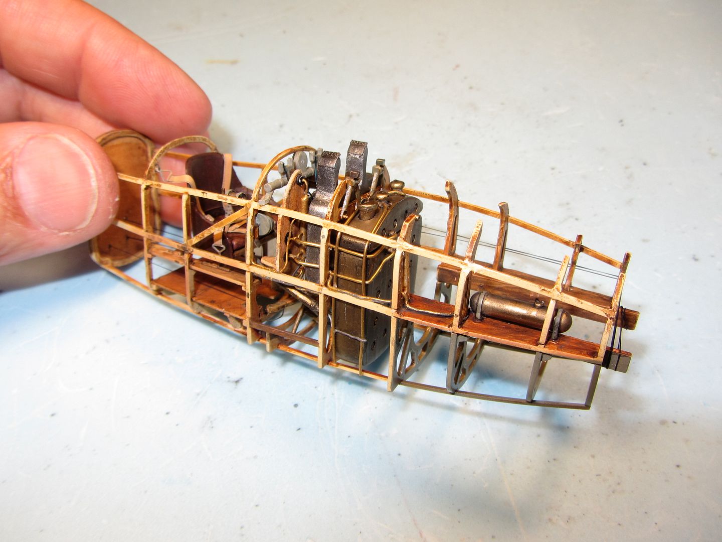

then made some plumbing,
4613
and started the pulleys for the controls.
4614

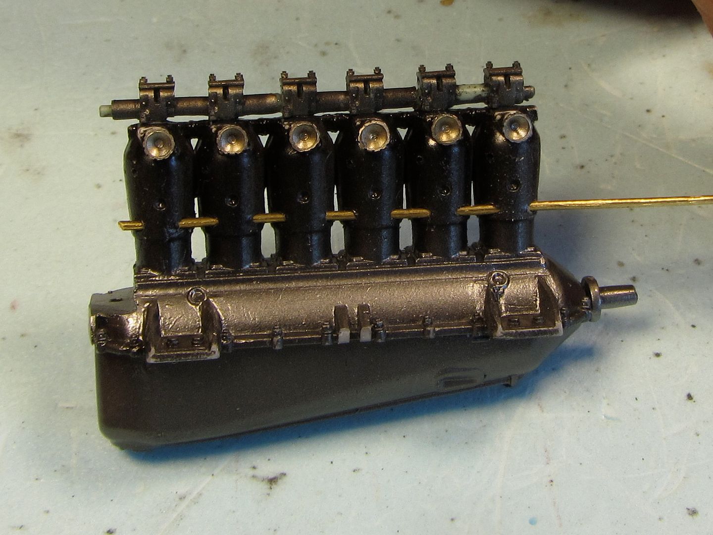

beginning also to use some taurus items...
4627
I love them!
4625

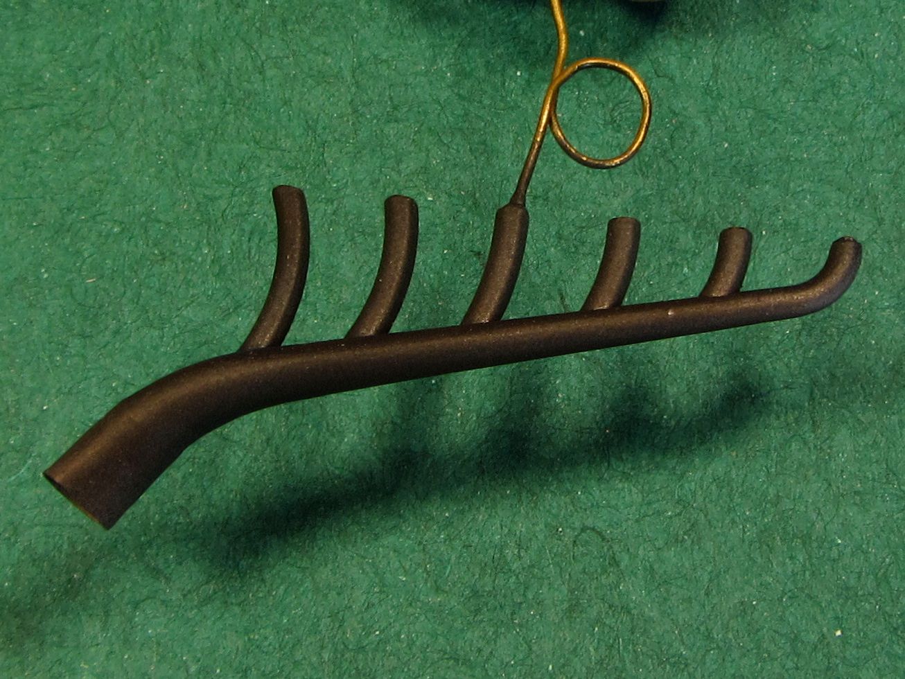

having the colors in the cup, I tried some on the muffler...

Paolo, what was wrong with the ammo chutes? Please remember that Voss had in his Albatros additional cooling slots on the front of the Hood!

Paole, the Exhaust-side is the wrong side for that Taurus parts!!!!
You need flanges on the Exhaust-side...............I hope it's not to late to change.................
Servus
Bertl
Re: 1/32 albatros D:III roden
« Reply #88 on: June 15, 2013, 09:03:10 PM »
Oops, yes Bertl is right; the castellated nuts go on the intake manifold... I missed that.  :o
I have a spare Roden D.III block if you need to start over.

oh good lord.
Sometimes I look in amazement at my opposable thumb, and I wonder when ever fell from the tree... :-\
thanks for reporting, bertl!
bo, thank you very much, always very kind. I'll try to save this, or otherwise I will make a copy of a resin wnw.
well, I just have to try to remedy even this ... ok, modelling is suffering, but I'm exaggerating here!
by the way, I received an answer about the reference books: we are waiting for warehouse supply .... sigh.
At this point I have a question: the inlet manifold should be made "smooth" according to the voss's plane, or can be "blindfolded"?
soren, the problem was not in the piece, but in the instructions: the only way to understand the direction of the shells container (42A, depicted by B side) it's note the tooth visible on the far right of the drawing ... thing that I have not done, obviously.
4631
took note of the front air intakes, I'm by experimenting to reproduce them.
