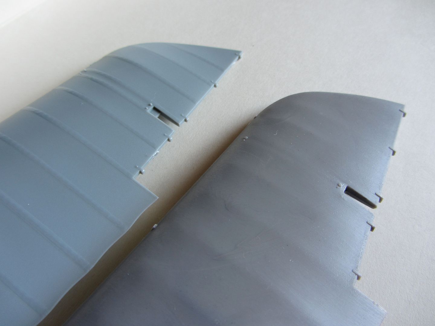

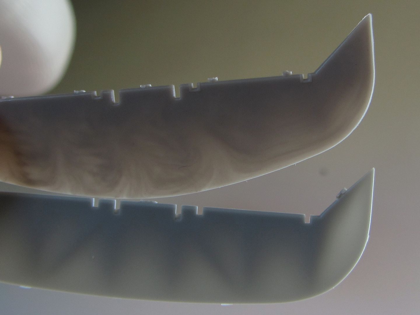

let's explain. wing(s) rendering:
3177
the roden one is... naked!! since the upper wing is identical between D.III and D.V, one solution can be buy a sprue from WNW, but the lower wing is different, so will be evident the big difference between them.
mmmmhh... and if I glue some thin plasticard stripes on the roden wings?

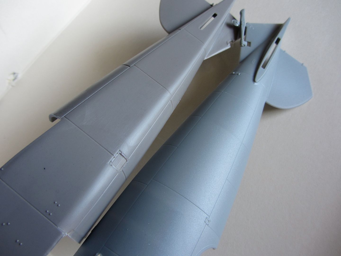

another critical area is the fuselage: the panel lines are really wide. fill, sand, rescribe? panelling on? just forget it?
3179
also the control surface are poor... but here I hope to solve with a little carving and sanding. something like the stressed surface technique used on riveted planes.

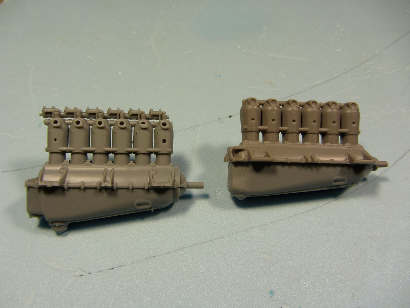

same for the engine. basically the roden is correct, but the details are not so crispy like the WNW. here the only solution can be to have a brand new engine, or close the eyes and do the best with this one.
3183
3184
well, that's all, for today. next session I begin to assemble the engine, just to see how looks put together.

Re: 1/32 albatros D:III roden
« Reply #1 on: May 15, 2013, 02:38:11 AM »
Hi Paolo--
I'm planning on building the Voss D.III as well, in her Jasta Boelcke incarnation (2 hearts).
I haven't finished all my research, but I believe the machine was a Johannistal D.III, not OAW...  (square tail).
Will watch your build with interest...
cheers
--Bo
EDIT: Oops, I see you have noticed that it should be Johannistal (square rudder)   :)

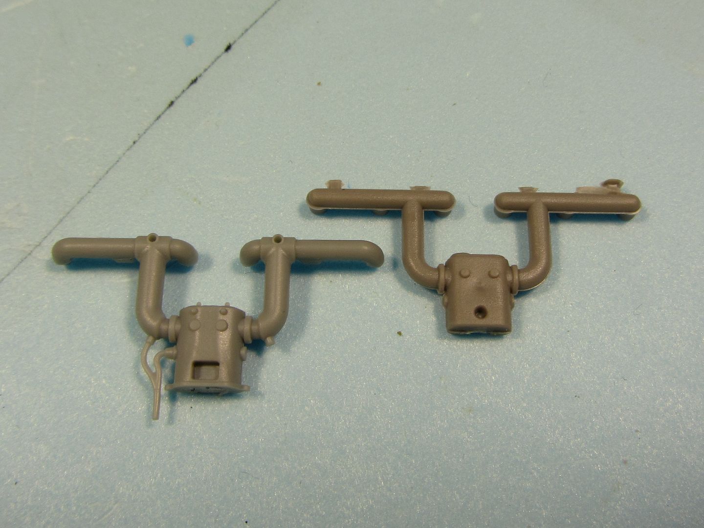

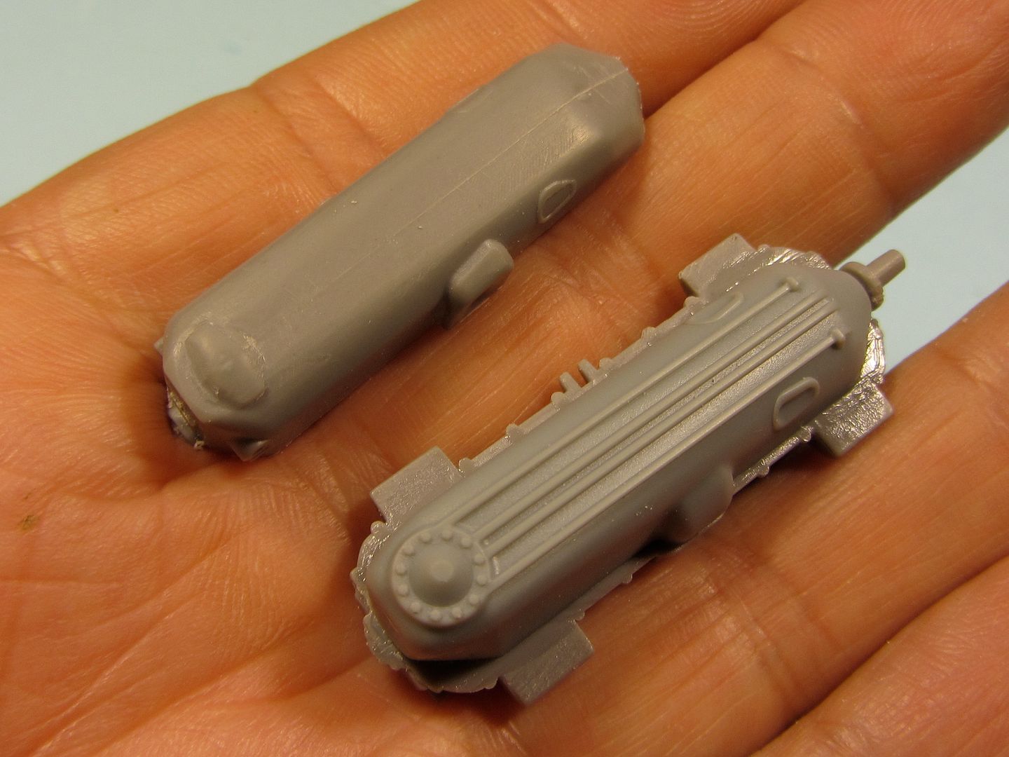

just started the engine.... sigh! the good news are that having the WNW D.V, I can (and do!) cannibalize some extras from the so much better sprue!
I cut away the roden crankcase, and added the spare one from WNW.
3185
phew.
3188

wanna talk about the inlet manifold? ;)
3187
