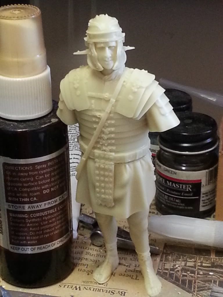

Ok. Again, this is what I have had success with. For starters, my subject is a 120mm Verlinden resin Roman Legionaire and I will be using enamels. No particular reason for enamels, except it's what I'm most comfortable with. As I mentioned in an earlier post, even though he's not quite the era, the techniques I apply are the same regardless. I start by painting everything in it's base color, then seal it. Gloss or dull coat. Doesn't matter really.This way all my initial detail work is done and when I blend colors, it won't have an effect on them.
You may notice two things. He's very pale right now and "unarmed" ::)
One of the last things I'll do is attach his arms, so he'll remain unarmed.

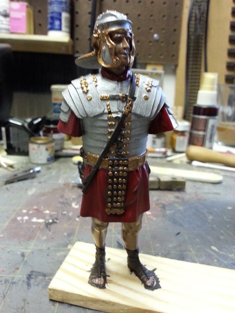

Now here is the same guy with the base colors applied.
This is as far as I'd gotten, when my heart decided to act up on me.

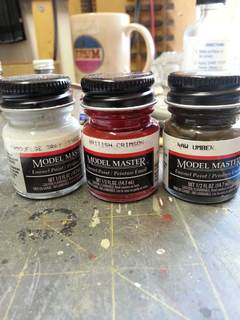

These three guys will be my partners in crime. A word here about blending/mixing colors. I have found that you should almost always stay away from white and black to enhance a base color. Primarily because they will alter your base color drastically. Red almost always ends up looking purple, when you add black, and pink when you add white. The goal is to highlight and shadow. I find that Raw Umber creates a perfect shade medium, while light Camo Gray works fantastic as a lightening medium.
The next trick is probably the simplest, yet hardest to get right. It's all very dependent on your personal opinion. The goal is to create shadow and highlight illusion, so start with your base color and mix in the raw umber, one drop at a time until you achieve the shade you're looking for. The highlight is done the exact same way. Drop by drop until you're satisfied. Sorry there's nothing more mysterious than that. No magic potions, no special incantations, no justice at the hands of Sir Bedivere and his Larger Scales. (of course, logically, if she weighs as much as a duck....)
Pretty simple, huh? The actual trick is in the application and blending. What I tend to do is look at the folds of the cloth already molded, then see where the natural overhead light casts a shadow. Now you take the thinnest brush you can, and apply "stripes" in a verticle motion. Most tunics, kilts, etc... have a natural pleat to them as they fall, which is where you want to concentrate your stripe. For example:
Notice the subtle, albeit rough, difference between the base and shadow. Notice how it follows the contours of the fabric. Like terrain features, think in terms of peaks and valleys. Sun is brightest on ridges and darkest in valleys.
Lastly, for today anyhow, I wait for my shadow to be dry before I apply highlight. Trust me, it doesn't take long. Usually by the time I've mixed my highlight to my liking, it's dry enough. Notice where I apply the highlight. Again, ridges and valleys.
That's it for now. The next step is the most annoying, frustrating, easily screwed up, yet rewarding step. The blending. This requires a decent, stiff yet supple brush, clean thinnner, patience, and most importantly, the acceptance that you may screw it up, have to wait a few days to let everything cure, and try again. Now you see why I say to seal your base coat. I'm not bashful or proud, so if I screw it up, I'll post that as well. Might as well, considering it's the best way to learn.
