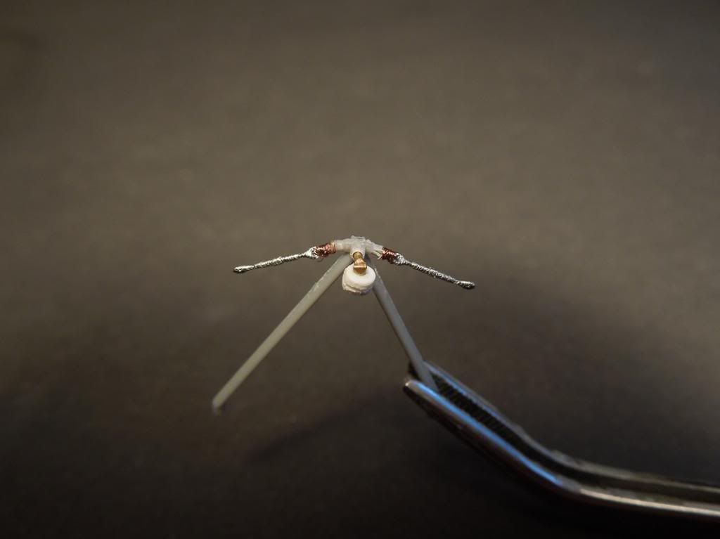

Hi folks,
here is an update on the cabane struts. I cut off the kit turnbuckles and replaced them with the Gaspatch Type A buckles. I drilled 0.4 mm holes into the cabane struts. The turnbuckleshave been fixed with CA. 0.05 copper wire was warped around the junction between the buckles and the struts to minimize the difference between the struts and the turnbuckles diameter.
The control cable pulley is scratchbuilt by using bent 0.5 mmm Albion Alloy tube and two discs made of evergreen sheets. The junction between the discs will bear the cables.
Cheers, Dirk
