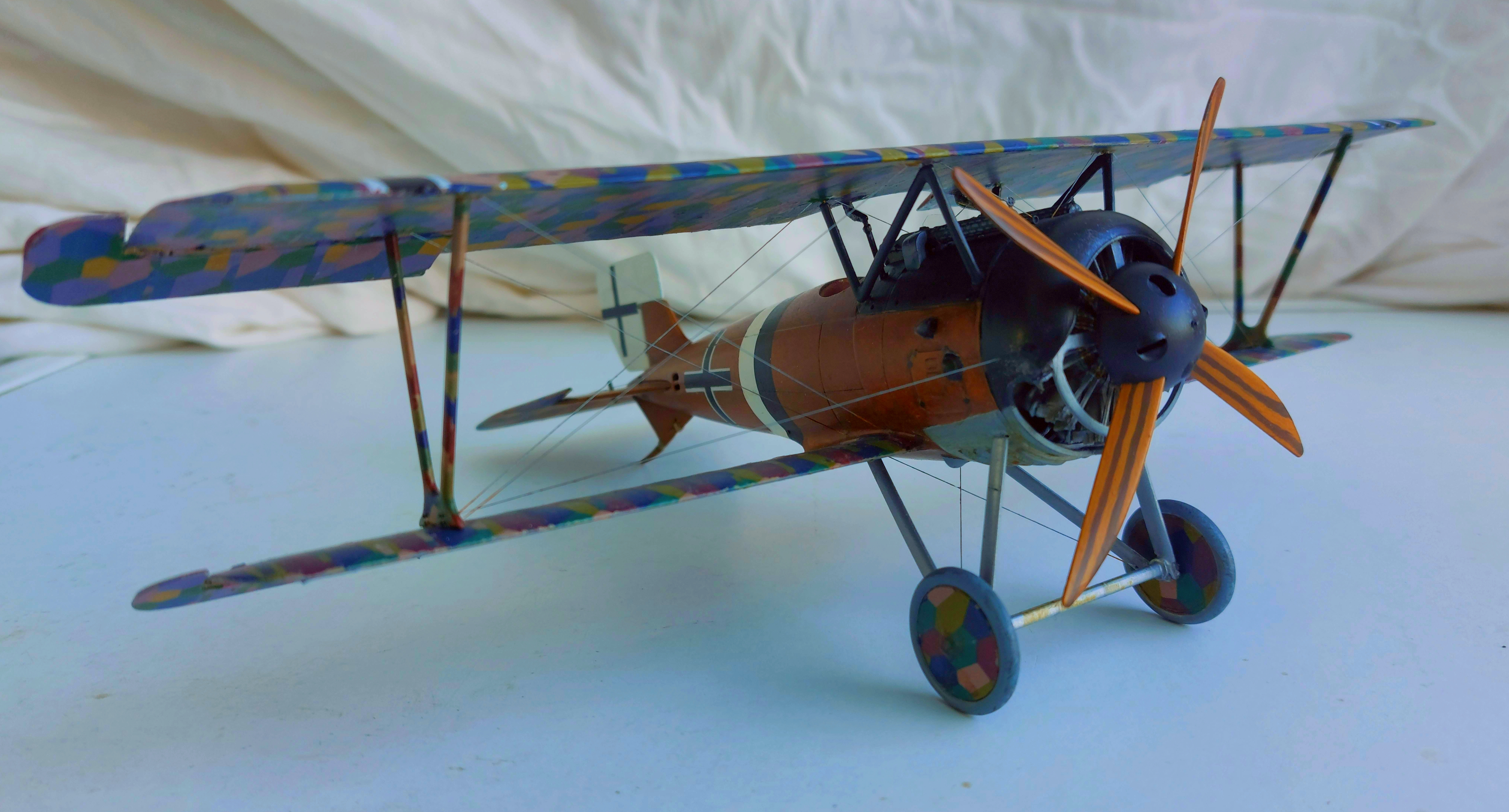

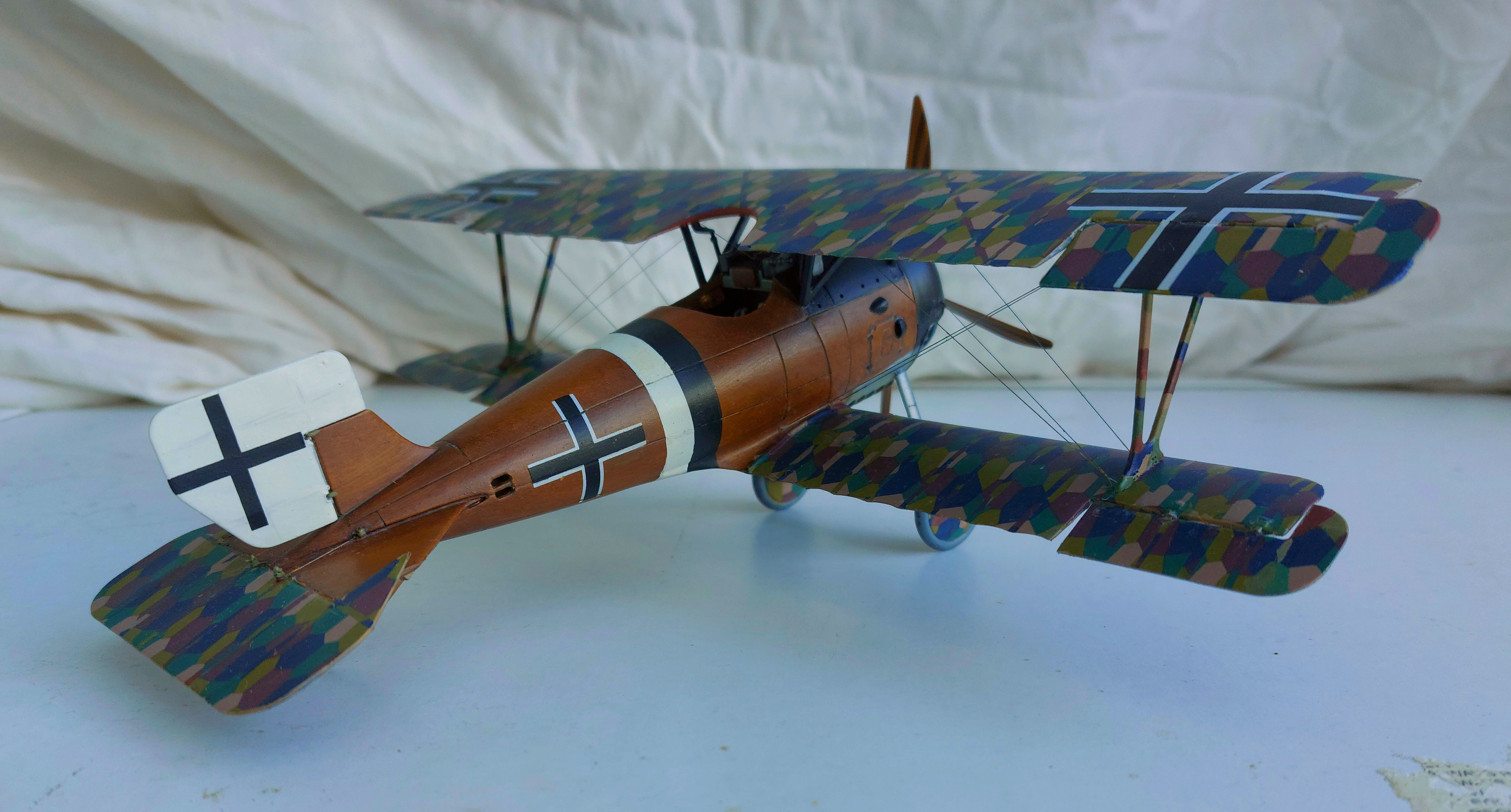

Dear all,
Showing my completed Roden SSW DIII model.
Mostly built OOB with details to cockpit,  MG's (minor); opened up all molded hand holds, footstep and underside louvres; brass pinned all struts, landing gear, axle, tailskid and all control surfaces for added strength.
Brush painted as always and rigged using 0.11 mm fishing line.   Painted the interplane struts which was far more simpler than trying to apply decals to these items.
Completed to represent aircraft of Paul Leim, Kampfeinsitzer Staffel 4B, Freiburg, Germany, September 1918.

A pleasure to see this on built Dave. Wonderful work you did with it. I recently built this same kit and had a lot of fit issues between the engine cowling, panels, and the fuselage. How was your experience?

Tim - yes, there are some areas of tricky fit on this kit - pretty normal for a Roden kit to be honest ......
I tackle the area you referred too by lots of careful test fitting; once I had the setup I wanted I used shims (cut sections of plastic card) to fill the large gaps and (once set) by trimming, filing and filing.  Also, using pins for all the struts really helped to improve the overall fit of the upper wing and undercarriage.

Beautiful result all the way around Dave. And all brush painted to boot. I recall the lozenge is out of the box. Fabulous looking.

For the photos, I played a little with two of them. I trimmed them to show more of the model and changed the contrast, brightness and saturation trying to improve the results of a poor lighting you used when taking them. (to this end I use a free program IrfanView - very much recommended). My piece of advice - use a lamp to lighten the model side to be visible in the photo, especially when shooting against a bright whitish background.

Warren - thanks, mate.  Yes, these are the lozenge decals from the kit.  These lozenge decals if you use a bit of care work really well.   I've also noticed that on Roden's latest kits that their decals have improved generally.
Prez - your a kind star! - thank you.   Photography was never my strong point and I took these using my phone so should have used flash when taking them.
