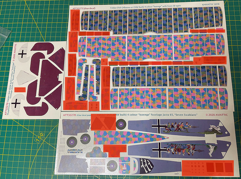

The aircraft has two distinct scenes painted on each side of the fuselage.
On the left (port) side of the fuselage shows the Swabians seeing the hare.
On the right (starboard) side of the fuselage shows the Swabians charging the escaping animal.
Behind the cockpit is the House of Warttemberg Coat of Arms.

The kit I am using is the Wingnut Wings kit of he OAW built Fokker D.VII.
Whilst I have these kits I'll not venture into Gothaforce versions, although I understand they are very fine models.
Thanks for the posting the image, created by Rue Candias in his blog 'Colonel J's' and a copy of which I already have in my build log.
I'll be using the decal set, which is available still from Aviattic,

Decals used were from the kit and from the specific decal set for this aircraft by Aviattic (ATt32173).

Hi all,
Next step is applying the Aviattic decal set for this aircraft.
The base coat is gloss white as the decals are translucent.
The base coat needs to be a light colour for the linen effect to show.
Also pre-shading (Tamiya Smoke X19) of the rib tapes and frames should show slightly,
