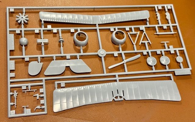

I get great markings in the box printed by Cartagraf so no aftermarket hunting needed. A nifty little fret of brass PE. Great looking plastic with no surgery save for, as I understand it, 1.5mm off the landing gear legs.

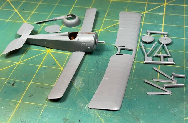

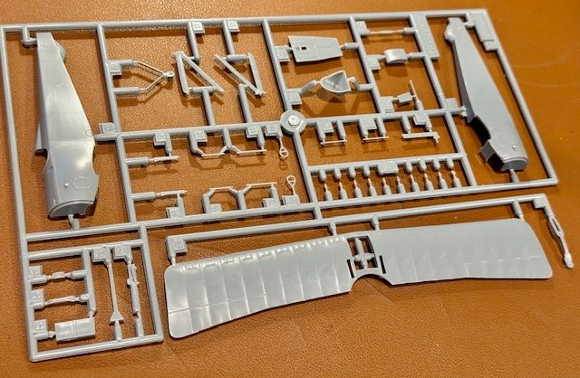

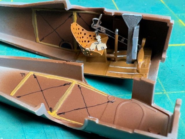

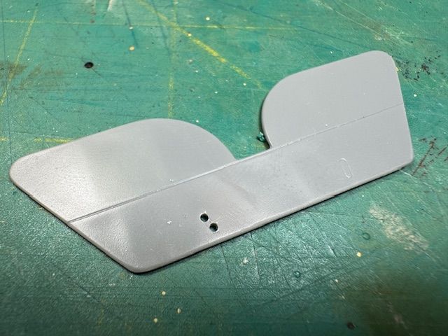

An evening spent cutting plastic. Strange to work on something that doesn't require cutting and hacking to make it fit together. I could get used to this...
Starting with the cockpit.
It will be nice to acually see the cockpit when finished even with the top wing in place.
I opened up the control cable pass through.
A few minutes to swipe around with the sanding stick and we are ready for primer.

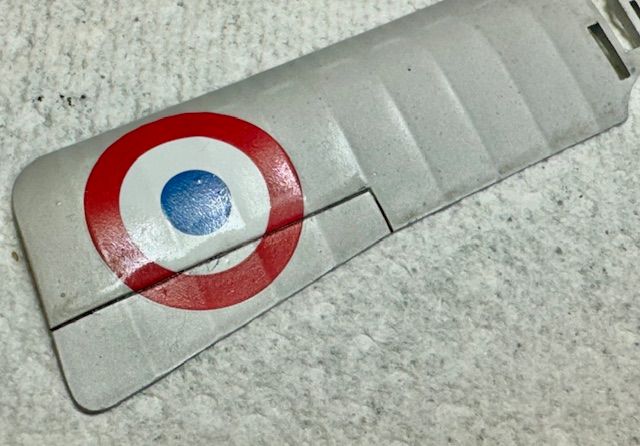

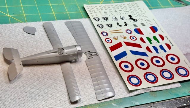

« Reply #10 on: September 25, 2025, 09:08:28 AM »

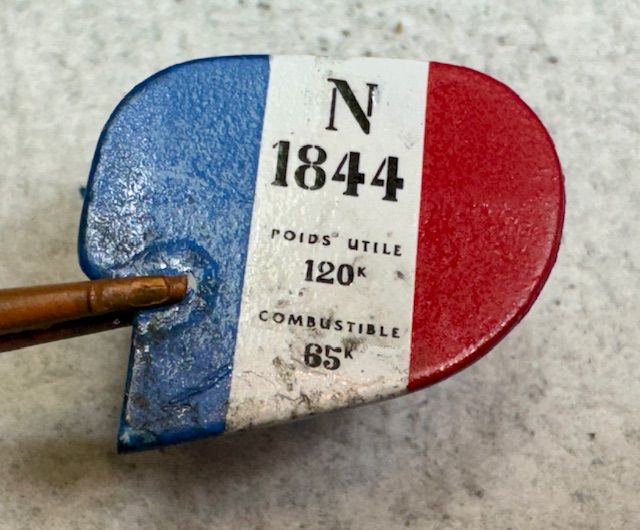

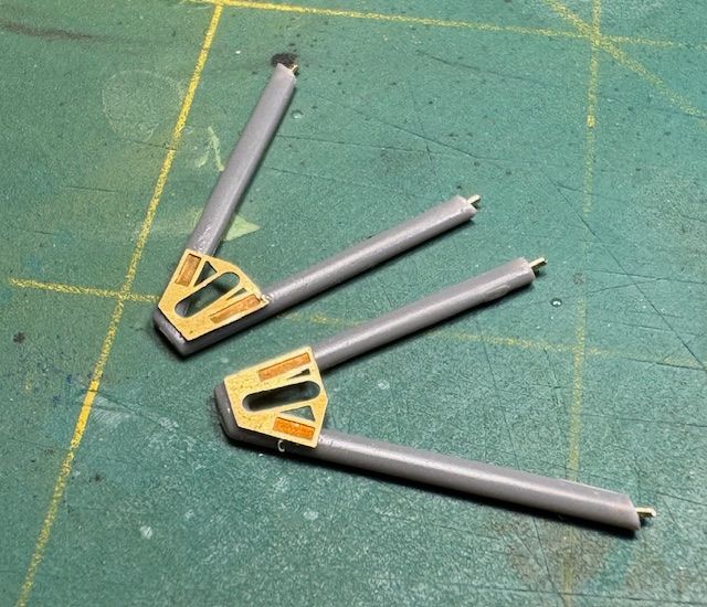

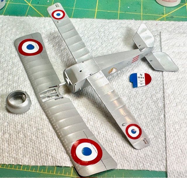

Before painting, somewhere I read the landing gear legs need shortening so I cut off 1/16" and added brass wire pins.
After that, in an rare and amazing fit of cranial clarity, I remembered to adjust the locating holes for the landing gear under the fuselage.

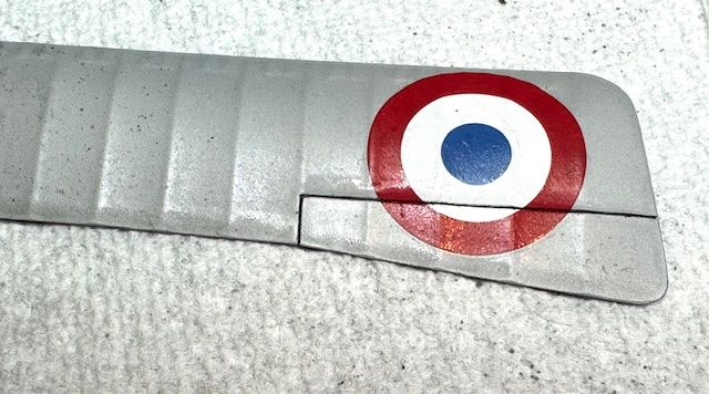

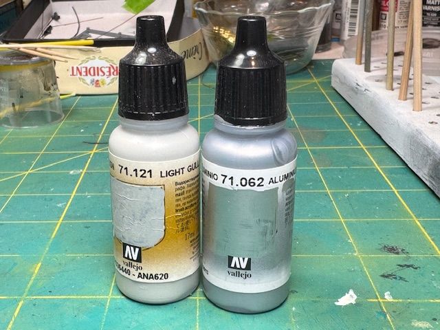

I had mixed a "silbergrau" for my Pfalz but I don't remember what I did. I thought the Nieuport should be different anyway. I went with a 50/50 mix of these.
When I do this again, I will add some Future to the mix as a binder. I was getting some weird silver blotching when touched but all is good sealed in Future.
Painted and ready for decals.
Everyone went on well.

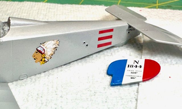

I discarded the 3 black bars included on the sheet and made my own red ones from red wing markings.
I'm gonna let this sit and dry out a couple of days as it feels like it's not dry enough to add another coat of Future. Perhaps I added too much "flow improver".

Nice work Allan. I?ll have to remember to copy your aluminum dope recipe. I?m impressed with the Indian head decal. It looks like there are six, maybe seven, different colors in it. I have a few in 1/72 and they all seem to use about four colors and look very cartoonish.

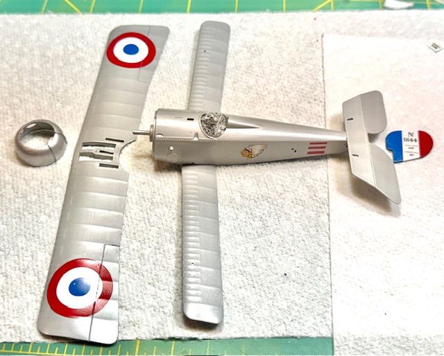

A cautionary tale.....

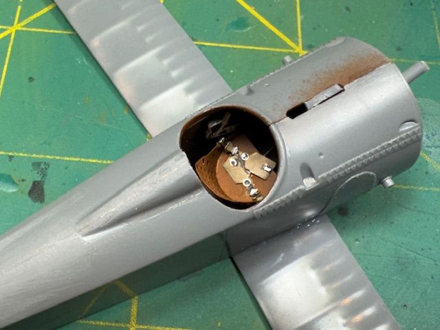

So after the above decals went on, I let things dry out for a couple of days and then went onto the grunge wash and weathering stage.

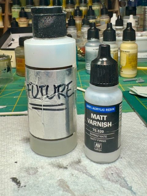

I typically use a dot of black and a dot of brown oil paint and a puddle of white spirits and have at it. This all went well at a rattling good pace, trying all the while to remember Nigal's "less is more" and I think I succeeded to some degree. Since the oil wash is so thinned it can easily be rubbed off so after a day drying out I seal it all up with a Future/Matt finish.
I have used this on dozens of models with great results. This time however I used the "New-Improved" version as I ran out of 70.520.

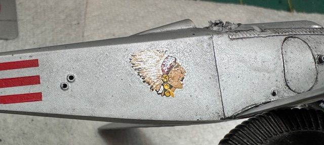

26.651 is not the same nor is it as compatible as the old 70.520 was with Future. Everything looked great in the airbrush pot. Everything looked great when sprayed on. Something happened while drying. The two components seem to separate. You can just see the flat accumulating at the edges.
It also seems that the finish over the decal is glossier than over the paint. On other parts, it almost has an alligator finish but microscopic.
Solution. I originally ordered the "New/Improved" gloss medium to be compatible with the new matt. Then thought "screw that" as I have a life time supply of Future I cancelled the new stuff and ordered the old stuff.
I will continue to assemble my little 17. I'm sure one coat, maybe two will fix all these little anomolies and smooth everything out and it will look fine on the shelf.
