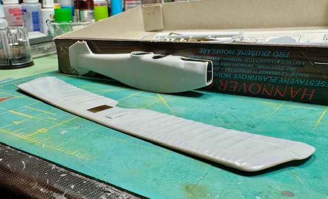

This actually started as somebody else's "shelf queen" but it IS already started. I woke up and didn't want to go another day without a Hannover on the shelf.
Evilbay offered this up for $34.99. Already started, it's qualified for the "Shelf Queen" GB.
Came with usable kit decals and an additional set that would have been included with the Koster Aero Enterprises Hannover kit.

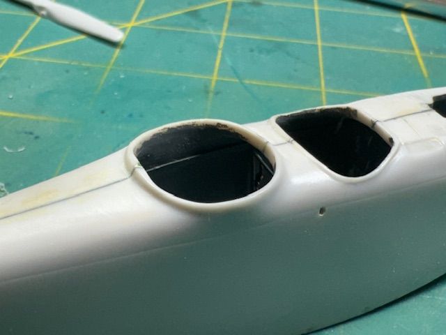

Fuselage and cockpit is already together and painted dark grey, should be varnished wood, I hope I can get in there.

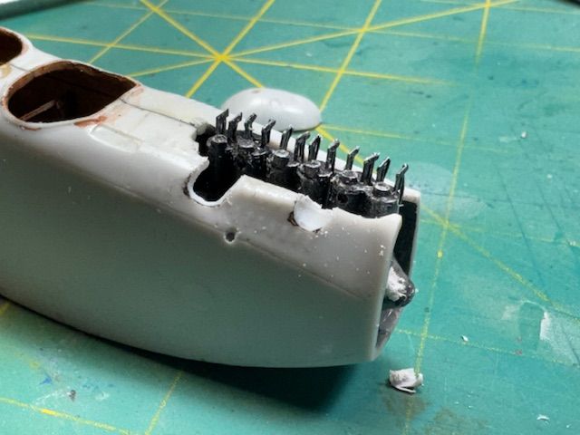

Several bits have come loose in the cockpit. An inventory of parts revealed everything is complete in the box except one itty bitty cylinder head.
I have 5, I need 6. I hope I can fix these after being damaged. I will try and fake something up and put on the last cylinder hidden under the wing.
I will re-imagine these intakes with round material instead of the P-E stuff.

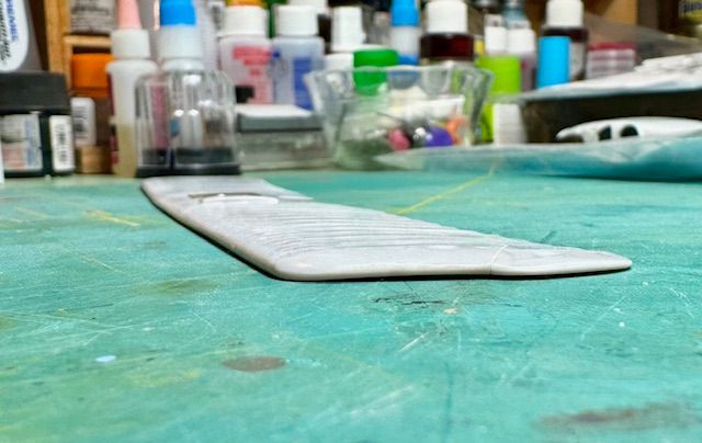

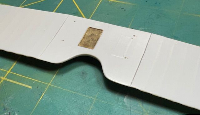

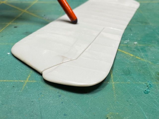

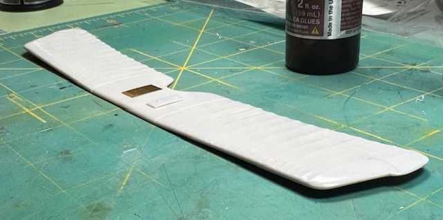

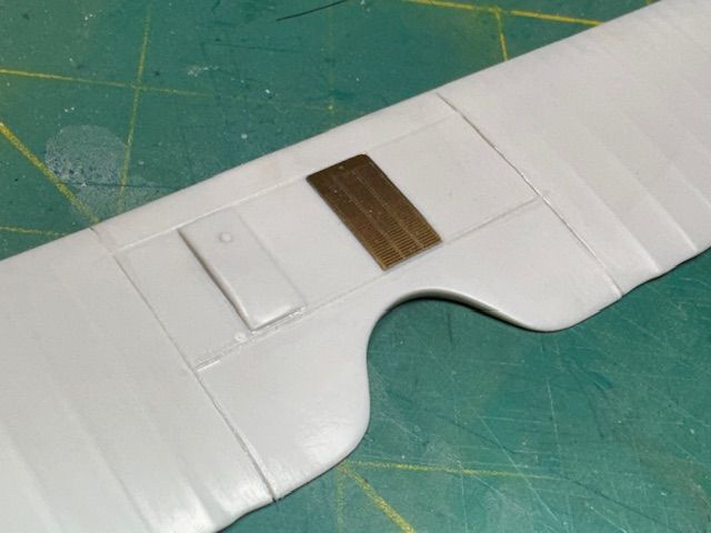

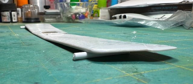

The wing is incorrectly made as one long sweeping curve. The Hannover had 3 separate sections of straight upper wing.
Boiling water allowed me to soften enough to straighten and flatten.
I then made deep cuts on the bottom and super glued in correct position. (Notice the holes for the cabane struts are not equidistance from the center line of the wing, put a pin in that for now...)

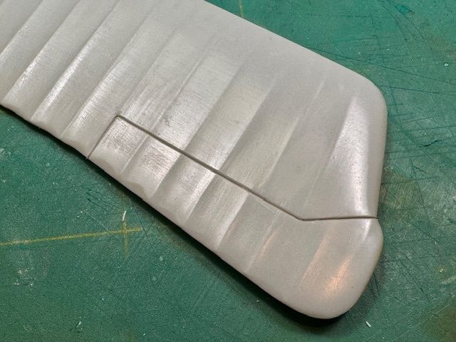

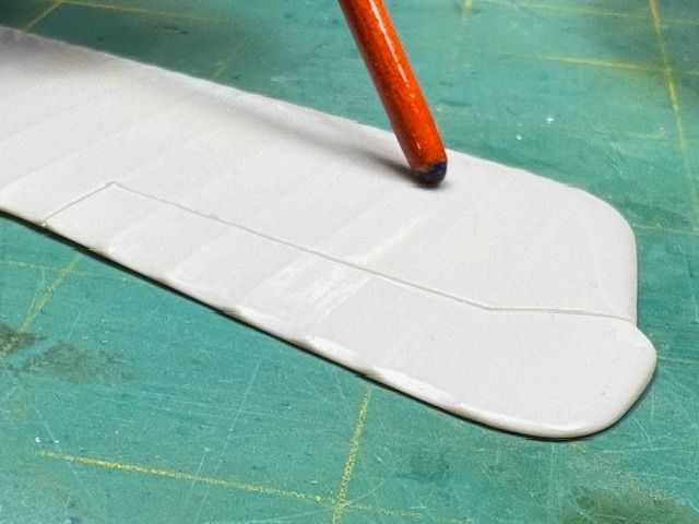

Apparently all early Eduard kits were timid on panel lines so all those have been re-scored deeper along with the missing ones on the top wing. I will add the missing hinges with my furnace tape.

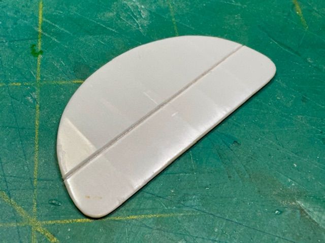

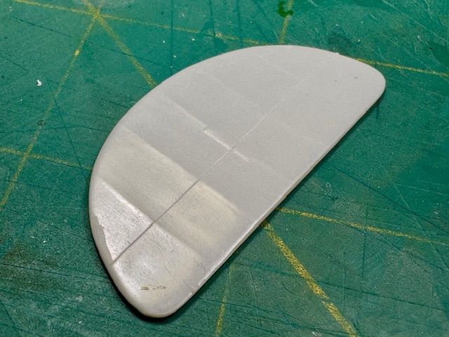

Bottom stabilizer was fabric covered wood so no ribs.

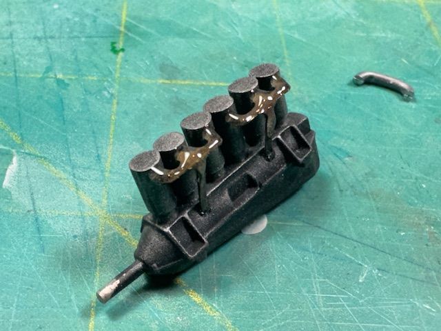

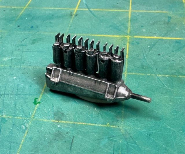

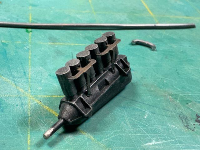

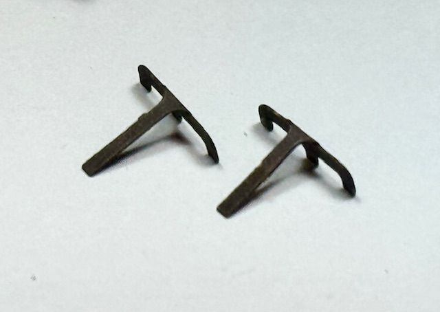

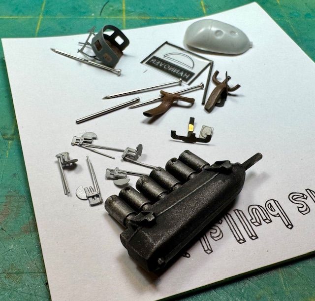

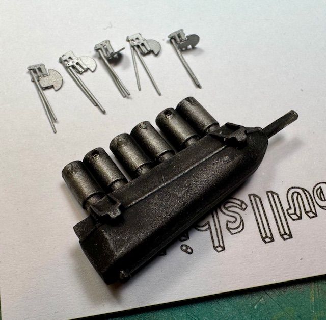

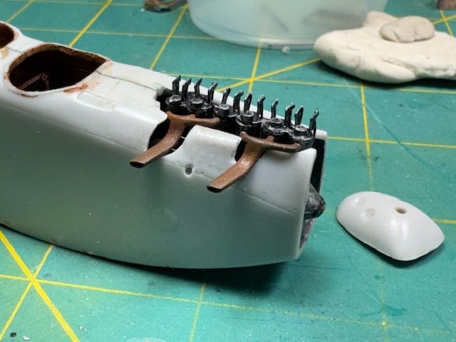

I tried to make my own intake manifolds but it wasn't working out so I used the kits P-E.
I tried to give it some dimension beyond the flat brass by adding some 5-minute epoxy.
I was able to straighten out the rocker arms that came bent in the kit. I made the missing rocker arm set from sheet plastic.
This should be fine since so much engine is hidden by covers.

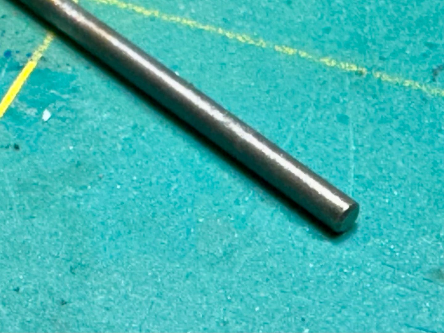

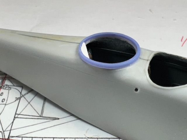

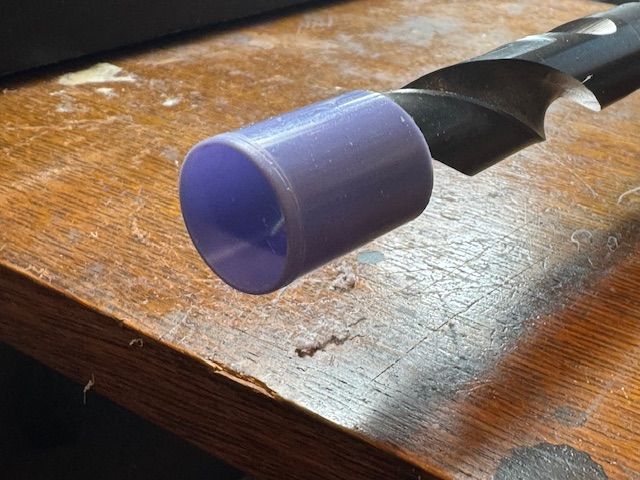

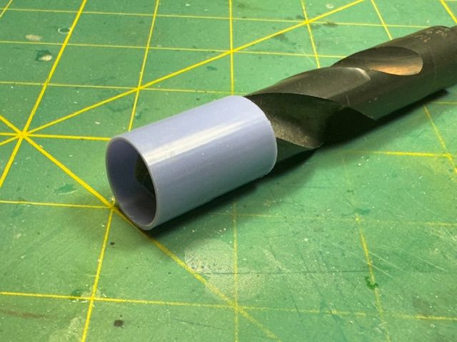

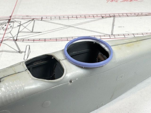

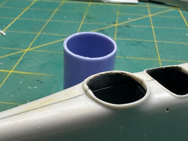

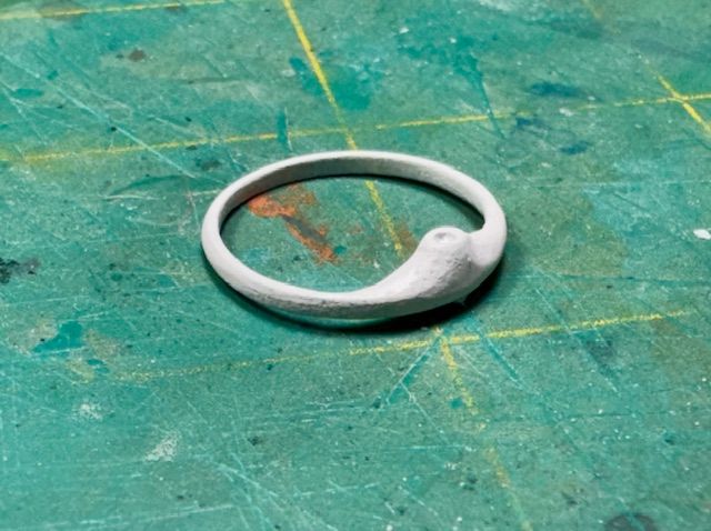

I was surprised (perhaps I shouldn't be) that Eduards did not include any kind of separate gun ring for the rear cockpit.
Years ago I found somekind of knitting needles or something at the craft store bargin bin for pennies. I bought them for the variety of sizes and made from plastic tubes.
I found a bit the correct size to hold the tube and mounted it in my drill to use as a lath.
I used the back of a x-acto blade to cut off a ring.
Still a bit large, I removed a small section to lessen the diameter.
Close enough.

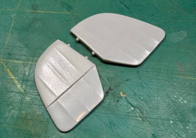

I'm working on the interior and trying to decide if I want to try and add the warpage or washout to the ailerons. More hot water on the kitchen stove....

Now that really is clever scratchbuilding, well done! And your fix for the intake manifolds looks great, the flat lower part will be hidden anyway.

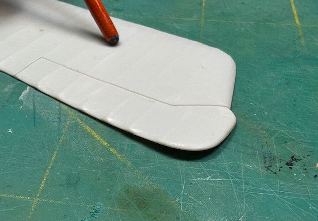

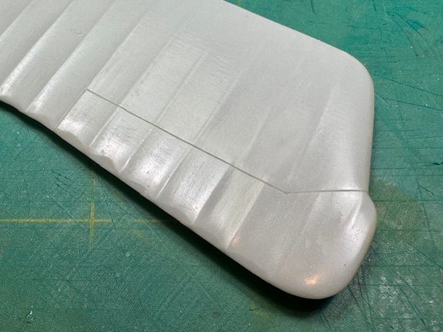

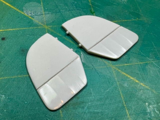

A bit more progress.

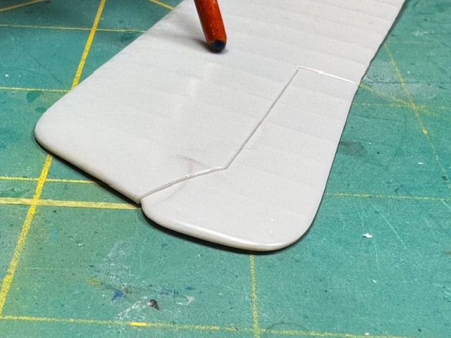

There is noticeable wash-out ( correct word?) on the ailerons. Out with the boiling water again.

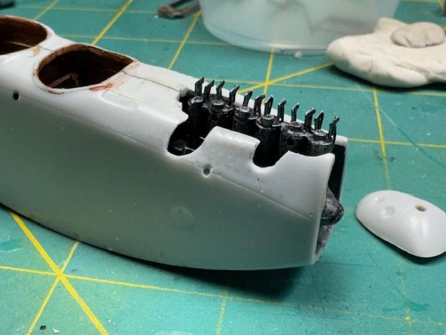

Eduard would have you hang the exhaust entirely outside the engine covers. Hannover had cut outs for the exhaust.

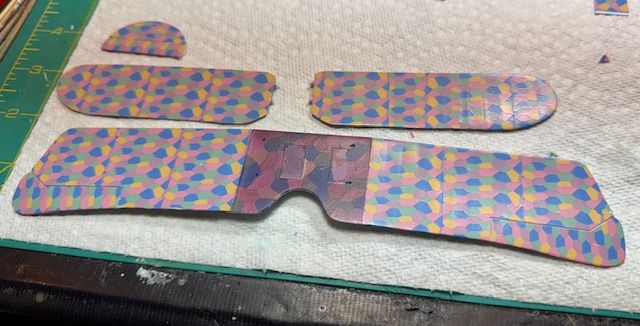

I think I'm about ready to start painting, I'll start with lozenges on the upper wing.

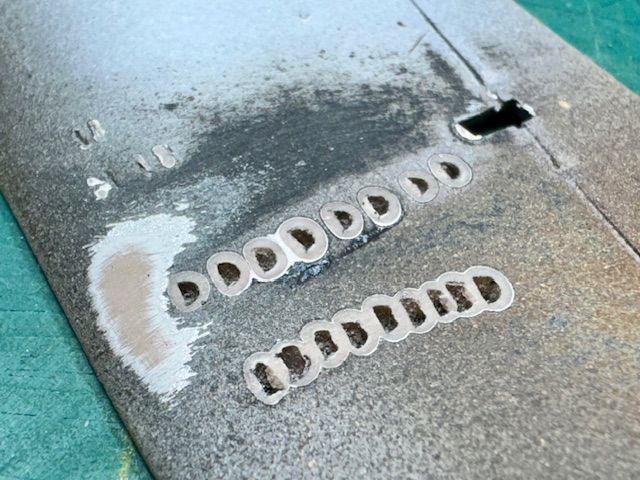

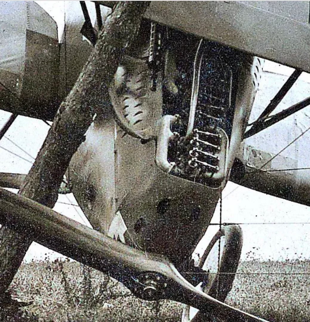

There are about 50 little rear facing exhaust louvers around the cowling.

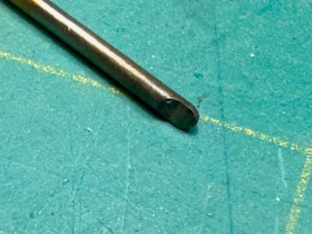

Eduard has these wrong and I was attempting to correct them but I just can not figure out a good way to do it.
I did take a 1/16" drill bit and ground down the end to the shape I needed.
I heated it up and tried it out but I can do a few but not 50 consistantly.
I will get some "Archer Transfers" louvers and be wrong but be done.

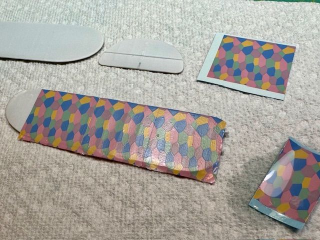

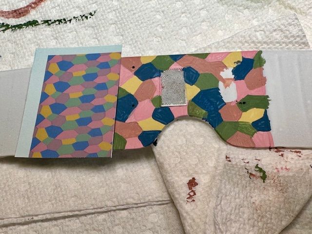

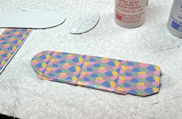

The only ever experience with lozenge I've had was the Fokker D.VIII I did a couple of months ago. I started on the lower wing and wondered why it looked funny.
Duh..... I fixed it and moved on.

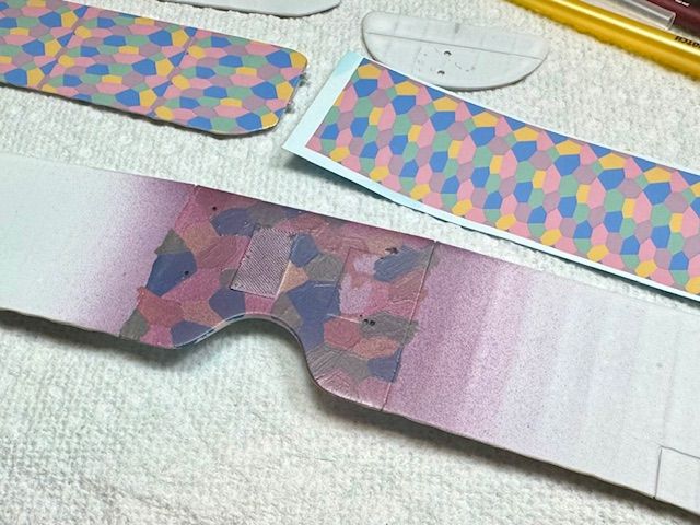

I hand painted the center section. On the real aircraft, this section photographs very dark so I overlaid some violet. But it may be the same Prussian blue on top for all I know.
And this where we are tonight.
I may go back and redo the field repaired part of the lower wing in 4 color lozenge as they might have done.
I'm going to mask and airbrush the top of the wing as I don't want brush marks.
And then......rib tapes....
