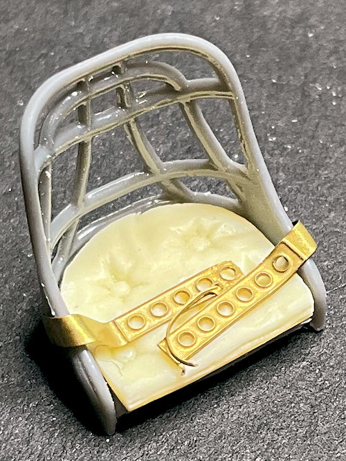

Added seat cushion and photo-etch lap belts for the pilots seat.

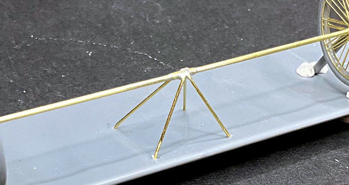

Replaced the weak, two part plastic landing gear axle with Brass rod and tubing.
Created Brass rod support frame for the landing gear axle (not supplied in the kit).

Mike, from which fret did you take the seatbelts?
Offline Mike Norris (UK)
  • Posts: 2718
Re: 1:32nd scale Caproni-Pensuti
« Reply #4 on: February 13, 2025, 08:40:42 AM »
The lap belts were from my photo-etch 'spares' collection.
The kit does not provide any,
