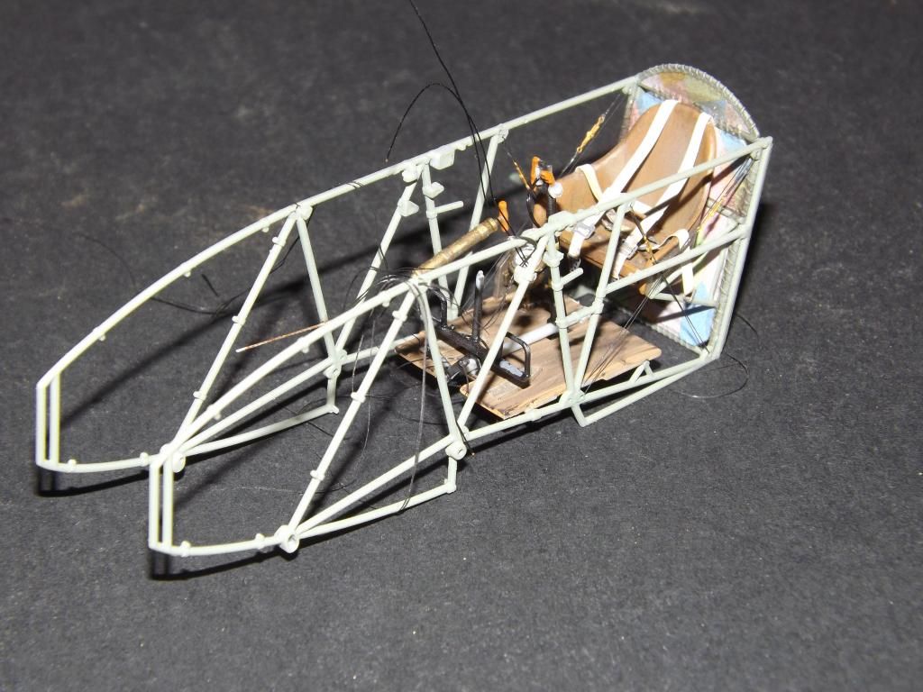

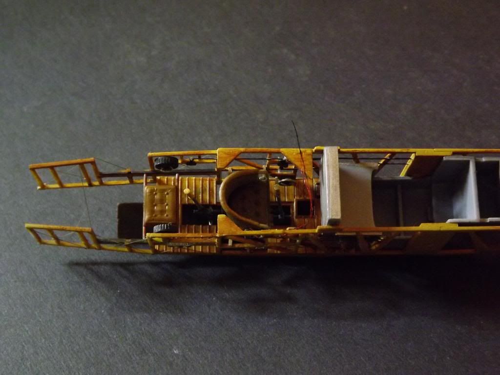

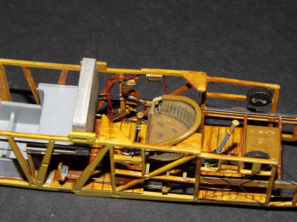

« on: February 20, 2013, 04:38:30 PM »
  OK, here is my progress on a DH-9a operated by the USMC in 1918. All paint is enamels,MM and Humbrol.  I've added rigging with EZ line, and Radus turnbuckles. the wires from the battery were stretched on the sprue, and painted black and red, cut loose, and wrapped around each other, and attatched to the battery, past the switch panel, and behind the dash. This is basically press fit, which is tight with the paint.

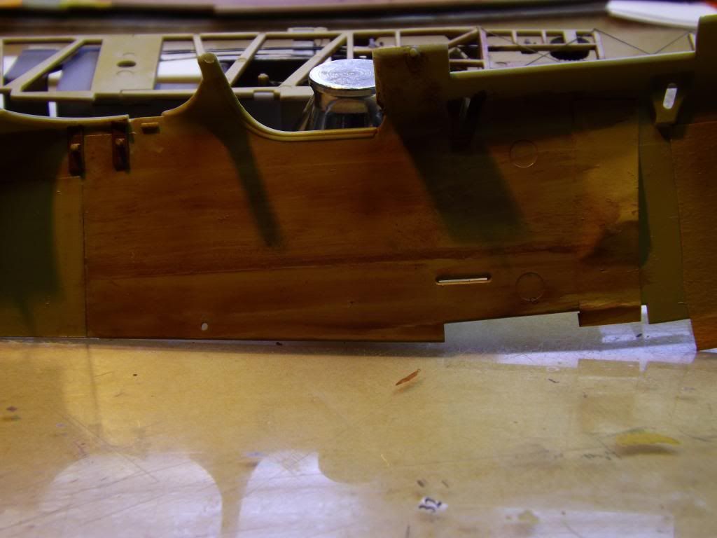

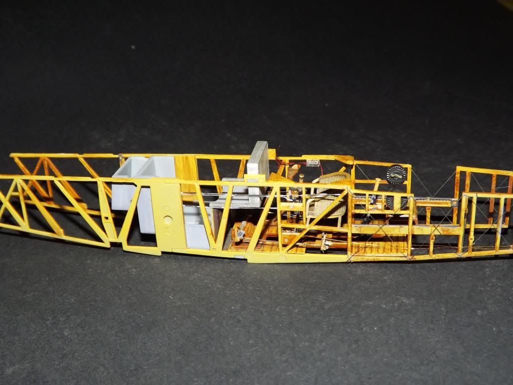

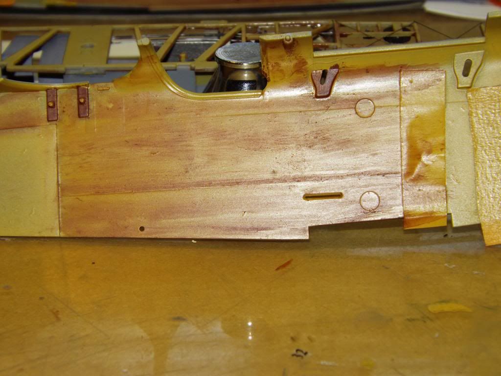

« Reply #12 on: March 12, 2013, 04:01:03 AM »
OK second installment. I sprayed Humbrol "Sand"(63) as my base coat, and let it dry in the breeze thru a window. next day, I laid down a puddle of MM burnt sienna, and then just applied it with a brush and used thinner to control the effect. One thing I've done is lay down a base woodgrain effect, and then stipple the paint; I then brush that out to break up the effect and try to get a grainy look. I used a straightedge to lay on two tones of paint to show where two pieces of ply may have been used and butted up. the series of pics will show where I got. The wood will prolly get a satin top coat, and then CDL as needed. Apologies for the clutter in the back!

« Reply #13 on: March 12, 2013, 04:11:54 AM »
Coming along nicely Mike.
I assume the ejector pin marks will be hidden behind the bulkhead of the instrument panel?
mike in calif
Re: USMC DH-9a
« Reply #14 on: March 12, 2013, 04:24:16 AM »
Dean, yes, Those won't be visible, or most of the interior for that matter. IF I don't add a detail, that will be visible.
