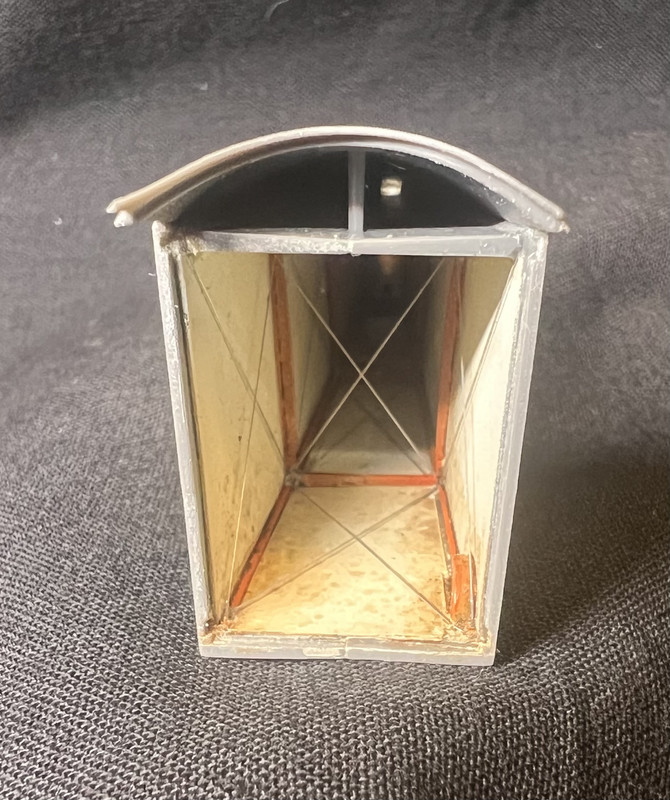

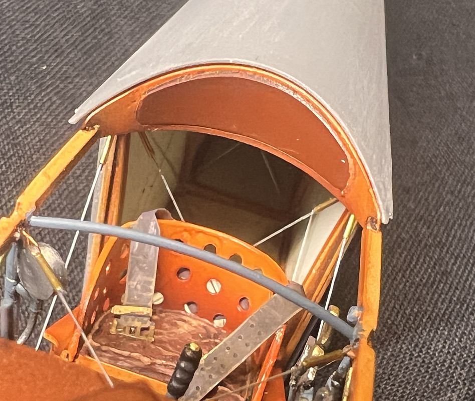

There is just a cross-bracing wire behind the seat, no cover, so detailing the back of the fuselage is worth a little effort
It will be visible, I think.
Fit is still perfect.
It's just about visible with a good light pointed in the right direction...... ;)
I didn't do the extra cross bracing but I did paint the fuselage interior and wooden framework just in case. I also had a couple of control wires leading from the back of the seat towards the rear.

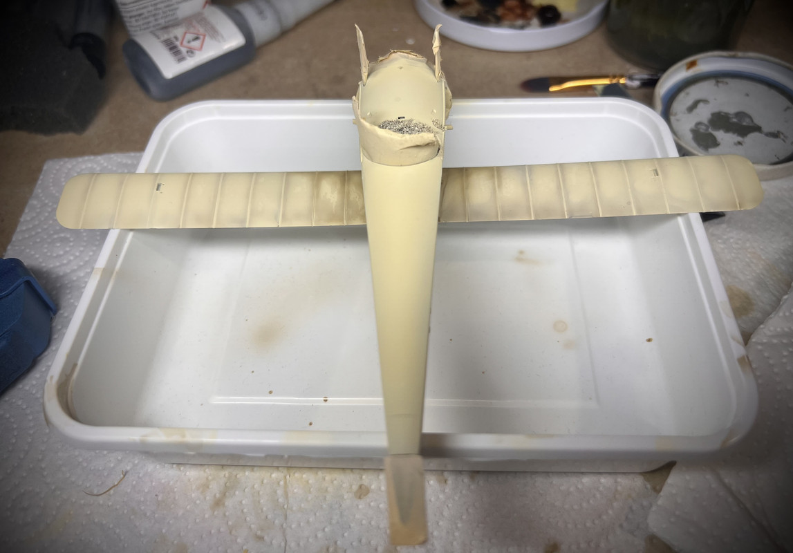

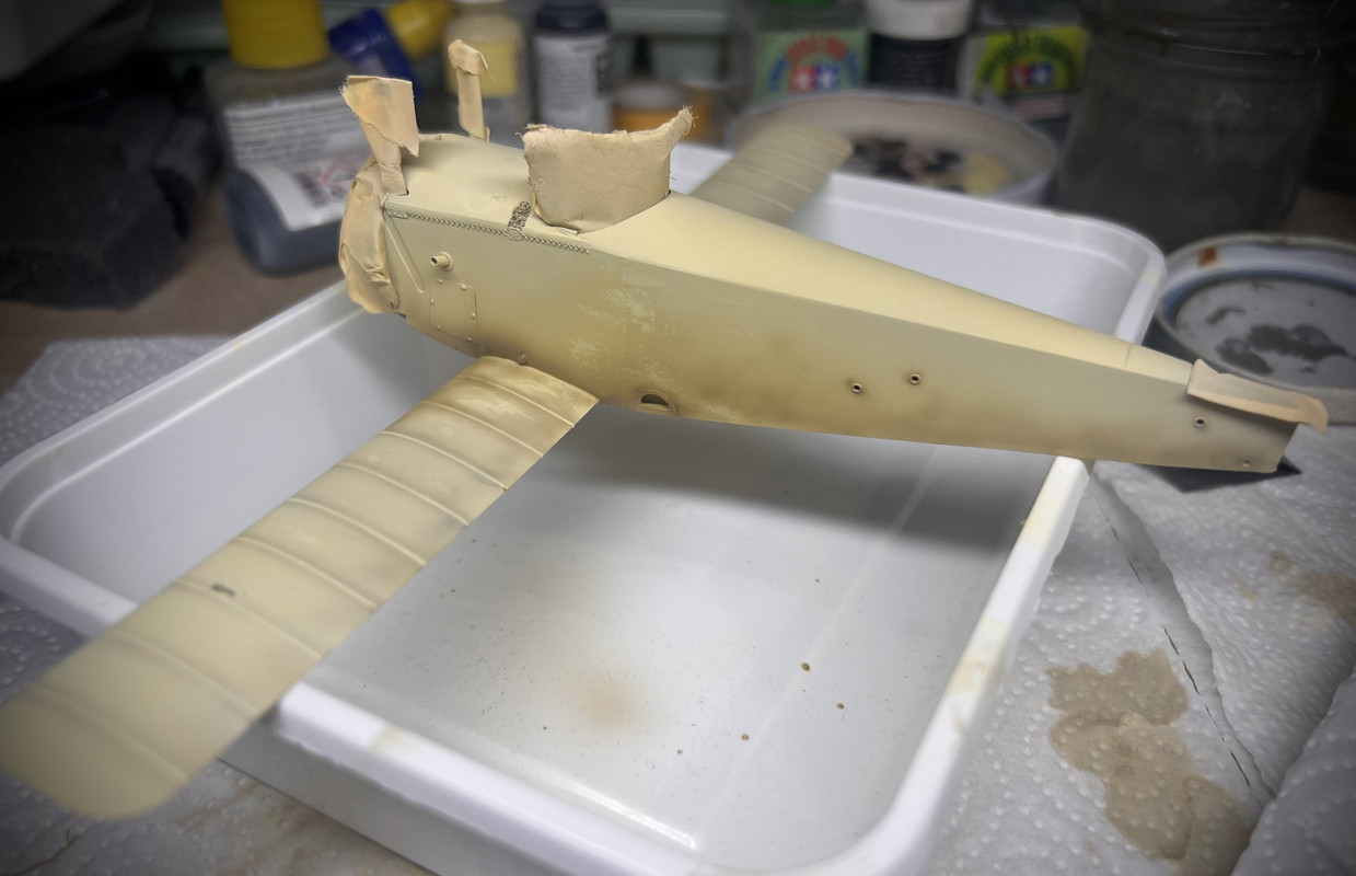

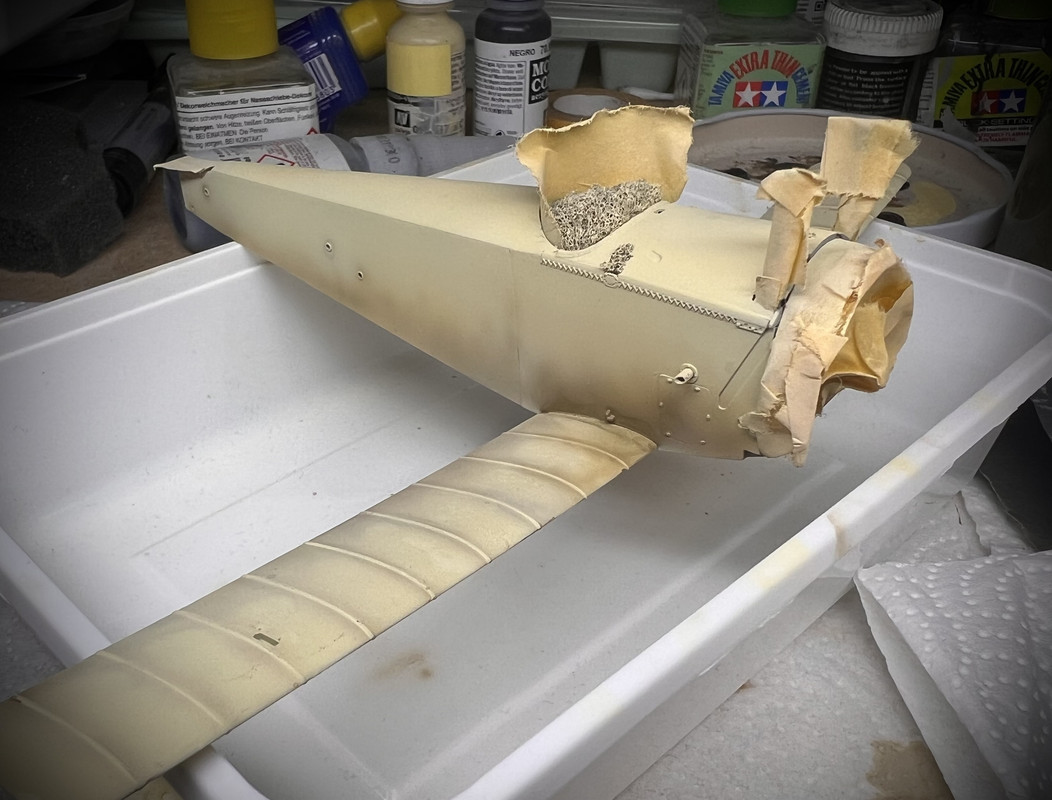

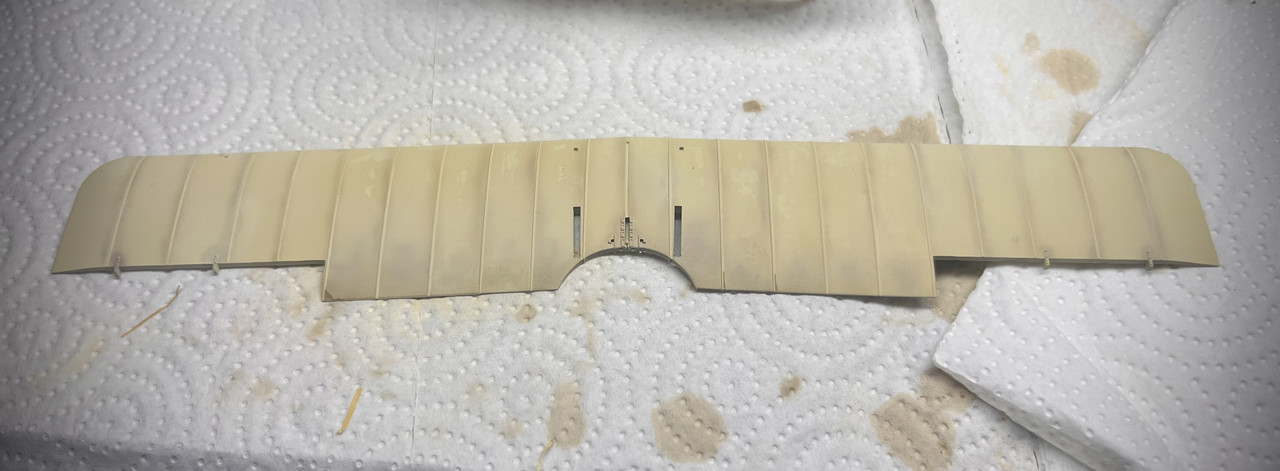

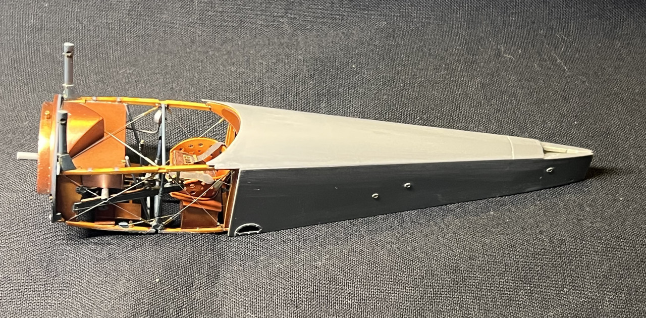

Thanks a lot, Zac, Alan, Tim and Nigel. Nigel, there is so much  in the cockpit that is invisible in the end, it was only fair to add some detail in the back, too  :)
I went on finishing the construction of the fuselage. Now it is painting evening after evening. I had ruined the needle of my airbrush (one should go to sleep when tired, not to the paint shop). And I had tried to fix it by straightening the bent needle. With that I ruined some parts of the paint job. In the end i ordered a new needle ? way better. I should have done this before.
I also played around with some chipping effects where I had some fatty varnish in mind that chipped easily.
