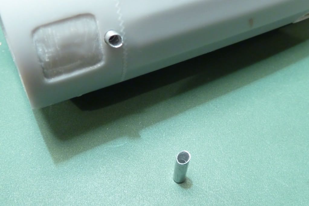

All the reference photos seem to show intake tubes to the carb so I made a pair using aluminium tube - the wall thickness reduced by running in drills of suitable size. The outer ends of the tubes are filed to a chamfer facing into the airstream. I'll join the tubes in the fuselage with a slightly larger diameter tube.

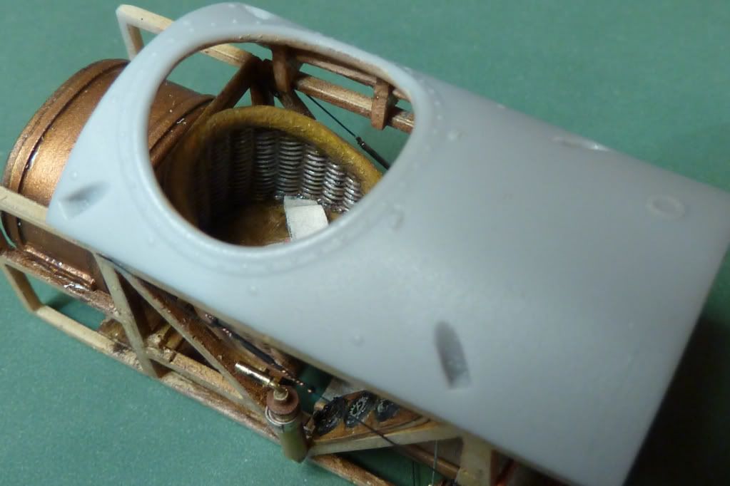

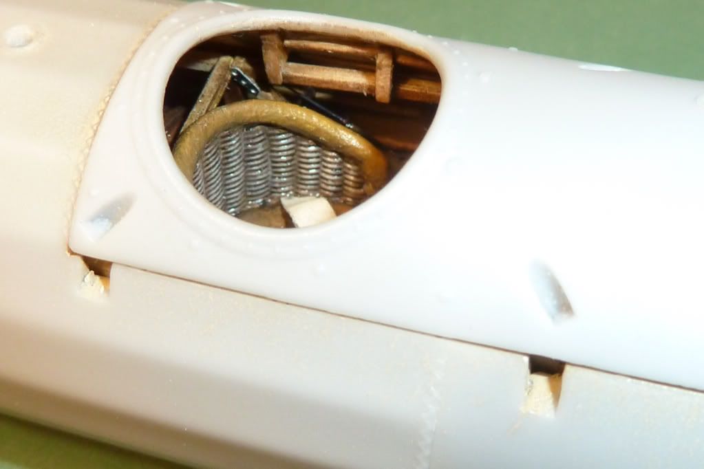

The metal deck over the cockpit has a wooden frame under it which has vertical timber brackets onto the main frame of the fuselage. I'd started making an attempt to show a bit of this (ref the photos above) but it wasn't right so had another go & recreated a semblance of a frame under the (resin) deck that allowed a better recreation of the vertical brackets.
Here it's in position.

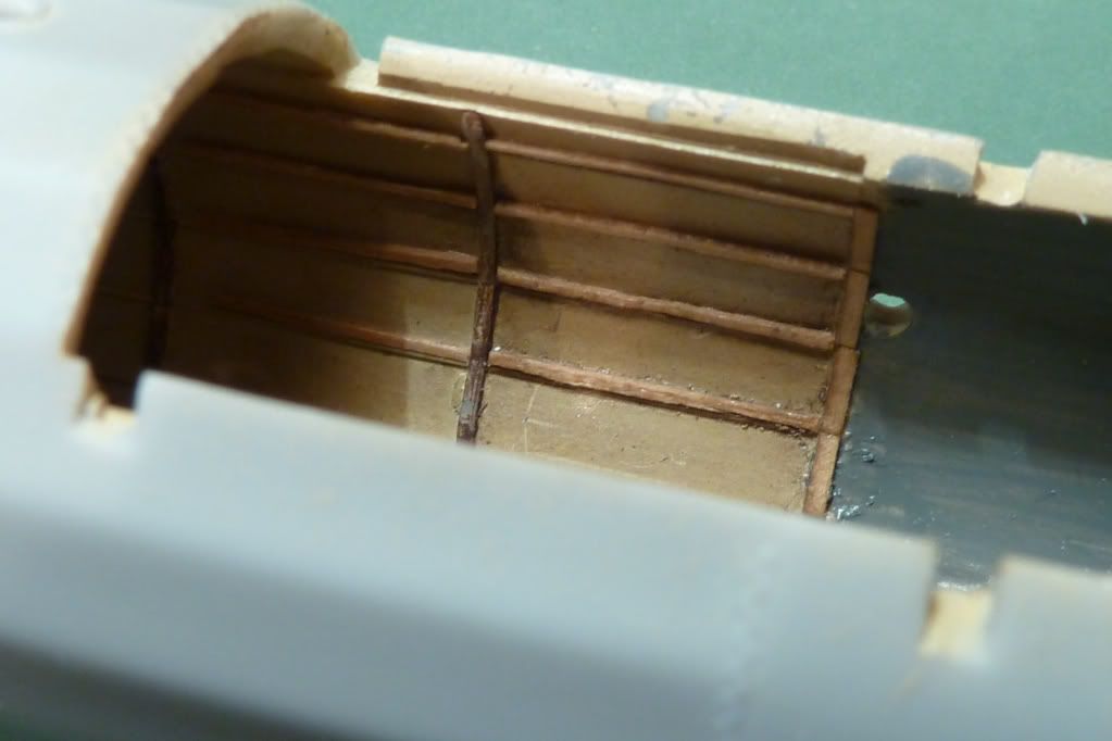

I didn't have any pens to colour the frame & stringers cast into the fuselage so I thinned down some Boxwood strip & glued it in position instead. It looks a bit rough in the photo but with the naked eye it's not too bad plus very little can be seen of it when the cockpit frame is inserted.

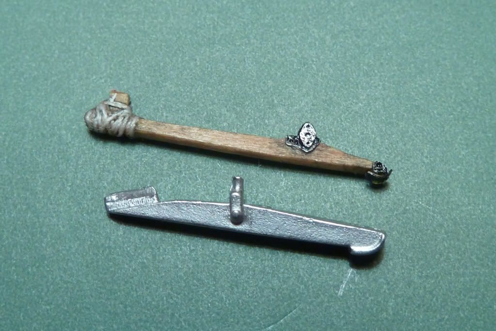

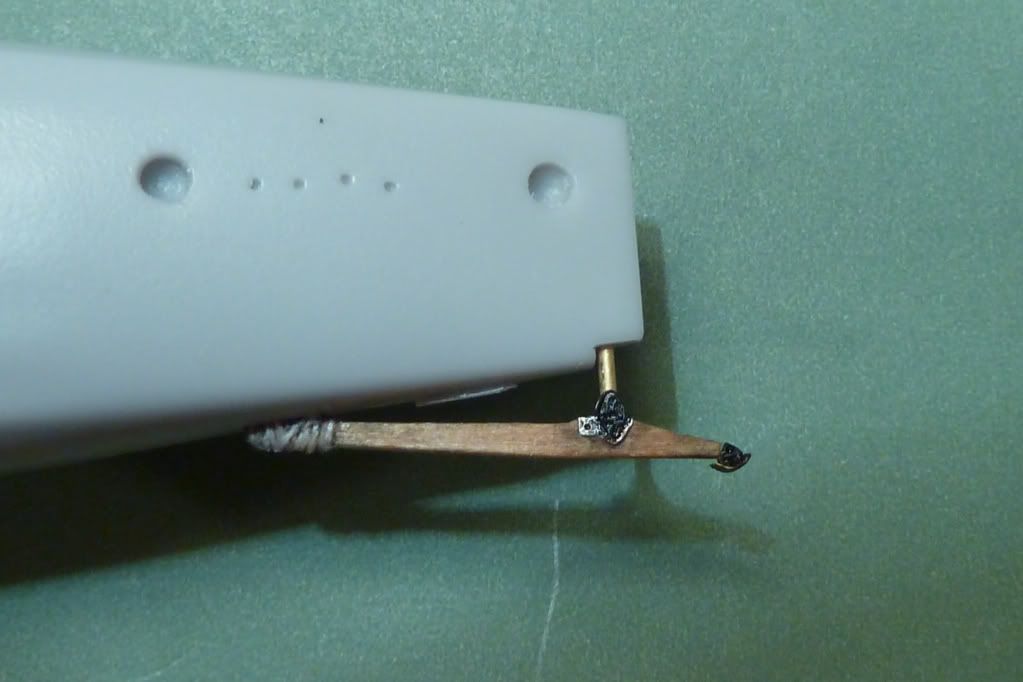

The tail skid is a white metal part in the kit but compared to various photos of the real thing it looks to be the wrong shape; more precisely it would be more correct off the skid plate had been put on the other end. I made a new one from Boxwood which is so fine grained it's probably 'scale'. The various fitting were photo etch brackets intended for racing car suspensions. The brass vertical post will be set to correct length & painted when it's finally installed. The fuselage casting has had the old skid location hole filled & a new one cut further forward.

Fantastic, love love love that tail skid, and those brackets are amazing!

Beautiful work on the tail skid Russell, a much more convincing item when compared to the kit supplied part. Your work on the inspection panel retaining pins is incredible, these items will certainly add a touch of realism to your model. You are doing a superb job on the Bristol so far and I look forward to seeing your next progress post.

being new here, I assume just little bites here and there each pc session... this night it seems I found a gold cave! I think I'll try your approach at the tailskid, if you dont mind, it's a gem!!

That tailskid is spectacular, Russell.  How did you stain the boxwood?

Bud, the boxwood I had to hand varied from almost white to a sort of straw colour so I picked a piece that had a some colour to begin with. The assembled skid was dipped in Future which sealed the thread (bungee) & partially sealed the wood. A few licks of MIG ‘Rust’ & ‘Winter Grime’ were used to give a bit of extra staining particularly close to the main bracket & highlight the bungee.
Boxwood is ideal for making bits of timber frame etc on WW1 subjects as the extreme fineness of the grain gives a good ‘scale’ appearance plus it’s easy to carve, split & so on. A touch of stain brings the subtle grain out. I use strips that were sold as ‘beading’ or ‘banding’ by a shop specializing in wood turning & cabinet making supplies. A few lengths have lasted years (originally bought for a small woodworking project). They come in various sizes from 1/32” (0.8mm approx.) square upwards.

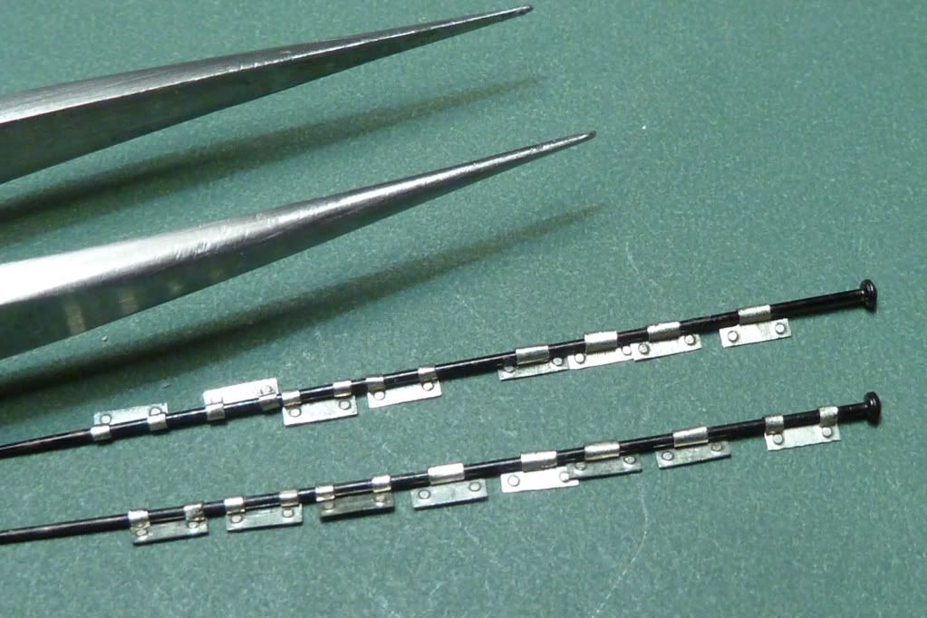

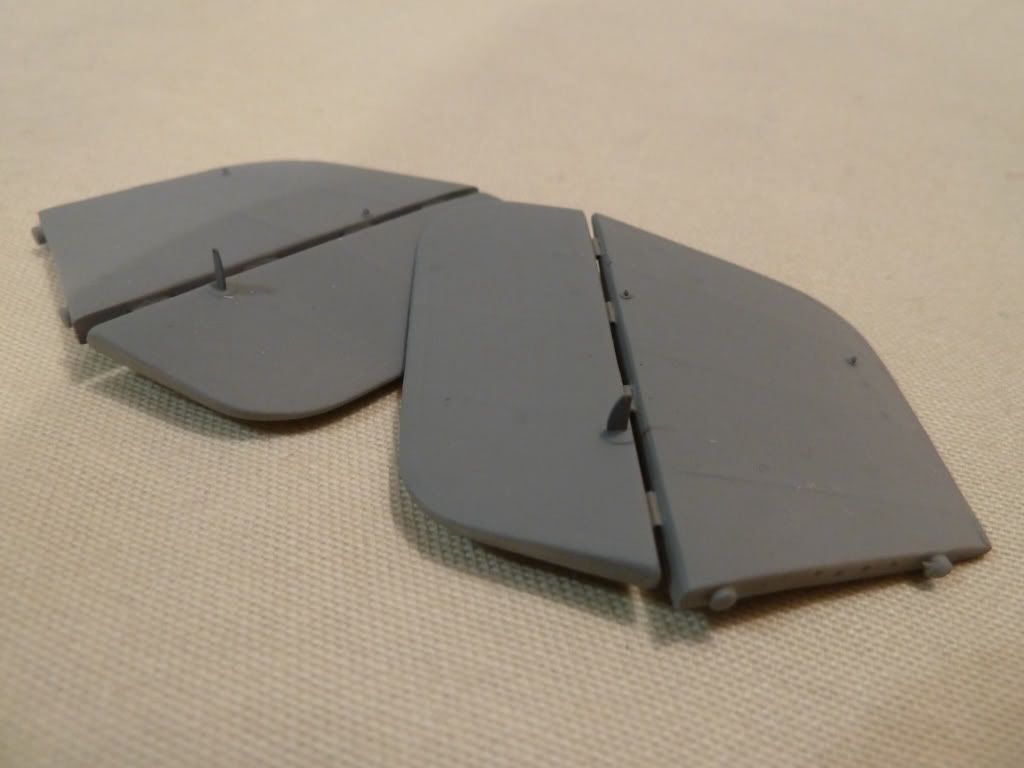

Some real progress has been made recently though. The tailplanes are primed ready for a coat of Alclad. I copied the method Des used on his build & used short lengths of 0.5mm tube to represent the hinges. Bob's Buckles supplied the eyes for the rigging wires.

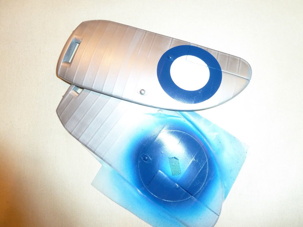

The wings are further on, painted with Alclad. The domed mounting points for the rigging are a pain to fix as the spigot on the domed part is far larger than the hole in the photo-etch 'washer' plate. It's not difficult to reduce the size of the spigot but it is difficult to hold the tiny domed part whilst it's filed to size.
I should have fitted these mounts after paint & decals as it makes decal application easier - but I didn't.  :-[ It's worth noting that some contemporary photos show the mounts as main wing colour not painted to match the roundel. I also got carried away & fitted the control horns which I then had to remove to allow either decal application or the masks which is what I ended up using.
Because of the rigging mounts being in place I decided to paint the roundels. Montex don't do a mask to suit the roundel diameter so I made my own from Frisket paper using an Olfa cutter. This was a new technique for me so I was pleased with the result. The Alcad came away with the mask in one or two tiny areas which are easy to touch up but other than that it worked fine. Just the red centre to go, I've made a mask for it but I may chicken out & use the kit decal which handily is a separate red circle.

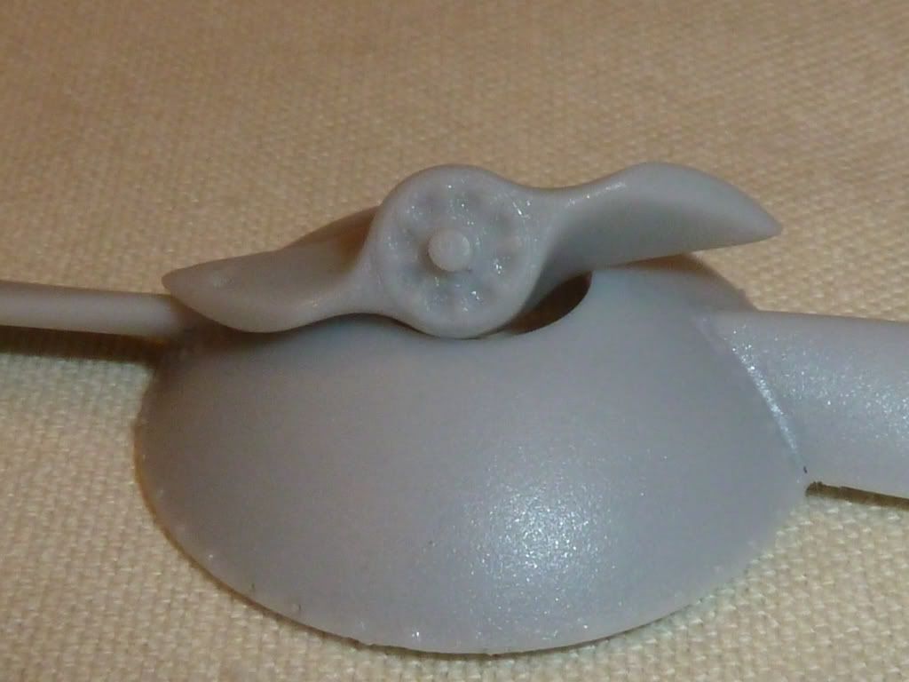

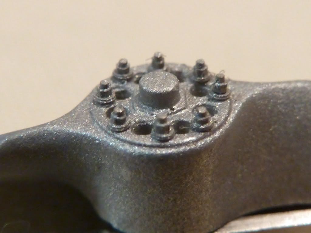

The kit supplies the centre section & boss of the prop as a separate item. It's partly visible through the hole in the spinner.
I cut the moulded bolts off & replaced with RB Motion bolts with separate washers. The grainy texture of the resin is apparent in the photo but not to the naked eye, in any case it needs a bit of smoothing & another light coat of primer.

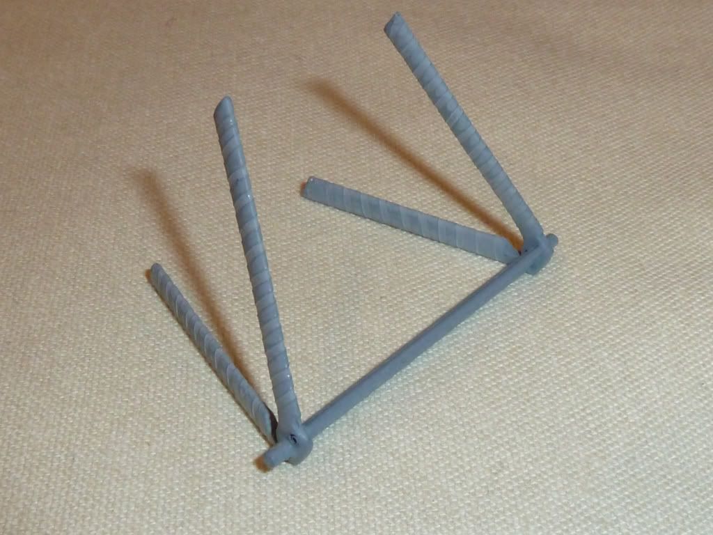

The undercarriage legs are bound with what looks to be a strengthening wrap (in many but not all current photographs - depending on the aircraft). I tried to replicate this by binding thin masking tape around the legs then spraying a few coats of primer to build up a thickness, then removing the tape & spraying another couple of coats.

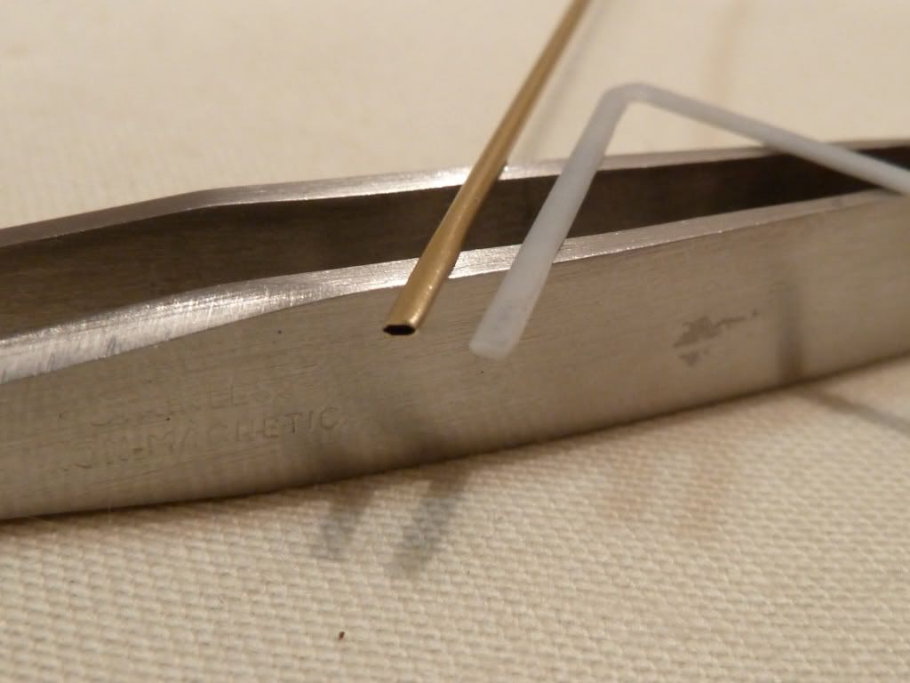

The central rigging 'tower' is formed from fairly flimsy resin struts which are a fairly flat oval in cross section - too flat really plus I'm concerned about them bending.  :-\ Albion Alloys 1.2mm thin wall brass tube flattens nicely to give a more accurate & far stronger version. Here I've just flattened part of a tube as a trial.

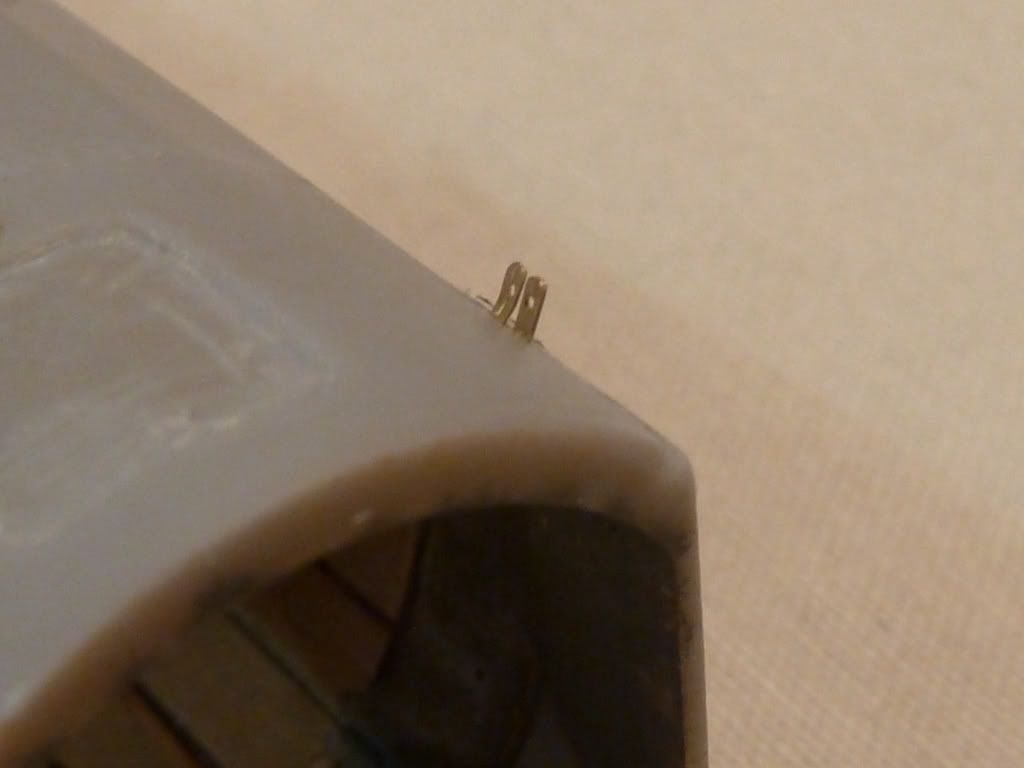

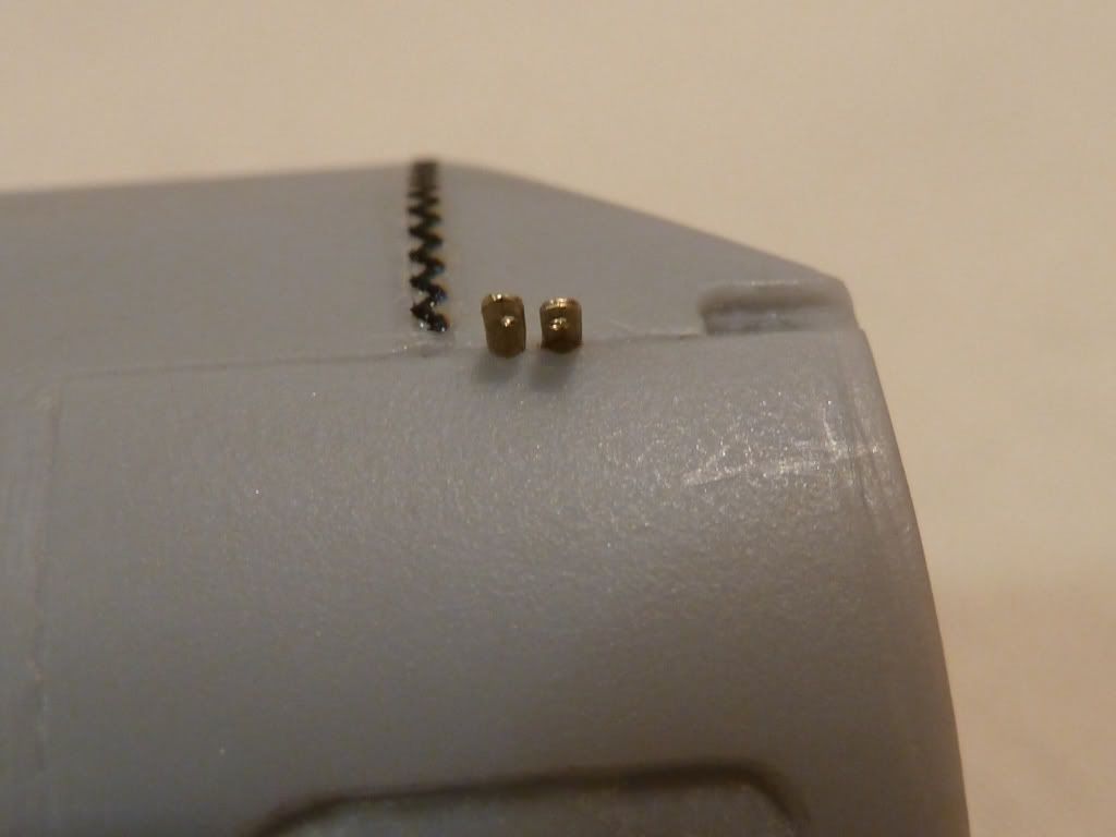

The rigging under the wings connects to a plate(s) protruding through the fuselage. Some current detail photos show the plate protruding as one piece with two holes whilst other aircraft (replicas) show the visible part of it as two separate lugs.
I thought I'd try to replicate this so although I may change the detail at the moment. I used 0.5mm tube, squashed the end & drilled a hole (0.25mm).
They are only roughly pushed into their holes at the moment & need adjusting for angle & projections.

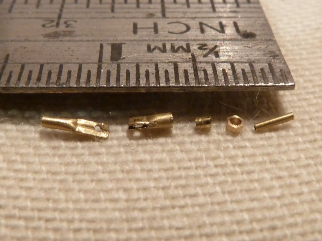

The plan was to make a forked end connector for the rigging wire which will connect to the lug on the fuselage via a tiny bolt from RB.
This is my attempt so far.
The part on the left is the fuselage lug. The end connector on the rigging wire is formed from a forked plate formed from a length of tube which is partly squashed then a hole drilled then it's split by filing away the sides of the flattened section - this slips over the first lug. Third from the left is a short length of tube which goes into the tubular part of the split connector to reduce the internal diameter to allow the thin tube on the right to slip partly in. The RB Motion nut slides over that acting as the adjuster nut (well not literally at this scale  ;) ). The rigging wire is glued into the end of the thinnest tube. A long winded description of a tiny item. I'll go down this route if I have to but I'm exploring ways of using the Gaspatch RAF connector.
