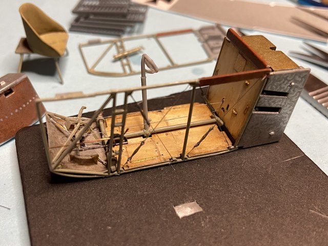

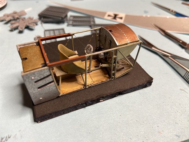

Since starting this project off with a goof on the control quadrant (rescued by Bertl, nochmals vielen Dank, mein Freund!) I've been working on the cockpit, and making slow progress while concentrating on other aspects of what, for me, is a massive undertaking. I'm quite happy with the way it's coming along:
Lots yet to be detailed, the control column, instruments, safety belts, finishing the rigging, and I'm fairly sure I'm going to replace the wobble-pump, since after cleaning up the sprue attachments it looked unacceptably clunky. But progress is being made. And, as always, there was a twinge of dismay upon dry fitting it into the fuselage and seeing how very very little of it will be seen once things get buttoned up...
... but God will know it's there, right, Nigel? :)
All best,

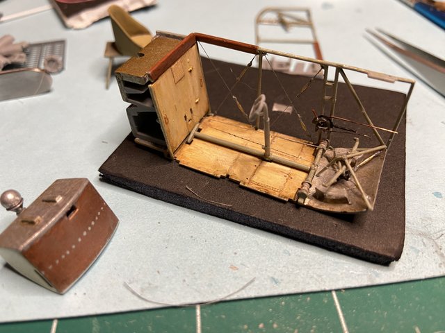

Other aspects of the project have been occupying the past several weeks, but work progresses and I've finally been able to put some time in on the cockpit:
I added the rudder and gun-trigger cables, and began some oil-staining on the Aviattic French Linen decals on the cockpit walls. In the real aeroplane, the  turnbuckles in the front bays were actually bound with what looks to be either strips of fabric or leather, presumably to avoid catching on the pilot's clothing, but this is the first use of test copies of the six-inch 3D printed turnbuckles my sons and I are developing and I just didn't have the heart to cover them up :) I decided not to add the elevator control-lock at the base of the column, reasoning that it was developed to allow the pilot to have both hands free to deal with gun jams according to Peter Grosz in WWI Aero; since the E.I was a first-gen weapons system I doubt the need for something like that had become clear yet. I may be wrong, if anybody knows for sure please LMK.
