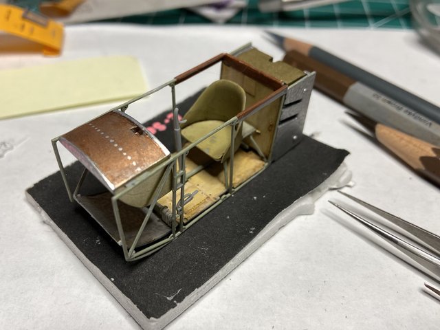

For now, at least, I'm currently well into the cockpit of the E.I (Early). I'm honestly a little hesitant to post my efforts on the heels of recent Eindecker builds by Przemol, Gary, Tim Mixon, and Mike N, but it's been a while since I've posted any of my own work and I thought I'd put up a couple of pictures of my progress. Period cockpit details being fairly scarce, I'm making extensive use of Jamo's wonderful photo collection of the Achim Engel/TVAL repro currently based at Hood Aerodrome in New Zealand (Zac's stomping grounds!). While that one's an E.III, it provides a pretty good starting point for the earlier version.
I replicated the mixed copper/brass construction of the fuel tank just for fun/practice (knowing it would be completely hidden), complete with lines of blobby solder marks; likewise some totally unnecessary sworl effects on the areas behind the rear cockpit bulkhead to test out different combinations of methods:
[/url]

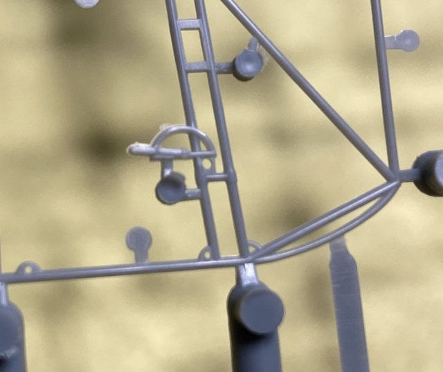

This weekend I decided to cut off the molded-in mixture control quadrant/"block tube":

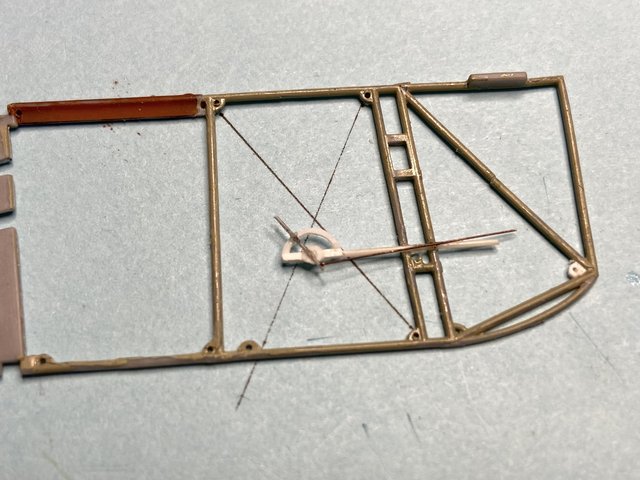

... since it seemed too far forward (the pilot would have had to have had arms like a gorilla to reach it comfortably), and scratchbuild a replacement out of a slice of Evergreen tube, strip, copper wire, and stretched bits of sprue:

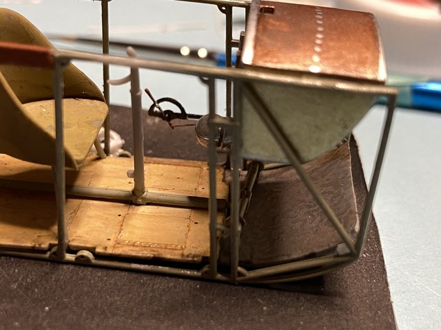

It actually came out much better than I'd hoped, once it all got painted and temporarily mounted on the cockpit framing:
Much left to do, grip on the control column, rigging & control cables, instruments, seatbelts, plumbing, and on and on. But I'm pretty happy with it so far, and, (best yet!) it's been tremendous fun.

Nice work Dutch, the fuel tank looks great!!

Great start indeed!
what did you use for the fuel tank? pencils?
the effect is very convincing....

Allow me to make a small remark, Dutch:
Wingnut Wings has designed the throttle quadrant correctly.
The position is also right!
Note that there are NO levers but copper pipes.
These pipes contain the fuel - the quadrant is a valve.
In principle, there was only the full and zero throttle position - the engine speed was controlled by the blipper button on the control stick handle via the ignition interrupt.
Here the tight space conditions in the E.III cockpit (replica in USA. Tip: Engels book!!).

There was only one lever to open or close the fuel tap.
But separately, this was not possible via the throttle quadrant.
You can see this lever below the rev counter in the picture of the E.III captured by the French

Edo, the fuel tank was done with repeated applications of Testor's Copper enamel in the small jar wiped back while it was still tacky, then washed over with brown alcohol-based ink. It's what we call a "happy accident" in easel painting, and I probably couldn't reproduce it if my life depended on it!

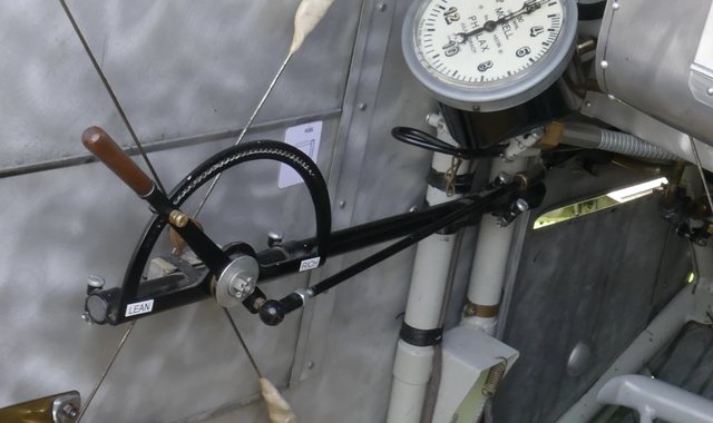

And Bertl, it figures I'd get started with a blunder (see my N.16 thread, where I began with the wrong seat, fortunately Rick/RAGIII and Steve/pepperman saved me a bunch of time on that one). Here's the quadrant on the NZ aeroplane that I was using for reference (blowup of one of Jamo's pics):
Which has been moved aft by a good 8"/20cm. Why, I wonder?
But danke vielmals for taking time to point out the error in such detail... I have the photo you posted of the original cockpit and DSA's drawings from WWI Aero copied in my project binder, but never bothered to look at them! I'll move the quadrant back to where it should be, and add the U-shaped guard as well.
