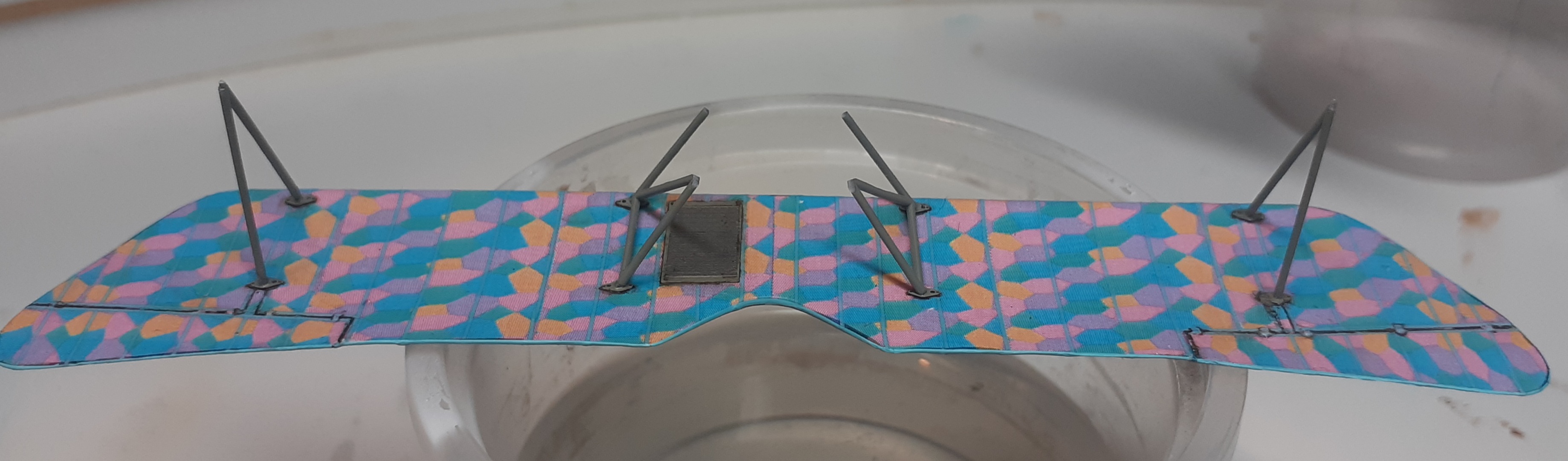

« Reply #111 on: January 24, 2024, 02:07:04 AM »
Getting back to this model after a distraction to another small project, which for now must remain secret.
The wing cellule assembly. First, the interplane struts were attached. It required some work with the pins. They are nice but together with the PE fittings make the wing gap too large. The length was successfully corrected.
Then the dry fit revealed that the interplane struts had also to have the upper pins remodelled, as they were prepared as if the struts were entering the wing at the right angle. It was still not enough because the dry fit and testing with the scale drawings showed they were still some 1.5mm too long. I managed to trim them so now everything seems to fit.
Thus, the time has come to insert the rigging into the 0.2mm holes at the wing roots and at the PE fittings. I plan to use Uschi elastic. I will also have to make the water pipe from the pump at the engine bottom to the radiator. All this before attaching the upper wing.
« Last Edit: January 24, 2024, 04:07:49 AM by PrzemoL »

« Reply #112 on: January 24, 2024, 03:22:07 AM »
Incredible modelling Prze!
This build log has somehow escaped me. Corrected now, and I will keep following.
