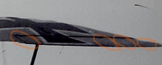

« Reply #96 on: January 13, 2024, 12:30:43 AM »
Not that this is conclusive in any way, shape, or form, but I ran an enlargement of the aileron through Photoshop last night and found, after manipulating the levels, that there are in fact very faint light streaks that might be rib tapes:
They could also be the ridges from the ribs catching the light, but it does give some support to an alternate interpretation.
For what it's worth...
