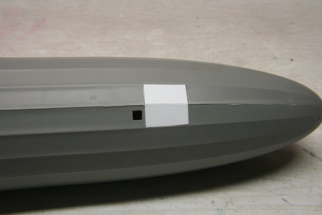

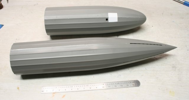

Here I have filled in the gun platform on the top of the hull.  Pictures clearly show it sits on top of the hull and not inset into it as it is in the kit.  I have also added the access passage to get up there.
I have modified the fins to be able to install them after the hull parts are assembled.  I plan to assemble the hull and paint it in one piece.

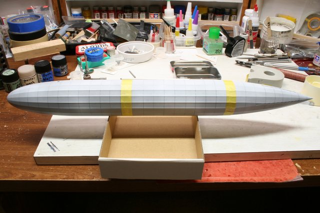

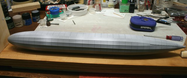

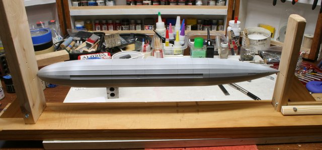

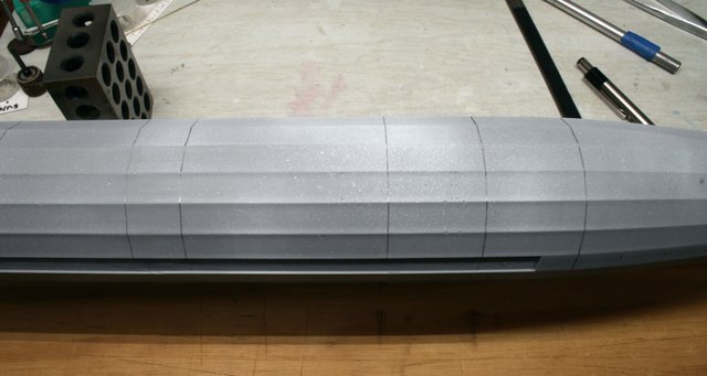

I have the hull together and primed in gray with white splotches.
In many period pictures, it's easy to see the vertical sections, so I am trying to depict them.

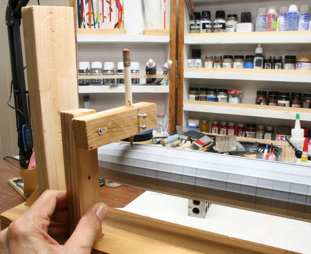

I made a wooden jig to hold the hull making it possible to rotate it around.  This is why I modified the fins to be able to put them on after the hull was put together.
I am marking the hull sections (32 of them) using a pencil.
I may have to re-mark them after some paint is applied.

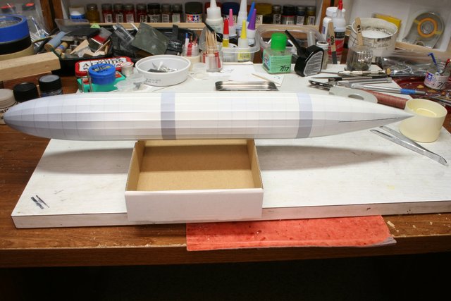

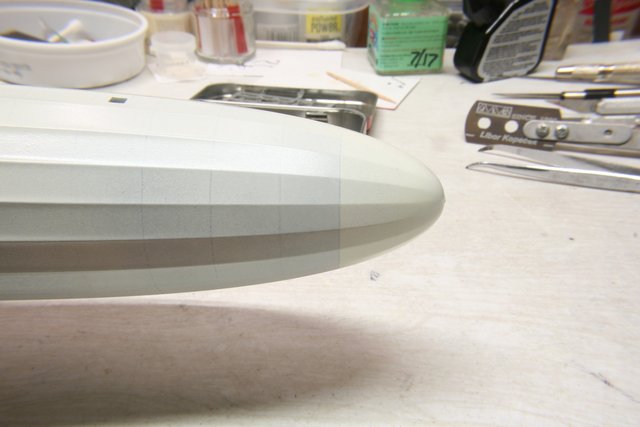

Thanks for stopping by and commenting Dutch, Stephen, Nigel, and Zac.
I have continued painting the hull.  Here I masked a couple of sections that will be darker than the others.
Then lightly spray painted some CDL color - Tamiya spray TS-7 racing white, and removed the tape.
Then oversprayed with TS-7 again for some blending and fading.
I held the hull by the nose, so it was not painted at first.  Here, I caught up the painting of the nose.  The painting guide has the nose a lighter color than the rest.

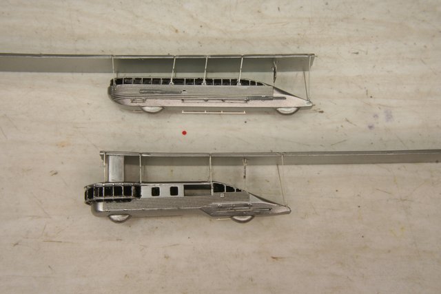

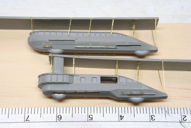

Here's a shot of the gondolas.  I've already lost one of the hand rails.  I don't know why Takom didn't include extra PE parts.  Would be very handy.
Thanks for looking in.

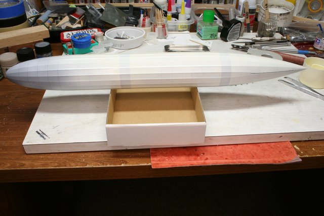

« Reply #14 on: October 02, 2023, 12:33:34 AM »
Added in some darker yellow based color.  I painted heavier on the bottom surfaces and left the top lighter for a sun faded effect.  Some masking was done on selected panels.  In pictures of actual zeps it appears the panel discoloration is completely random, but the vertical panel lines are very visible.
The colors are a custom mix of AKI RC102 Syrian Republican Guard Desert Yellow, RC003 white gray, and RC298 RAF light aircraft gray.
Next will be re-tracing the lines of the vertical sections and then dabbing on some darker colors.
